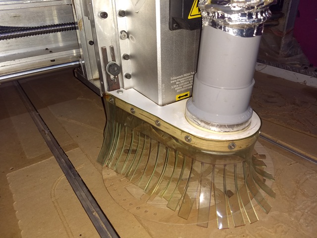

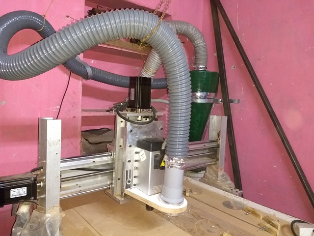

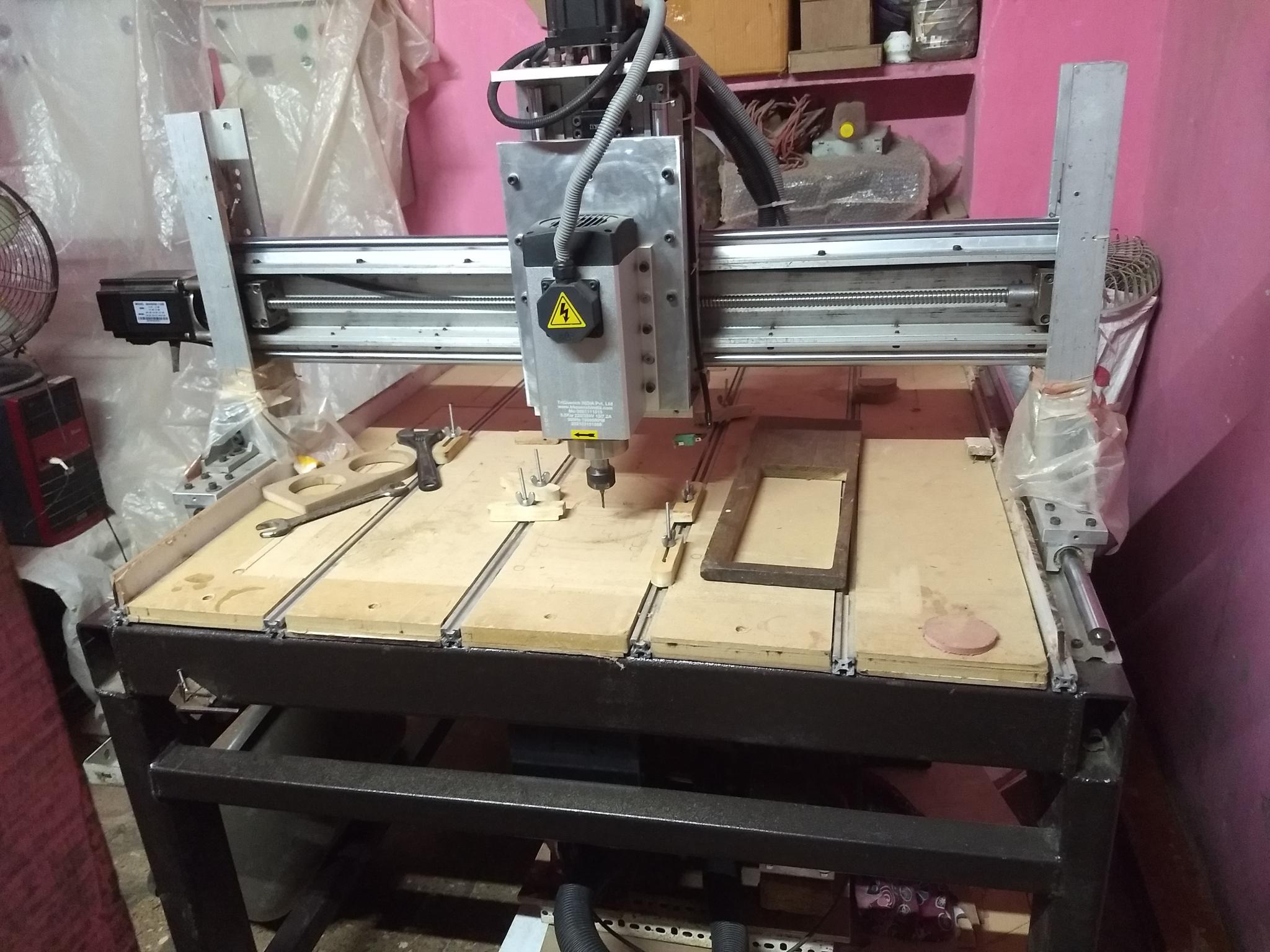

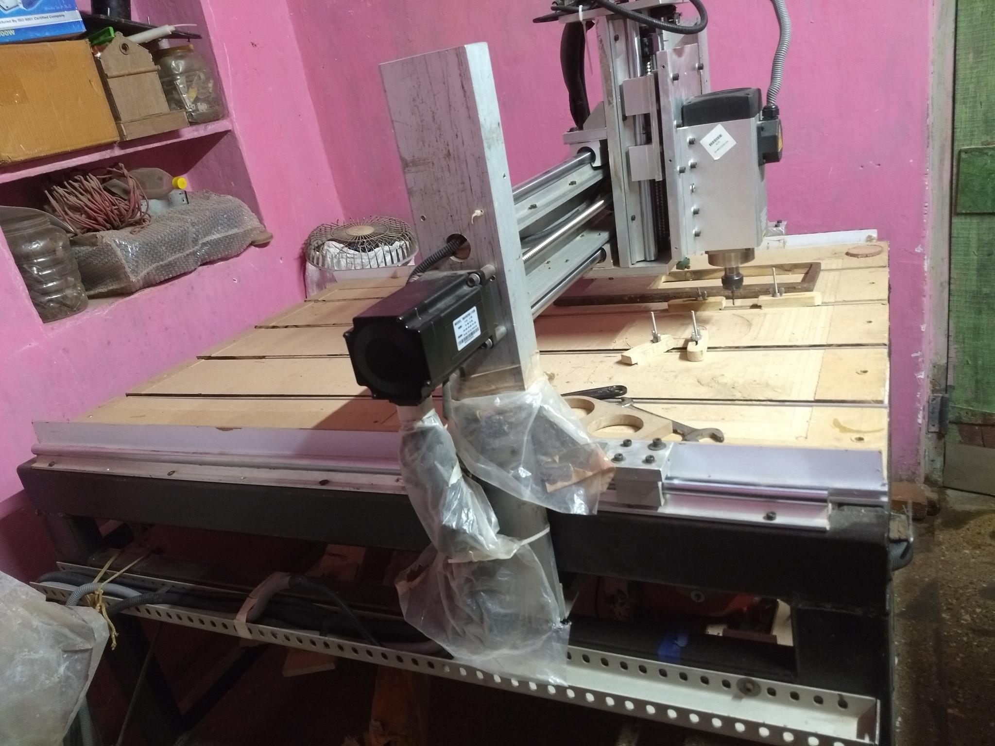

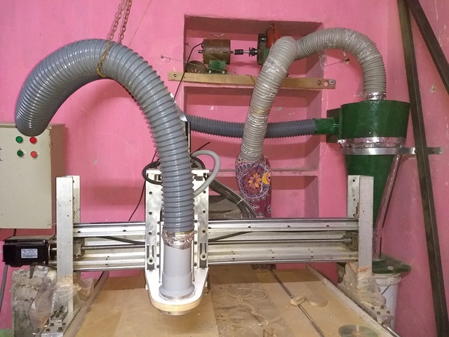

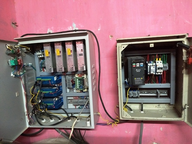

    Hello Everyone, I am Ganesh from India.
    I had completed my DIY CNC Router in last year. (Thank god my cnc parts came from China just before the lockdown).
    It has 1000mm x 750mm x 150mm working area, Spindle is of 3.5kw, er20, 220v, XYZ axis attached with Nema 34 8.5nm closed loop Stepper Motor, 1605 ball screw on all axis, PC based Mach3 controller. It was my first attempt to make something completely by myself after finishing my Mechanical Engineering. The machine is working nicely as expected although it has some design issues (Vibrations and Stiffness problem) that I will correct in further upgrade. Please see the attached photos.

    7. PC based Mach3 controller, (Is it sufficient or should I use some industrial standalone controller?)
