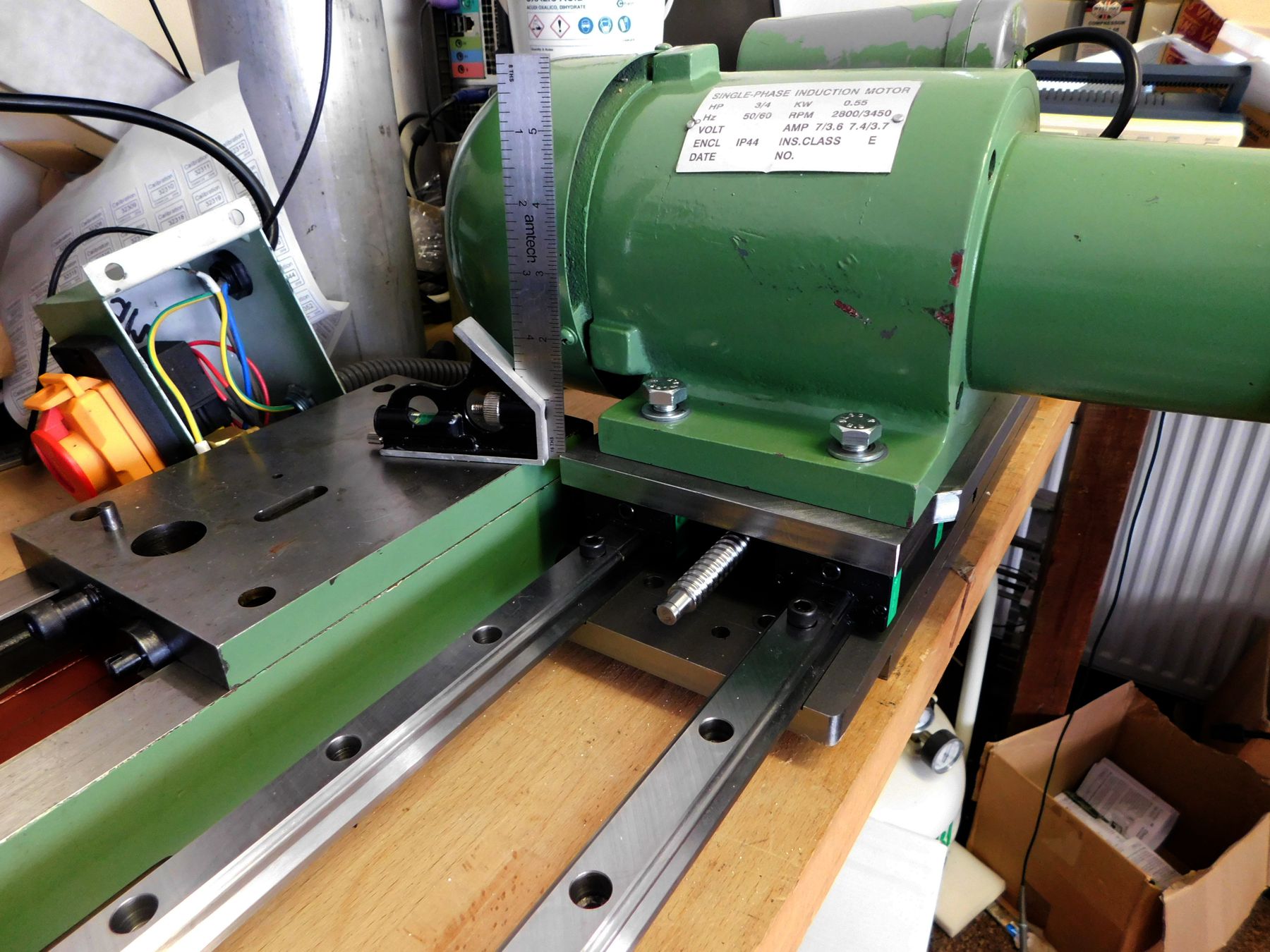

    Problem: The oil fed slide Z axis is so overloaded by motor overhang it cannot be relied on to move down tiny distances.
    Solution: Replace the slide with profile rails.
    Problem: If I make it any thicker/wider my 612 will quickly turn into a 611. I am limited to 1/2" steels and 20mm rails.
    Picture shows profile rails next to original dovetails. Square shows I have lost about 3mm. Would have been 5mm but I sank the rails 2mm down into the plate to keep them square.

    Now I have to trim the ends off the rails. I think I may be able to band saw it? These are not pukka rails, these are a £44 for two with 2 extra carriagesblocks, Chinesium special. If I hit the end with a file it cuts.
    Good thing about a 20mm rail is that you can fix it down with 6mm cap heads, if you don't mind reducing the head diameters by 0.6mm
