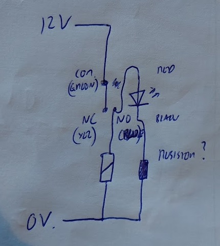

    I was going to do this in F360 to test the schematic section, but the default component choice is limited, so here's a quick doodle -
    I've marked the resistor, but I'm assuming as the switch is listed as 12V, it already has an internal resistor for the LED part, so it shouldn't be needed, but without seeing the datasheet, I'd add it just in case.

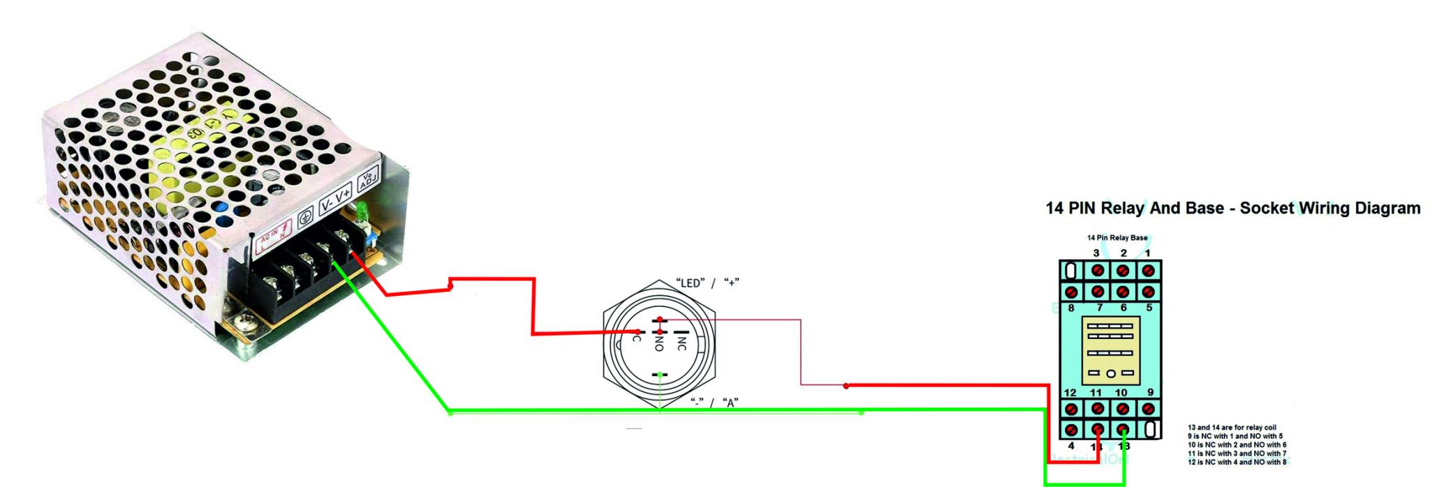

    After reading and try to educate myself I understand now you connect the switch on the hot side (+) of the relay. I also read about how to connect my "fancy" button. Long story short I came up with this crude diagram. Have a look and tell me if this will work, please.
    Many thanks
    Gabi

  5. #55
    Lives in East Lothian, United Kingdom. Last Activity: 3 Hours Ago Forum Superstar, has done so much to help others, they deserve a medal. Has a total post count of 2,994. Received thanks 376 times, giving thanks to others 9 times.
    That looks fine for the switch/relay side wiring.
