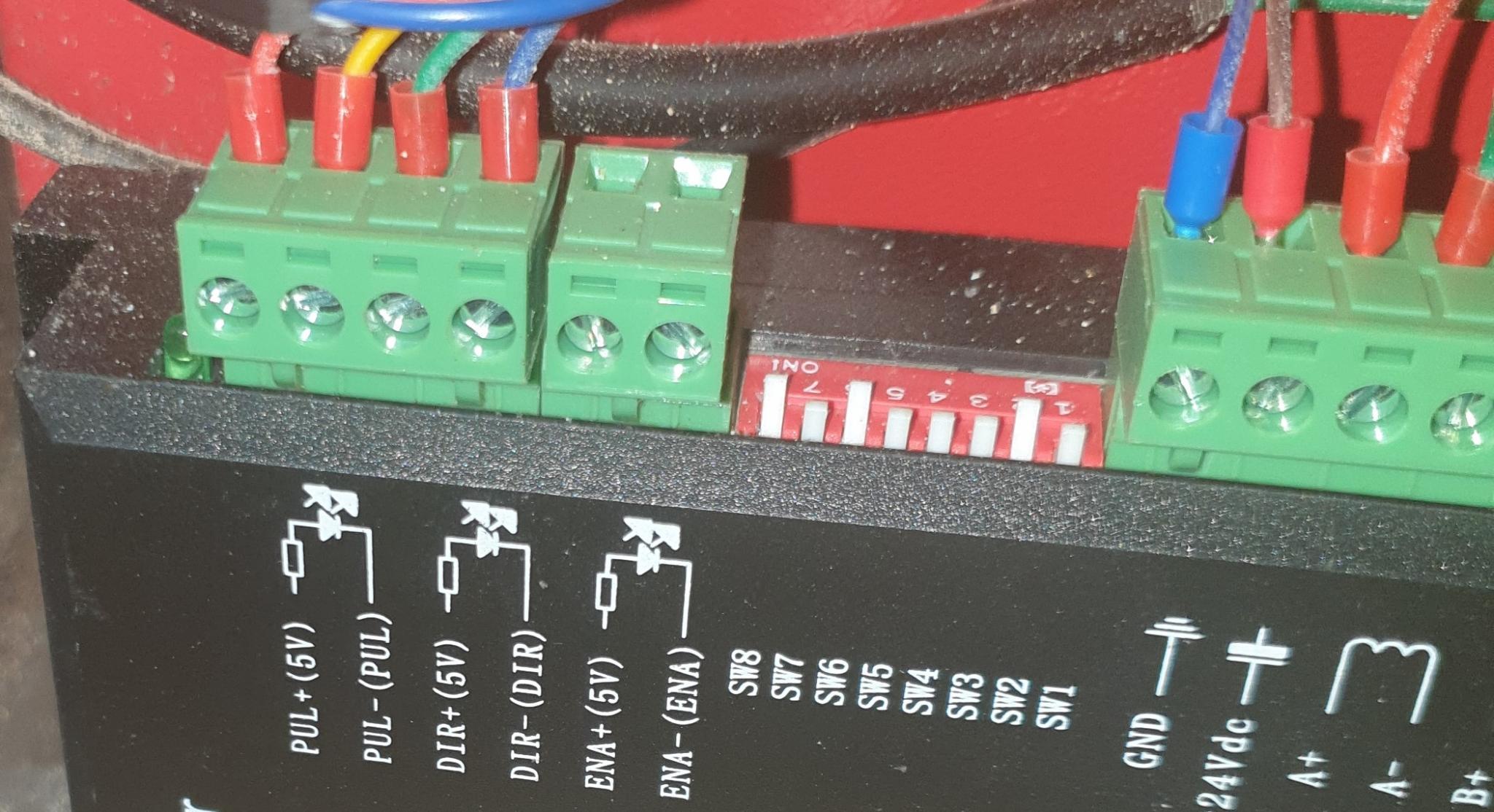

    No. All you need is a 4-pole relay. Pul -, Dir - and Ena - are all connected together to GND. You are controlling only Step, Dir and Ena.
    I know you don't need the Arduino. The Arduino is generating the pulses I need for the lathe operation, but that's just for your information on my use. All you need is what my drawing shows, i.e. a 4 pole relay and a switch. The one I am using is DS4E-M-DC5V made by SDS. It is a low power signal relay, fast and requires very little current, but it is obsolete so maybe hard to find. Anyway, there are plenty small signal relays which can be used, and it is not critical that all the contacts are in the same casing, so you can use 4, 2 or 1 relay depending on what you find. Here is an example which works also, but you need to wire it:
    https://www.amazon.se/Yizhet-kanal-r...03086861&psc=1
    Sorry to be a pain. I have 4 inputs which need to be changed between. You said I will need Pul+, Dir+ and Ena (unconnected in my case). What should I do with the rest of the wires (Pul-, Dir- and Ena).
    Thank youClick image for larger version.
Name:	stepper drive.jpg
  6. #36
    Use a 4 pole double throw relay. Known as 4PDT.
    If you do not understand this do a google search about relay basics.
  7. #37
    Lives in East Lothian, United Kingdom. Last Activity: 19 Hours Ago Forum Superstar, has done so much to help others, they deserve a medal. Has a total post count of 2,992. Received thanks 376 times, giving thanks to others 9 times.
    I've not really been following this thread, but the simplest option is a 4PDT relay as has been suggested, but you only need to switch the Dir+/-, and Step +/- signals.
    Driver is permanently enabled, so you don't have to worry about it losing power and the Z dropping.
    And the GND is only needed for the main power, as the driver inputs are optoisolated.
    The only issue with using a relay is with switching such a small current, the contacts will likely oxidise with use due to lack of current to wet/clean the contacts, eventually leading to lack of continuity,
    For a circuit only switching occasionally, it'll likely be a long time before failure is likely to be an issue, but it's something to bear in mind.

    Yeah so basically go for a relay rather than a contactor.
  10. #39
    That is only true if he ALWAYS wants to have the stepper energised and always holding. That is not always desirable or even advised. So unless you absolutely certain that he doesn't care about enabling/disabling the driver it is indeed necessary to switch the enable signal also. Regardless of which, there is no harm in switching it, but there can be harm in not switching it.
    GND is the same as STEP - , DIR - and EN -. It is better to connect those to the same - output as the one providing the control signals. Again, it would do no harm and we know too little about his design and implementation.
    That's why I said that a small signal relay needs to be used, not a contactor. You talk about a contactor which is designed for high voltage and current.
  11. #40
