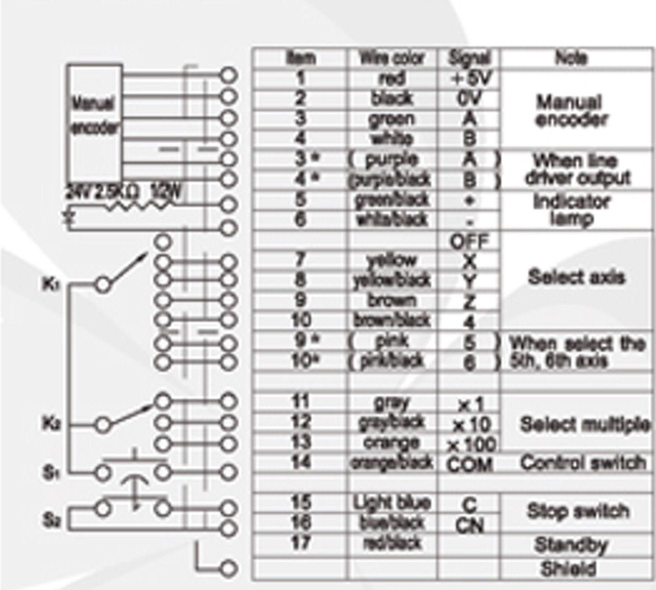

    I need some help wiring my popendent1 (ISMM1468 Series) from polabs to a pokeys55T
    and later to mach 3.
    Has anyone of you have already done something like that and is willing to share the information with me.
    Because I am a total beginner in electronic if possible to say which wire to which port and how to configure them.
    Iff possible pictures.

    This is what the description of the pokey55T indicates;
    PoKeys55 is an easy-to-use USB device that combines standard keyboard and joystick simulation, and do not requires complex programming knowledge. Pokeys55 provides 55 digital I/O (5V tolerant), 5 analog inputs (10-bit) and 1 analog output (10-bit). All the I/O are controlled by the provided software which allows either to use the graphical user interface or advanced console type interface. The settings can be stored on the device, so no special software is needed on target system. PoKeys55 can be used as industrial or CNC control, custom joystick or keyboard or data acquisition board. PoKeys is available with (PoKeys55-T) or without screw terminals.
    Can I just connect all the wires and then assign a function for each of them.
    I include a picture of the wire diagram for the pendent
  5. Andre,
    I moved this thread to a better place...
    In answer to your question, you can connect all wires directly from the IMS pendant to the PoKeys55 as any pin can be configured for any purpose, including the rotary encoder A/B lines (as long as your Pokeys55 is version 1.7 or later). However I would avoid Pokeys pins 43 - 47 as these can be configured for analogue input/output as well and it would be silly to tie these up for the pendant.
    The only area I cant be sure about is the pendant indicator light (IMS wires 5 and 6) as this is intended to work on 24v, and the Pokeys55 only outputs 3.3volt. If you want to drive the indicator light you will need some additional components.
    Gary at Zapp may be able to advise better on this as he sells the IMS pendant.

    will it work without the indicator light?
    if so then maybe I can work without the light and I don't need 24 volts.
  7. yes, the light is not connected to anything else...
