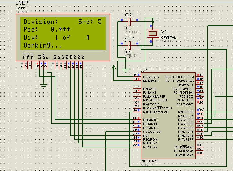

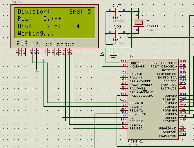

    before all compliment for your project!!!
    I have simulated it with proteus and works but i can not understand a thing
    why when i push direction pos : 0.000 became 0.***?
    Sorry but my english it is very poor
    regards
    Gianluca
  5. #15
    Hi Gianluca,
    The divider shows the current position in 'real time', however it can't update the screen fast enough for the numbers to the right of the '.' to make sense.
    So whilst the table is moving I blank the numbers to the right of the decimal by replacing them with '*'s. When the table has finished I reprint the correct number.

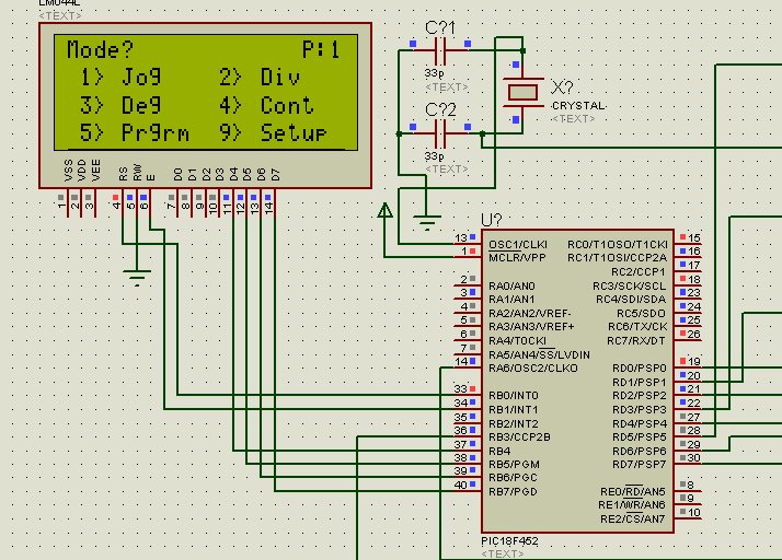

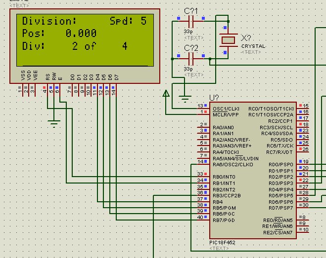

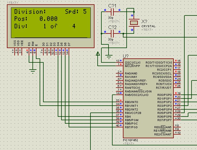

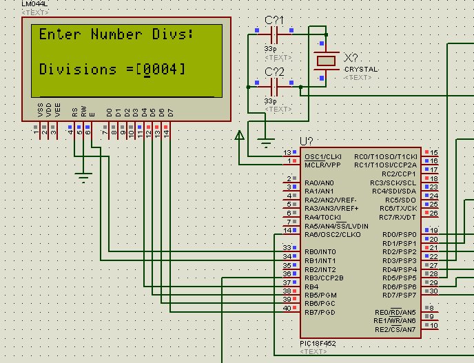

    as you can see pos is always 0.000 I have simulated div
    regards

  9. #19
    Hi Gianluca,
    I'm unsure about how the proteus simulator works - however I should point out the movement is performed using interrupts - these are pretty rapid too (up to 10,000 per second). I'd guess that the simulator either can't handle interrupts or can't handle them at that speed.
    Steve.
