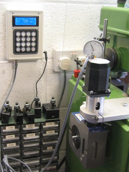

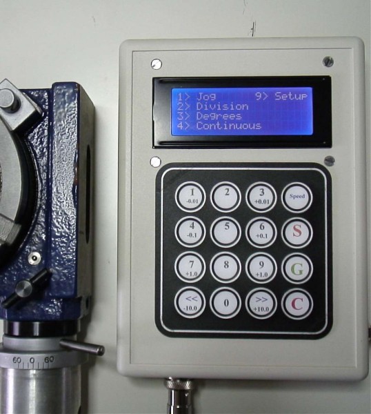

    This forum looked a bit empty so I've posted this here. Whilst not a 3 axis machine it is technically CNC. I have posted this design elsewhere so apologies if you've already seen it.
    What and why?
    It's a device intended to drive a rotary table, lathe head or any form of indexing device. It's cheap - the electronics running around £30 and (for a small 4-8" table at least) can use some of the appallingly cheap steppers and drivers we see around these days...
    I made it after purchasing a set of division plates for my 6" vertex table, I played with them and then decided they were tedious and error prone. So I designed this.
    Basically the controller connects to a stepper which you've coupled to your rotary table / lathe head / dividing head etc. Then with a couple of button presses it'll divide, move by an angle, move continuously for machining or if you're feeling adventurous you can program complex sequences of moves which can be driven automatically or with operator intervention etc.
    Being a standalone device, it doesn't tie up a computer and is much simpler to use.
    For example to divide a circle into 171 parts - turn on, press [2] (division) enter the number '0171' and press [G]. Each press of left or right will now move the table 1/171 of a circle anticlockwise or clockwise. Backlash compensation is automatically applied.
    The current position in degrees, current division and total number of divisions are all shown on the LCD display.

    I've also attached some photos of the completed unit and one of it in use (hooked to a 4" rotary table which is in turn bolted to my lathe head for a spot of gear cutting).
