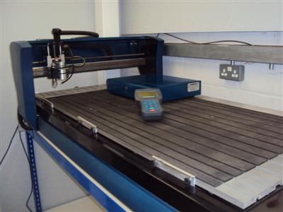

I've been wanting to dip my toes into the world of CNC for a long time, however fate decided to throw me into the deep end without armbands!
Over Christmas I was fortunate enough to rescue a Suregrave CNC router from literally being skipped. Judging by the date stickers it was built in ~2005. This thing is very solidly built but I have no electronics to go with it. There is a case that the CNC hooks into which contains a 48v PSU but no controller board. I've been told it has not been used on over 10 at least, and had very little use before then. Mechanically it has very little wear from what I can see.
I've attached a photo from the interweb of a very similar machine to mine (just a different colour). Mine's still in bits as I had to dis-assemble most of it to get it home!
