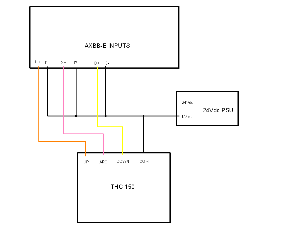

    Do I have to connect Up and Down outputs from Proma THC 150 to AXBB-E inputs' positive poles and COM to a input's negative pole?

    Like this, I believe but have never used one so check it out.

    Thank you. It works.

    So this wiring works for Mach3, doesn't it?
