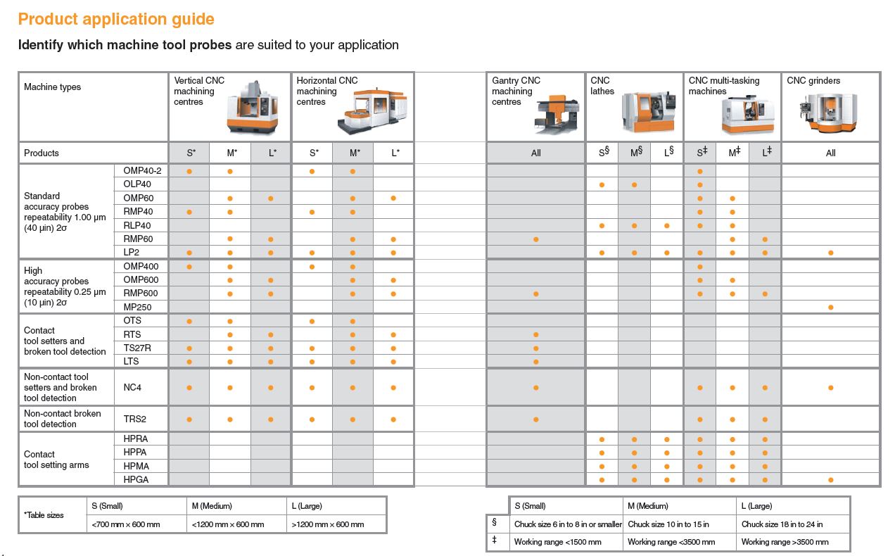

    Thanks for that,
    For the current offerings, is that OMP40-2 / RMP40 / LP2?

    In old money, is it just the MP1 that cuts it or are there others? Does the MI5 interface help any for greater accuracy or is it really not needed? How about tool setting?
