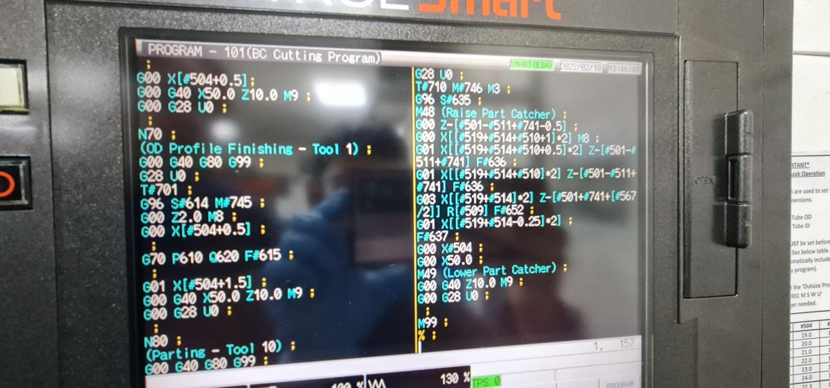

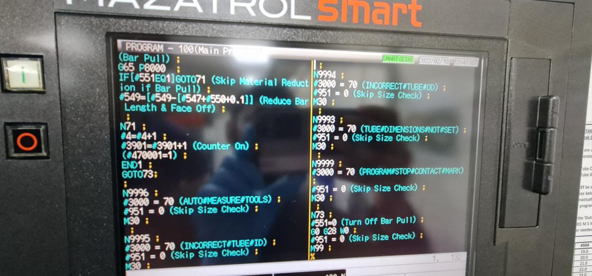

    I have a Mazak quick turn 100s lathe running on Mazatrol Macros.
    I have issues with my parting off tool (Tool 10), it does not go all the way down to part off the product cutting platinum.
    Would anyone happen to know how to edit/recode the given Macros so the parting off tool is able to go all the way down?
    Below are the codes in the file attached any help will much appreciated:
