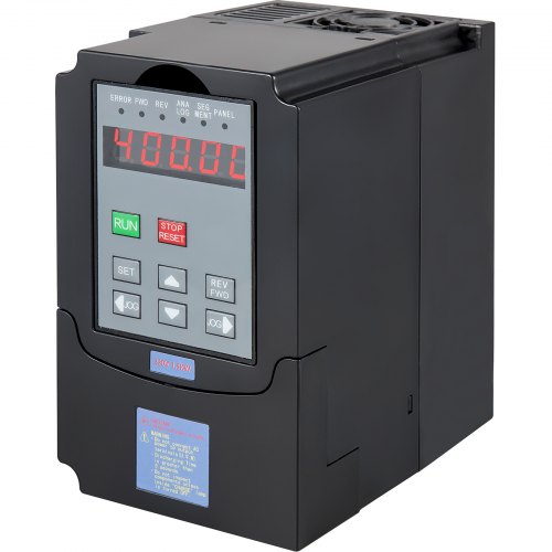

    just had to replace my VFD as the old one went bang.
    new VFD will only display frequency, not RPM.
    Is there a simple Hz to RPM calculation?
    Spindle is 2.2Kw water cooled chinese.
    This is the chinese A2 VFD as pictured below

    What VFD do you have? link to manual?

    Parameter PN01, however the manual isn't very clear on what it means by synchronous speed.
    Normally you'd set the number of motor poles, which for this kind of spindle IIRC is 2.
    However given the high range for the parameter, it may be expecting the maximum speed at full frequency.
    Looks like you'll have to do some setting and testing to see what it should be set to.

    Sorry for the delay responding chaps, had a rush job on which I just "ran by ear". Only cutting perspex so ran a scrap through at what I thought sounded right, checked it cut okay, and got the job done.
    I've since had a play with the VFD settings and for PN01
    1 - the display shows Hertz.
    To display RPM you set PN01 to the maximum speed of the spindle. In this case I've assumed 24000rpm
    To prove it, with PN01 set to 1, I then set the speed to 100Hz.
    Then set PN01 to 24000 and ran the VFD.
    Display then showed 6000 (rpm)
    So I'm set now, and hopefully this thread may help anyone else who is confused the manual!

    for a 4 pole, you'd just set it for 12000 and be done.
    I've assumed my 2.2Kw spindle is 2 pole and does spin at 24000rpm, it ties in with what the old VFD displayed (set up by previous owner). The guesstimated speed the other day ties in with the speed I used before for perspex.
    I suppose the only real what to check it would be a strobe tacho on the spindle itself.
    But, it's working, and earning, again.
