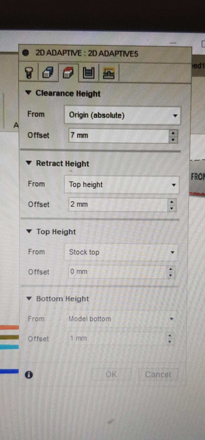

    Anyway here goes, I have just moved from linux cnc to mach 3 and the issue I am having is after i have zeroed all the axis and start to mill, the z axis always starts off machining 2mm above my workpiece, I use fusion 360 as cad and cam and when I simulate the tool paths everything looks fine.
    I have calibrated the z axis over and over again and I also tried milling a simple pocket which turned out perfect. Could this be an issue with my "heights" setup in fusion360? I have posted a pic of my height setup.

    Sounds like it's your Cam (G-code) but unfortunately, I don't use F360 so can't help.
    However, if you want to check your moving correct amounts regard steps per then Zero the work Coordinate then goto MDI type G0 Z10 (or any amount you prefer) then measure to see if it moved this amount. Then G0 Z0 and it should go back exactly to point you touch off at.
    If this works then it's your Code.

    I use 360 and the retract height is the height the tool starts at for most operations. If your part has a flat top, you can set the retract lower as there is no danger of hitting the part as the tool is moved to the start of the next cut.
