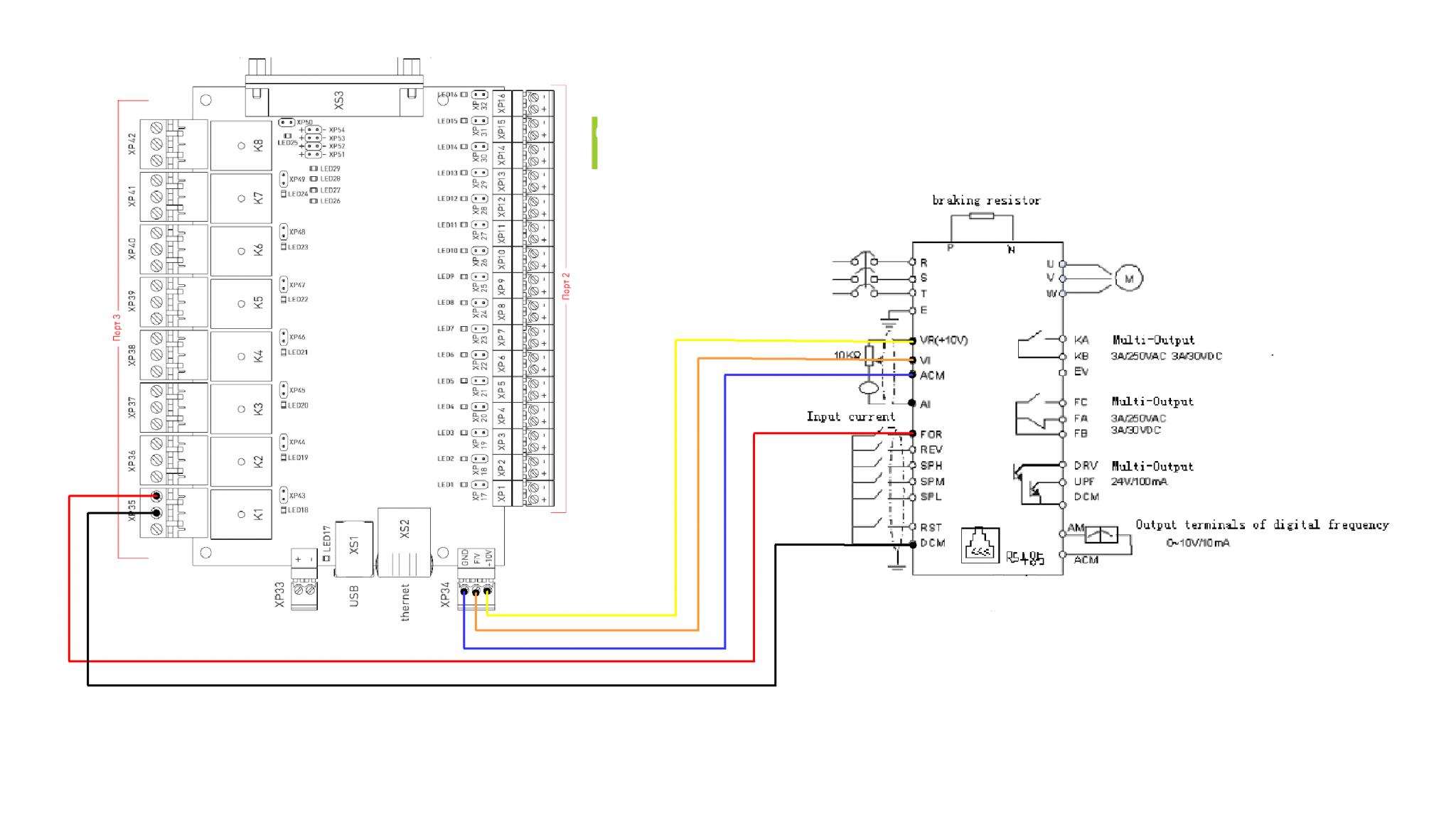

    Hello.Can somewhone tell me The safest way to connect a pumotix plcm-e4 board to a cheap chinese vfd (hungjuang type h)via db-25 connector and using the pimotix software.Thanks in advance

    Please see the scheme and let me know if it is OK for you.

    Looks about right..
