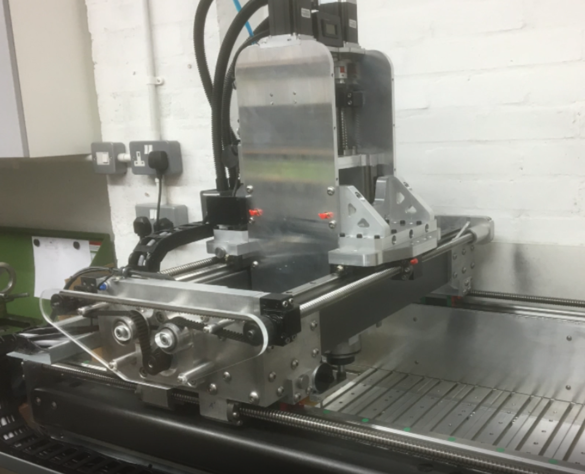

    Quite some time ago I posted the CAD files (Fusion 360 format) for my own design CNC router on a website with a small charge. I had quite a few downloads but after a while the orders stopped so I removed the files from the site as it cost me a small fee to host them each month.
    Recently I've had a few people asking if there was a way they could get hold of them, and I didn't really want to create an account on that site again for a few downloads, so I've been thinking about how best to do it. I didn't really want to get into personal emails and fielding requests that way as I barely get time each week for this hobby.

    This is the machine:

    So I've decided just to give them away for free as open source, and I'll leave it up to you if want to donate to something like the British Red Cross Ukraine to help with humanitarian efforts. They have a PayPal link on their site, if you would like to do that. Lee, if this is a problem I can take this bit out.
    https://donate.redcross.org.uk/appea...-crisis-appeal
    It is in Fusion360 format
    The parts were imported from another CAD program so there is no design history
    I can't make modifications or design changes, it is just provided as it is
    It only contains the main structural items, no fixings or wiring etc.
    I don't have a parts list or walk through but the motors, ballscrews, spindle etc. are all standard sizes - obviously there are a lot of custom parts too
    There are no drawings, just the CAD file
    Sorry about the delay in getting this uploaded but we got there in the end, and many thanks to Lee for sorting it all out.
    If you would like to download the Fusion360 CAD file for my Mk4 CNC machine then please click this link:
    http://mycncuk.com/downloads/routerCNC_fusion360.zip
