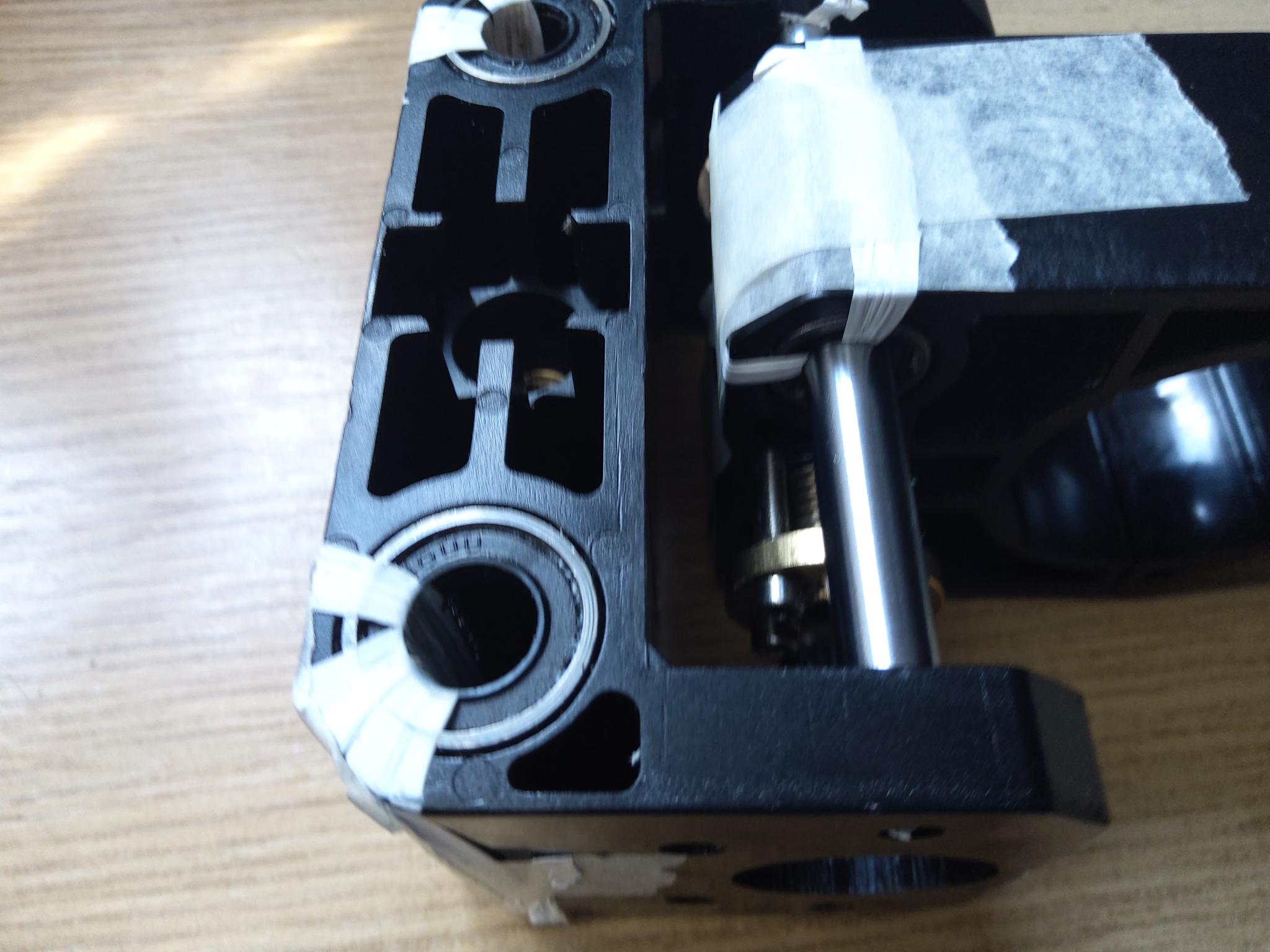

    I was going to embark on an electronics project and discovered the world of p.c.b engraving, intrigued by this I got myself a Vevor 3018 CNC.
    After a bit of playing I managed to create a test p.c.b. using KiCAD, Flatcam and Candle. Great I thought and then set about making a proper board, things went south at this point. I could not get any consistency with the engraving, sometimes it would work really well and other times there would be bare board where a track should have been. I put the p.c.b. to one side and thought I would try and make a front panel out of ABS for something I built earlier. Using FreeCAD and Candle I managed to ‘mill’ one although it was a bit of a mare as the plastic kept melting and sticking to the end mill, but I got there in the end.

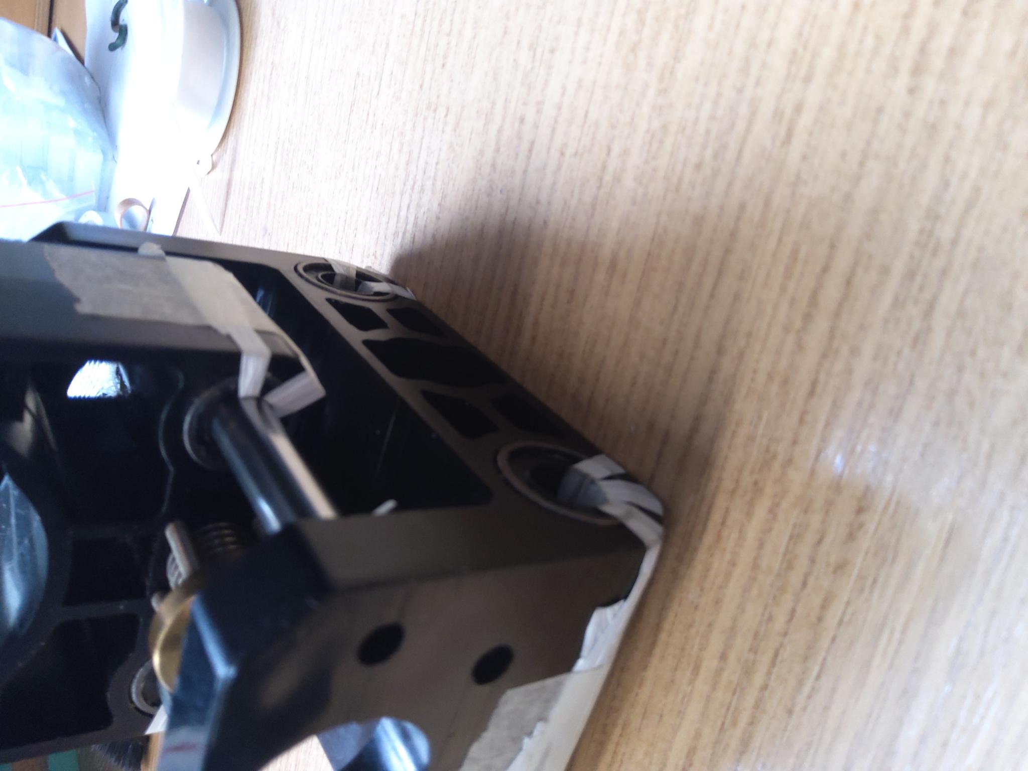

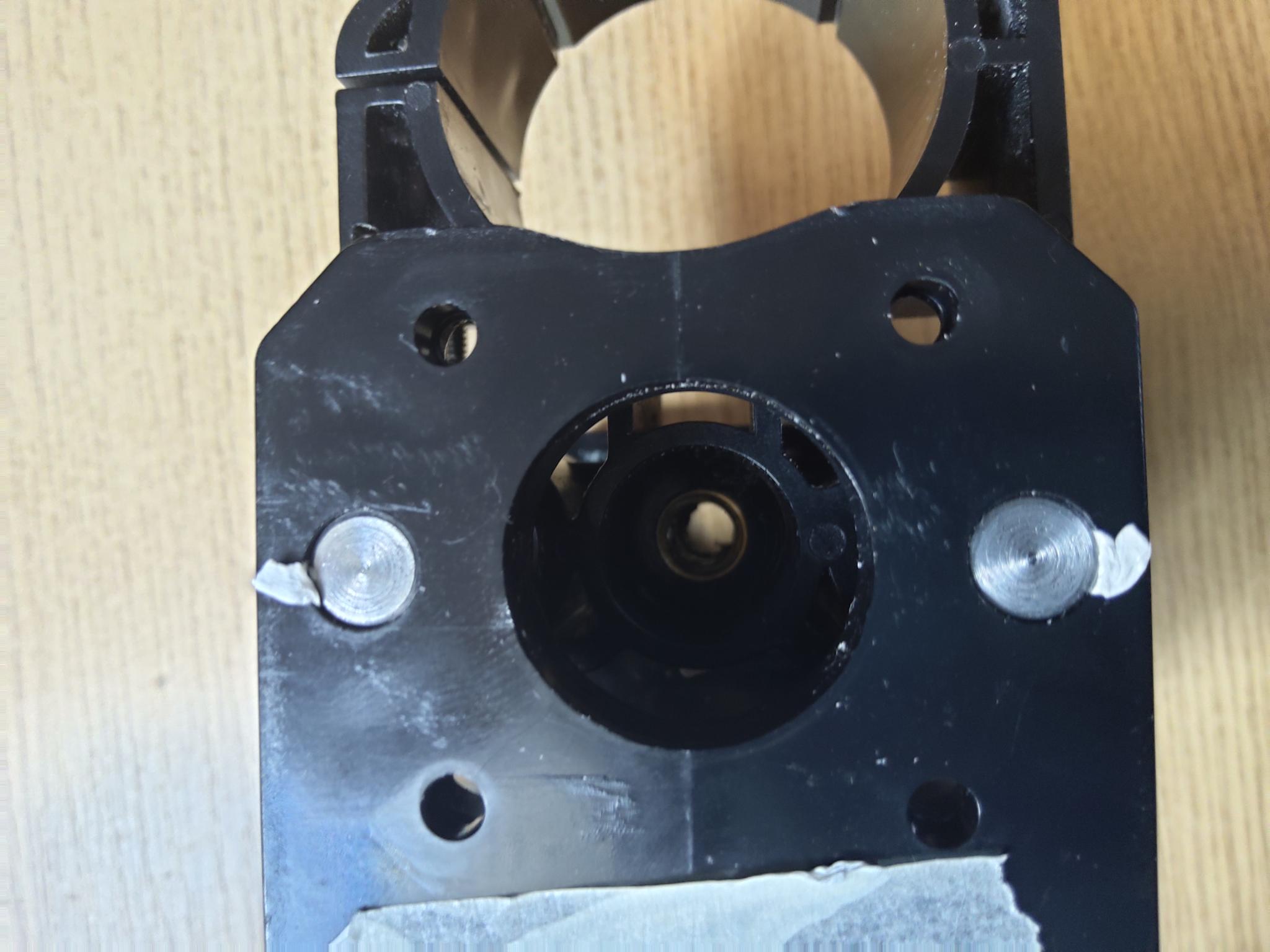

    Back to p.c.b. I took the CNC apart to clean out all the plastic dust that had built up and noticed that the X axis has some play between the linear bearings and the guide rails, and a bit of play in one of the vertical bars of the Z axis. I figured this may be the cause of the inconsistency and to prove it I fed some PTFE tape through the bearings and taped the ends around the back of the motor unit and put a piece of tape in the hole of the Z axis bar and that took the slack out. When I fire up the machine I was surprised as to how much quieter it was and I managed to engrave a test p.c.b.
    I have read some articles on the internet implying that there are upgrade kits and super duper bearings out there to solve the issue, but I can’t seem to find a supplier or know with confidence what I am looking for, any help would be gratefully received.
    Thought I would add a picture of the PTFE fix, subsequently found play in the Z axis fixed as well.

    Hi Ashley,
    Did you make any progress with this, are the rails the correct size for the bearing units ?
    Ash's Avatar
    Lives in London, United Kingdom. Last Activity: 14-07-2025 Has been a member for 3-4 years. Has a total post count of 3.
    Hi Ashley,
    The bearings and rails are the correct size, they were the ones that came with the machine, since this post I did get an upgrade for the X axis
    https://www.etsy.com/uk/listing/1094...-gantry-linear
    Only to find the rails were too short, but I fixed it by getting some stainless steel spacers M5/5mm/12mm
    https://www.ebay.co.uk/itm/324272674677
    and some longer screws M5/30mm
    https://www.ebay.co.uk/itm/383691428657
    This has resulted in less flex in the axis and less play but there is still a bit there, I will carry on experimenting.
