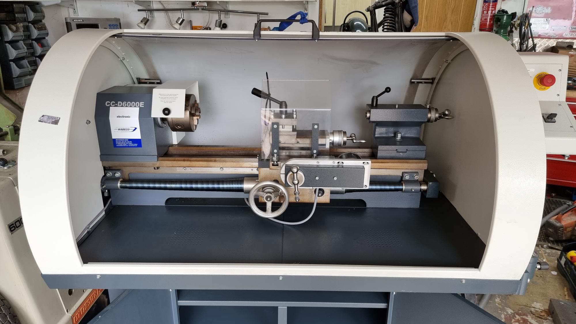

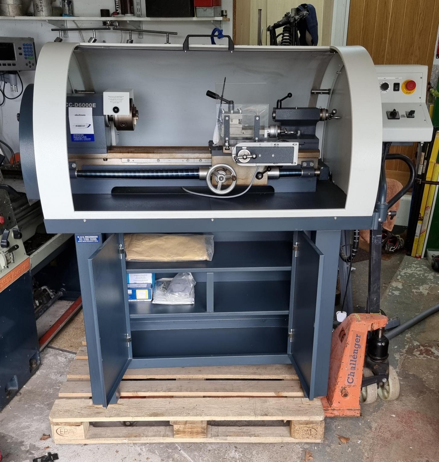

    For Sale: Wabeco CC-D6000-E Lathe (current price new €8591),
    Year of manufacture 2006.
    Can be used as either a CNC lathe or manually.

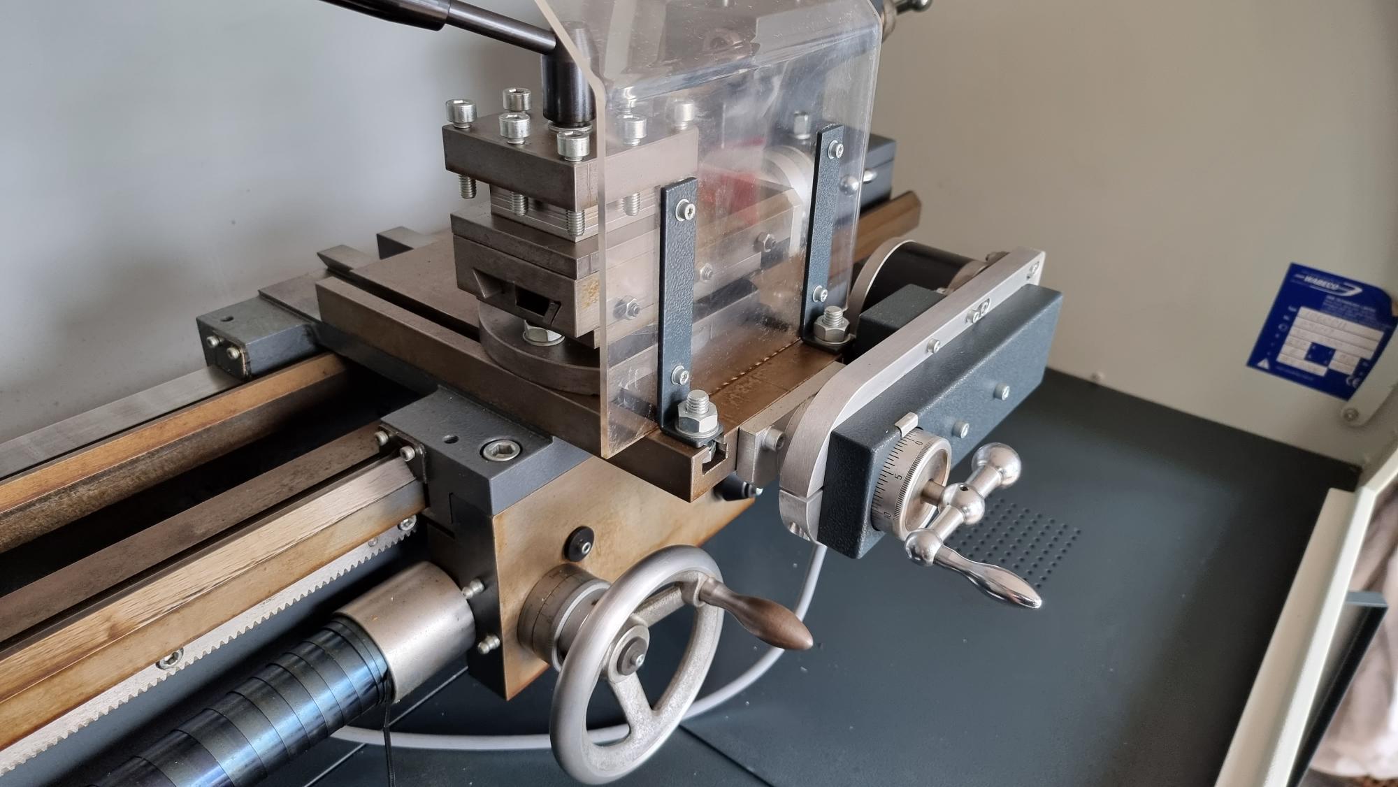

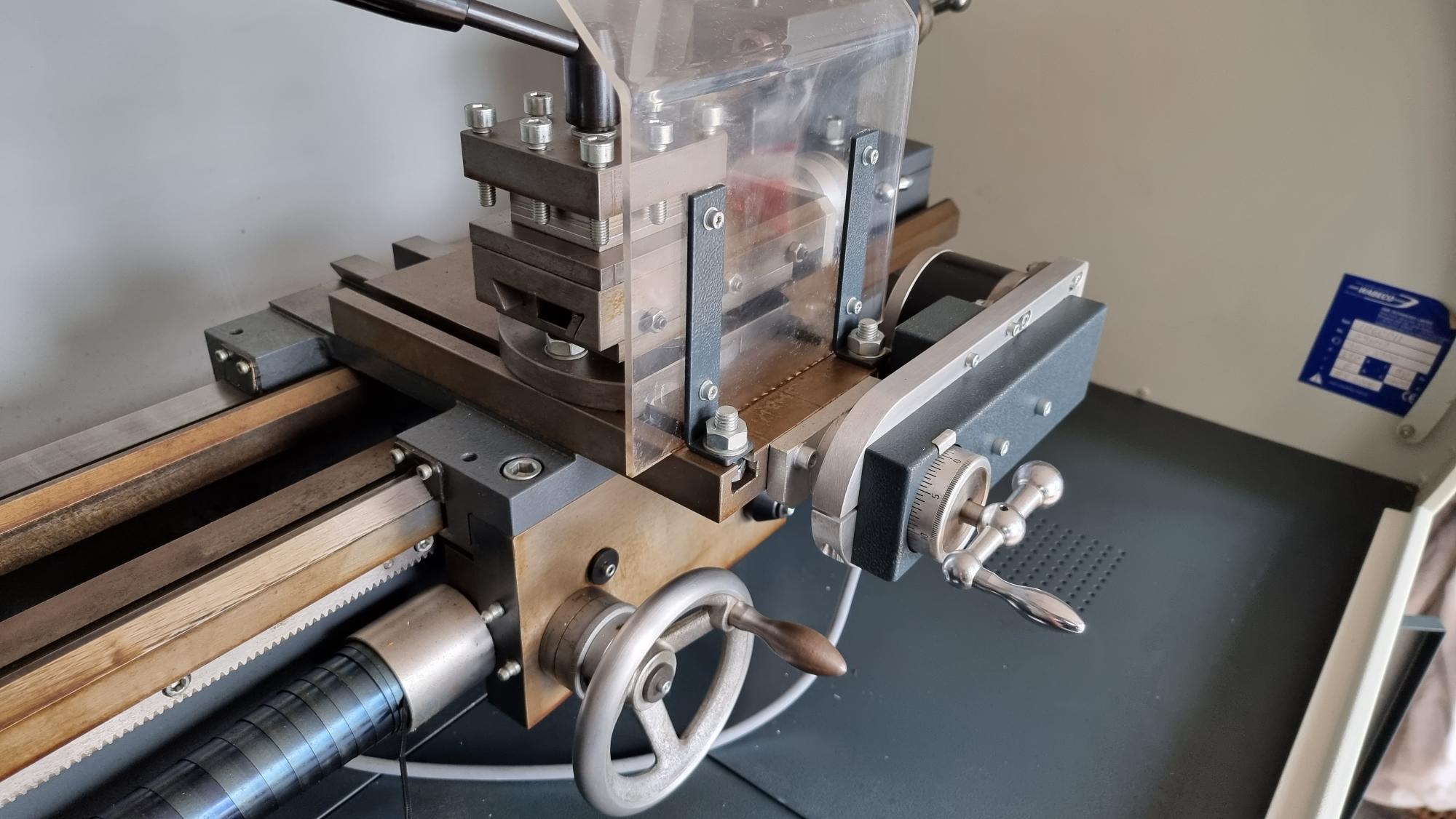

    The lathe is in as-new condition, in fact I suspect this machine has never been used as it stilll has its factory wax coating on the bedways and all exposed metal parts. Please note there is no rust on this lathe, the brown colour on bed ways etc is a factory protective wax coating which can easily be removed.

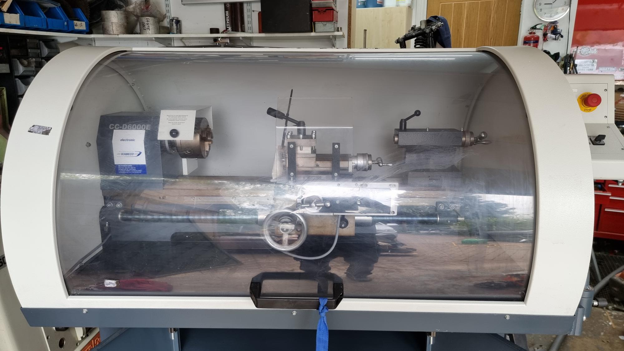

    The safety cabinet does have some marks on the perspex door from storage and handling, but nothing that affects operation.
    Prismatic cast iron bed with induction hardened ways.
    Between centres 600 mm. Centre height 135 mm. Max diameter of workpiece 270 mm.
    Approx weight 325kg.
    Approx overall dimensions: 1600 mm wide, 850 mm deep, and 1500 mm high.
    Equipped with the optional 30 mm centre bore (standard is 20 mm). Tailstock MT2.
    Drive comes from a1.4kw (1.5hp) single-phase 220/240v motor.
    Spindle speeds 30 to 2300 r.p.m. infinitely variable by potentiometer giving constant torque.
    2 automatic longitudinal leadscrew feed rates 0.085 and 0.16 mm/rev.

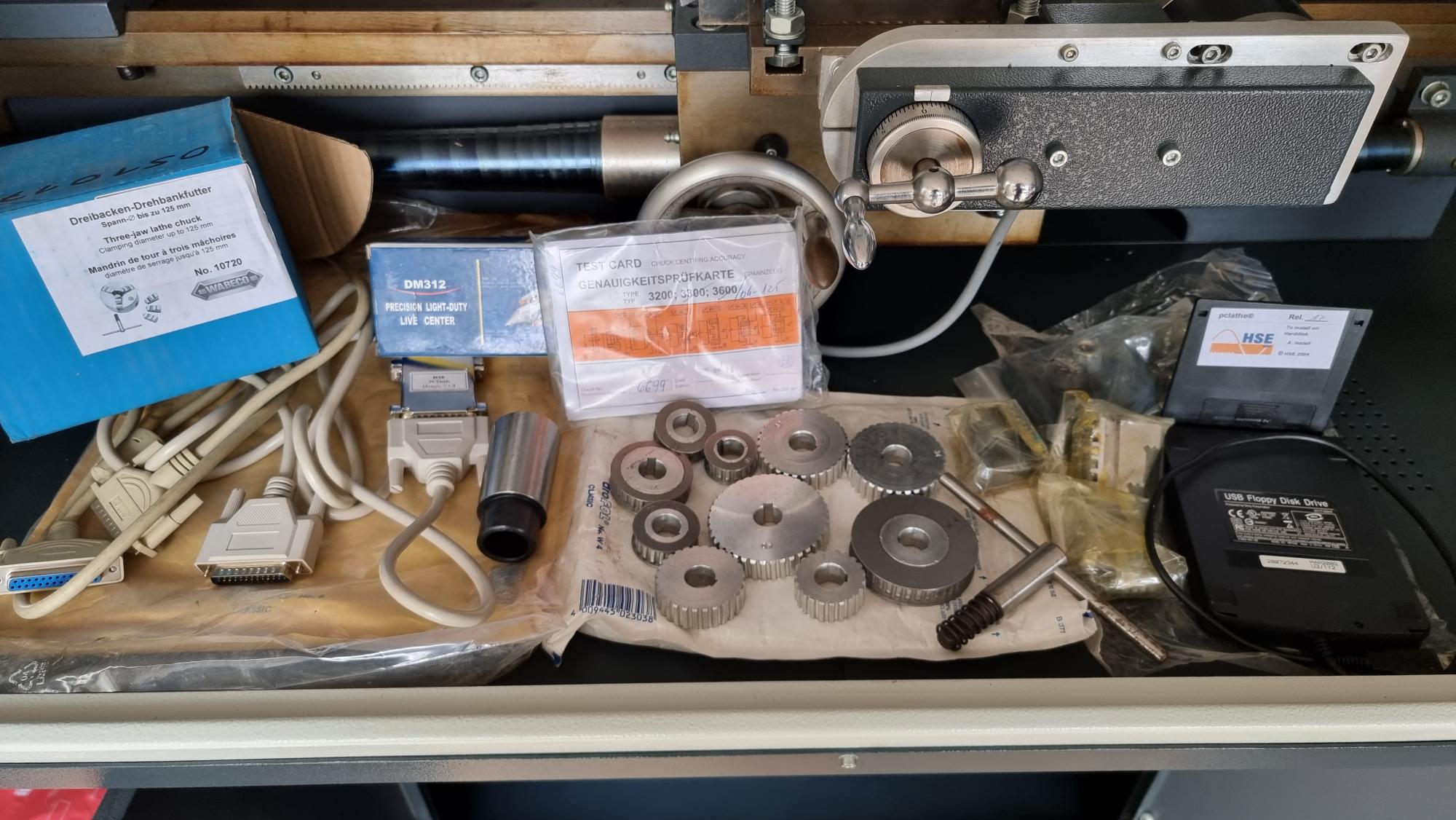

    Wabeco 125mm 3 jaw chuck with internal and external jaws, and sprung loaded chuck key.
    Revolving tailstock centre.
    Headstock tapered centre bush.
    Changewheel set for screwcutting with metric 0.25 to 7.0mm pitch and inch from 10 to 40 t.p.i. threads.
    Original lantern toolpost and the optional-extra 4-way toolpost.
    Maker's cabinet stand (current price new €899) and the safety cabinet enclosure (Current price new €3032).
    Factory fitted leadscrew cover (Current price new €337).
    Printed 50-page manual.
    Dongle for PC Dreh cnc software and serial port leads. USB Floppy disc drive.
    I am told PC Dreh software is available to download free from Wabeco support, so long as the dongle is present. Or, of course, you could upgrade to third party software of your choice.
    To buy this machine currently from Wabeco would cost in the region of 13,500 Euro's plus shipping.
    I would ideally prefer collection, however am happy to secure to a pallet if you wish to arrange your own courier.
    Funds must be cleared prior to collection Payment by either cash if collecting personally, or direct bank transfer if collecting by courier. (please note I can take no responsibility for any damage that may occur once the machine has been collected but couriers are normally insured).
    Apologies if I've left anything out, however there is Plenty of info on Wabeco's website regarding technical specifications as this is still a current model. A fantastic machine with typical German build quality and attention to detail.
    £3695 ono.
    Phone: 07810 002549 (Leeds West Yorks)
