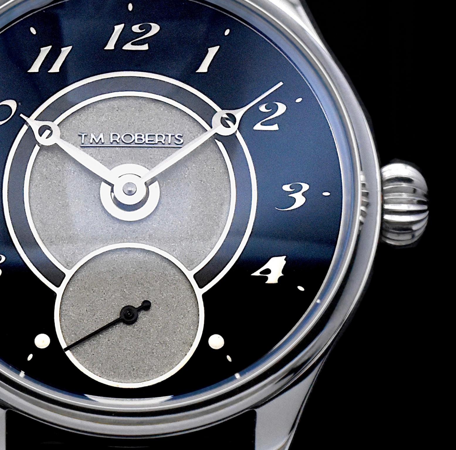

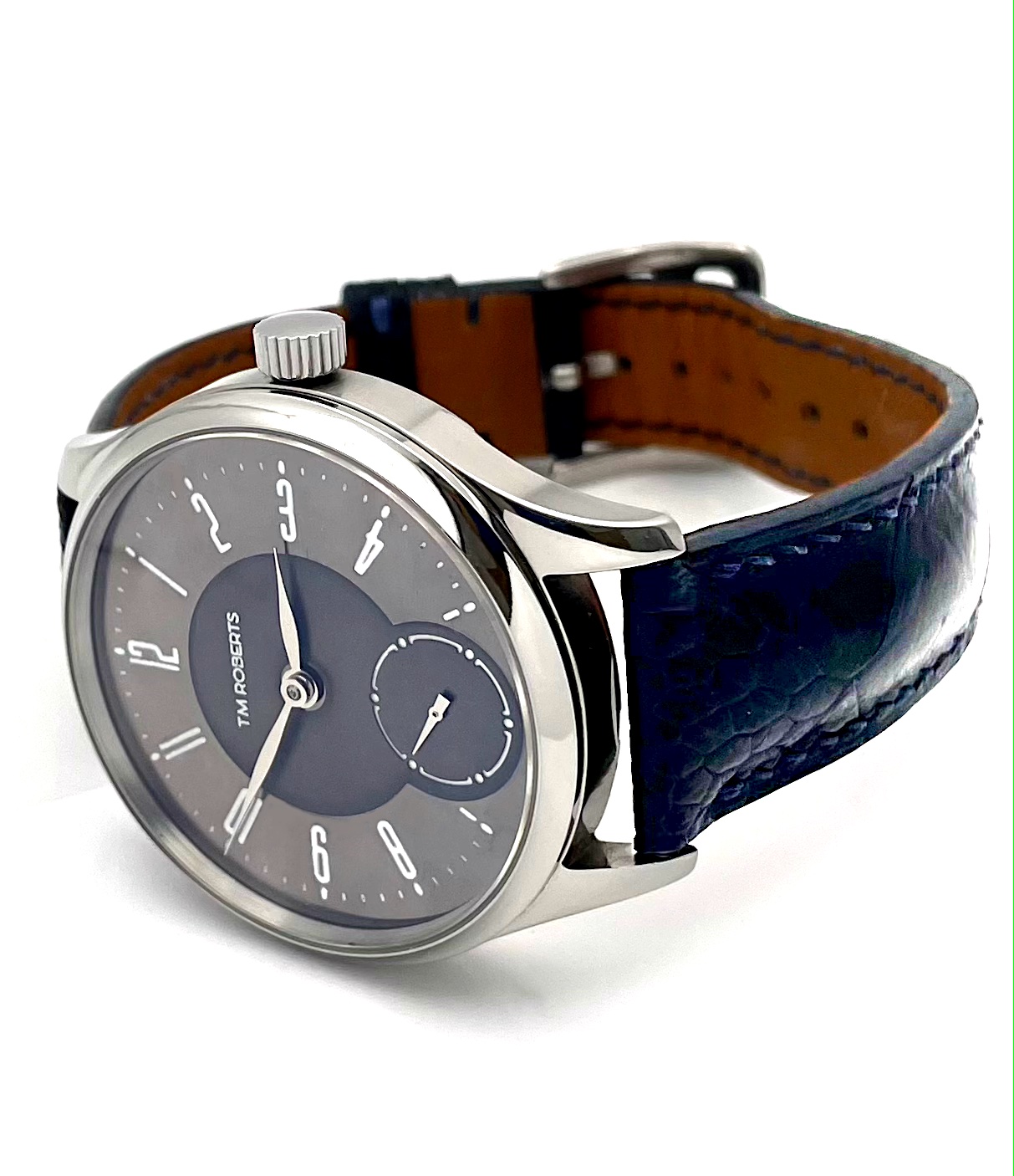

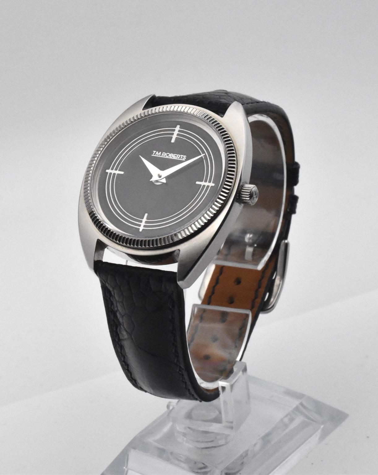

    Not sure how well this will be received, but I thought I would show you guys the sort of stuff I make. I know it’s not cnc related, but may be of interest to someone.
