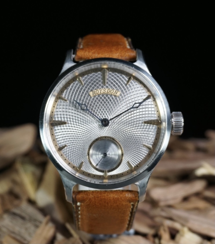

    Thanks John, it sounds like you have summed up what I need perfectly.
    I follow an American watchmaker that produced all his bridges, dial and case on the Nomad 3, so I guess I’ve been brainwashed. It’s amazing how effective a good marketing program with lots of content is. His ‘engine turned’ dial is exactly what I want to do. Click image for larger version.

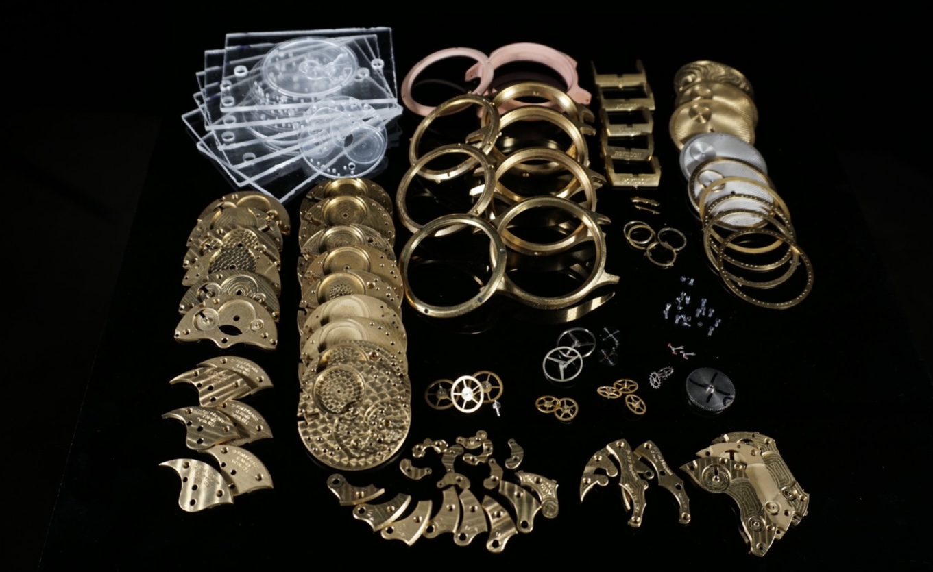

  9. #8
    Bridges and parts roughed out on the nomad.
    Of course I don’t know how much trouble he had in getting the nomad to do something like this.

    OK, well maybe the Nomad is more capable than my prejudice led me to expect! Does he cut steel with it? I was impressed that it seemed to happily do some thread milling on the case. The Carbide videos also show machining steel but they do say it's a challenge.
