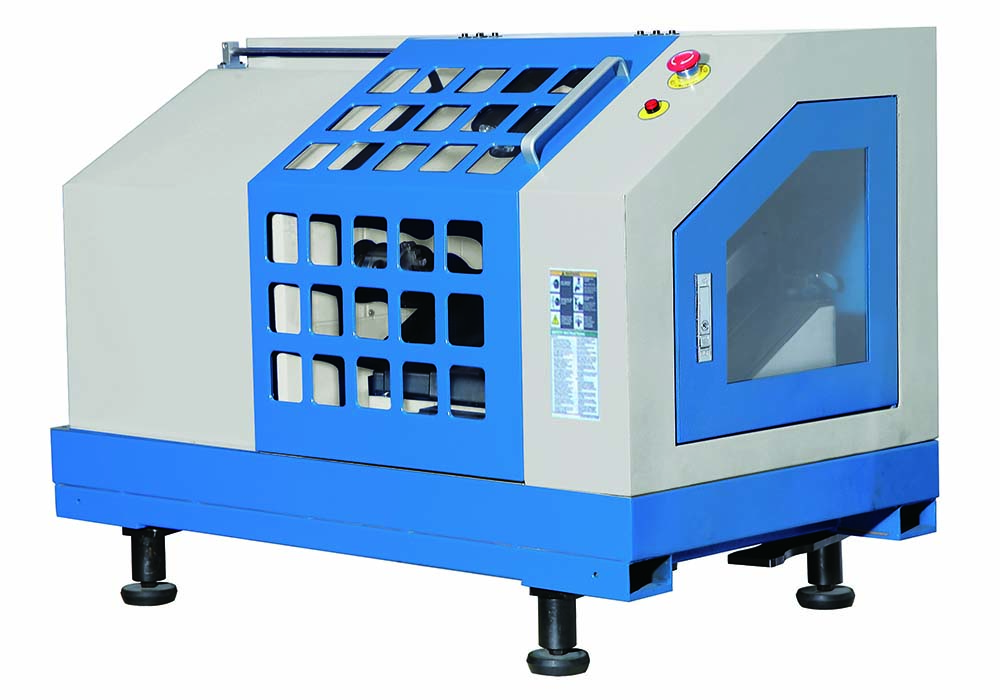

    Hi Doddy, yes I appreciate it will not offer an OTTB solution as well as giving me issues as I would have to pause code on one controller while I rotate the tool with a Mach3 solution. I really do not want to go down this route but SIEG have suggested a new KT510 will be $1100 plus VAT, duty and shipping which is money I cannot spend at the moment.
    Yes, the KT510 is control system and I would have to resolve timings, etc. Again, not a route I want to go down but may not have a choice if I want a working lathe.
    Here is a picture of the lathe:

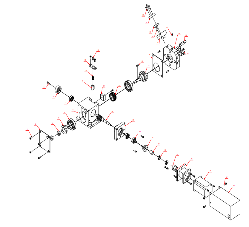

    Its an 8 position ATC driven by a Yako YKA2404MA stepper motor driver.
    https://www.yakotec.com/index.php/proview-21-15.html
    ATC Schematic:
    Lives in East Lothian, United Kingdom. Last Activity: 4 Hours Ago Forum Superstar, has done so much to help others, they deserve a medal. Has a total post count of 2,992. Received thanks 376 times, giving thanks to others 9 times.
    Before I make any suggestions, I'd like to see some photos of the lathe in question, and any information on the turret.
    Personally, I'd say it's more likely to be some kind of electrical failure (what actually rotates the turret?), rather than the controller. It would be good to know what checks have been done to establish that it's a controller issue.
