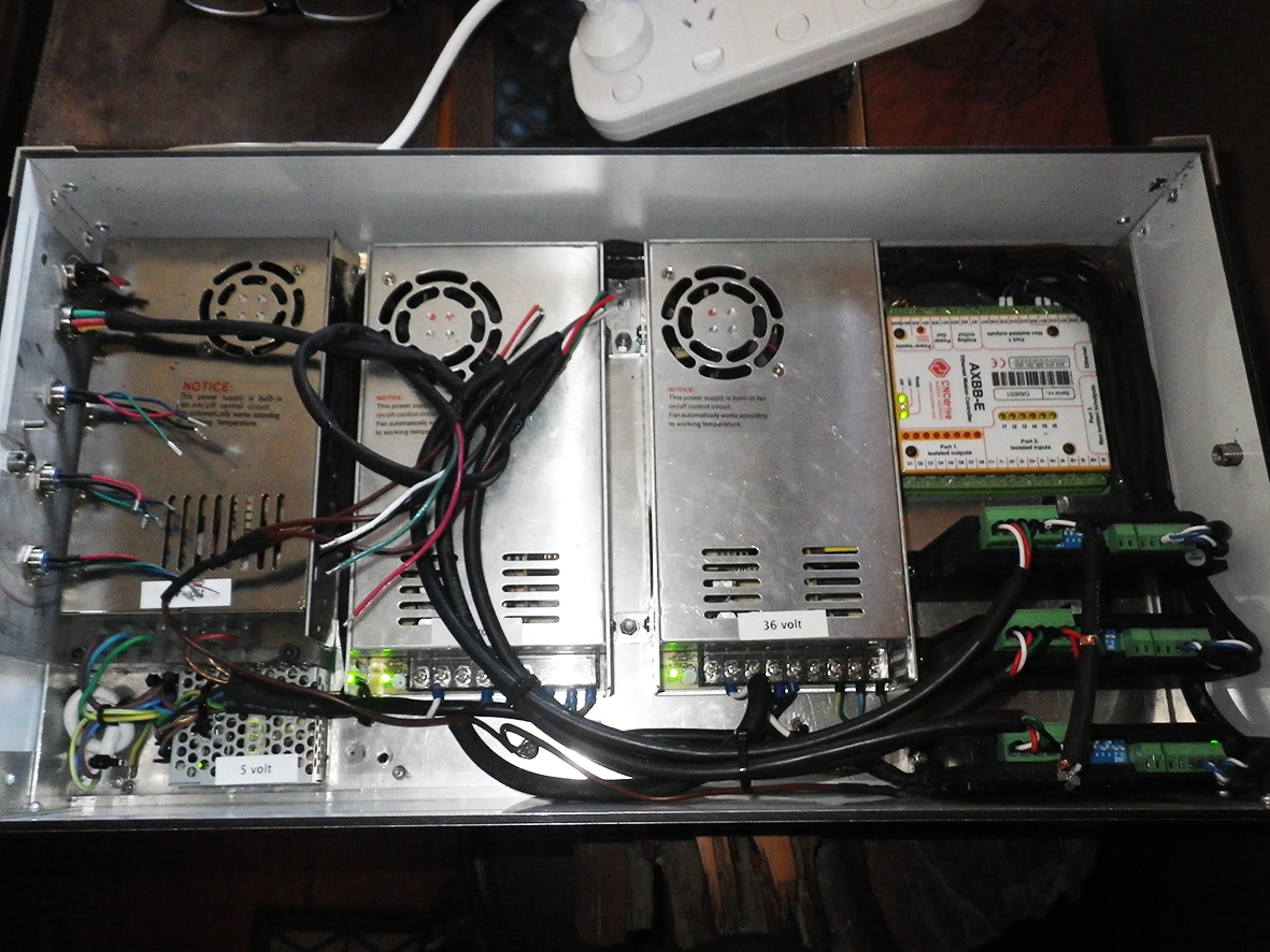

    I've made and wired up my electronics enclosure.
    I need to activate my UNCNC license and get my computer to communicate with my AXBB-E unit.
    I have a windows 10, 16 gig ram laptop that I will use to control my 60 / 40 CNC
    It has an ethernet port. I bought a new crossover cable and apparently the AXBB-E unit is powering up correctly.
    The laptop will not allow me to change the IP to 10.10.10.10 sub 255.255.255.0 messaging that more information is required
    It indicates that the AXBB-E unit has an incompatible IP address.
    Connecting to my (windows 11) office computer allows the IP address to be set to 10.10.10.10 sub 255.255.255.0
    However UCxxx cannot recognize the AXBB-E unit. When I try the blue link led blinks which I assume indicates that there is a connection. Both the green leds are lit so the unit seems to be powered up and working correctly (see photo)
    The UNCNC software wlll only open in demo mode and there seems to be no way to activate the license key.
    From google searches other have encountered the same problem.
    I've spent about 12 hrs trying various ways to sort this.
    I've written to the supplier and manufacturer for advice waiting on replies.
    Any solutions would be greatly appreciated.
    Thanks Evans

    You don't activate the license, all you do is place the license file in the UCCNC root folder. Then, when you first start UCCNC it will do a firmware update with the new license info; from then on, it will just load normally.
    Why the laptop isn't seeing it I'm not sure, but usually, it's straightforward. We use Laptops using all versions of windows from XP to Win11 and never have any issues with the Ethernet side.

    The default IP address on the board I believe is 10.10.10.10
    So you have to have a different IP address in the PC
    So you have to have something like this. 10.10.10.11
    You need to set your laptop ethernet as 10.10.10.11.
    10.10.10.10. Is the AXBB-E address. This is why you can't use this ip on the laptop, because it is an ip conflict.
    ...and I found the manual to be a bit confusing about this address business as well when I was setting up my UC300ETH. I found out by pinging the IP address from the Windows machine and finding 10.10.10,10 already out there. Good news is that it's been absolutely solid ever since I got it right! Once you know what the problem is, you can read the manual and see that it is correct. It's just that that's not how you read it first time through...
    Some progress this morning UCxxx is recognizing the AXBB-E it gives the serial # as CAOED1 and IP address as 10.10.10.11
    However not yet worked out how to get the license key installed. Which exactly is the UCCNC root folder ?
    I've tried copying the license text to UCCNC exe.config and UCCNC but not getting any joy.
    When I power up the AXBB-E and open UCCNC it says "valid license key not found ! application will run in demo mode"
    Once I sort out this hurdle and know the license is recognized and the computer and AXBB-E are linked I'll go back to trying to get everything working on the laptop.
    Thanks for the advice Evans
    The root folder is the folder where you installed your UCCNC program probably C:\UCCNC
    If you right click on your UCCNC desktop or start menu icon and go to properties open file location it should show you where your root folder is.
    Andrew

    The root folder is where you installed UCCNC, as mentioned by Waldo this is probably C:\UCCNC.
    You don't need to copy the text just paste the whole file sent to you into the Root folder. This is why you are not coming out of demo mode as the AXBB-E needs to update it's firmware.
    The 10,10,10,10 is another matter and often works for most PCs but occasionally network conflicts can happen and often 10,10,10,1 and 10,10,10,11 will work.
