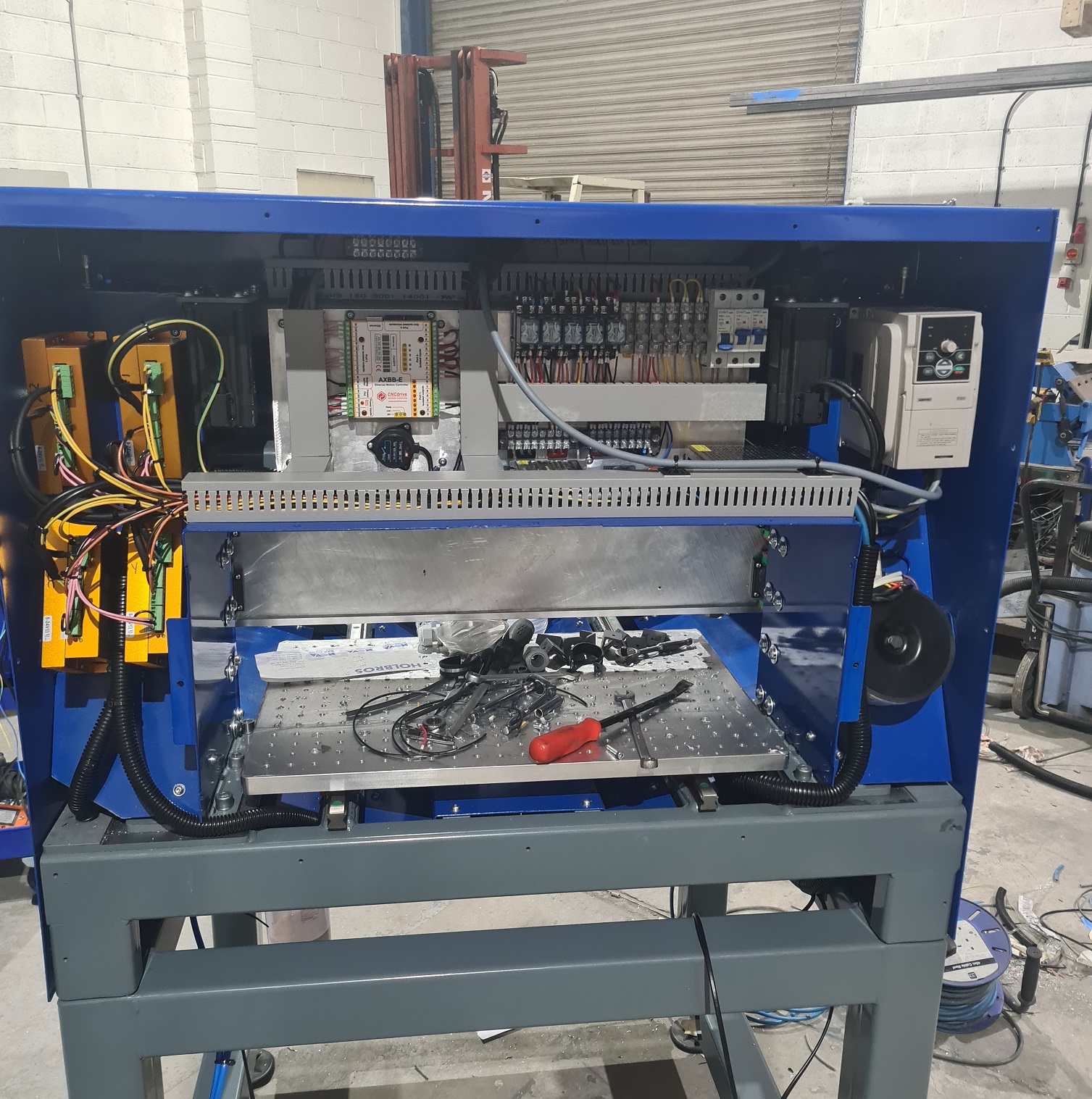

    Any chance of a peak in the control cabinet? Not sure I saw a door so if it's an effort to remove covers etc. (or not tidy yet!) then no problem.
    The electronics are shoehorned into the back of the machine as we didn't want a separate case, it was a tight fit getting everything in there but worked out ok. This is the only picture I have.
