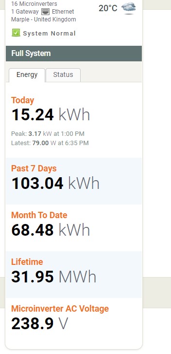

    I have just ordered a Growatt AC Charger & Growatt 6.5kw Battery for my 4Kw (16 panels) PV system that I have had for 8.5 years It has generated 31.95 MWh to date.
    My system has a small inverter under each panel so it outputs 230V AC so all the panels are connected in parallel (enphase) If you use a system with just one inverter they have to be wired in series and bring 450V DC ish down to the inverter..
    I also don't let any power to go back to the grid as it diverts surplus energy to the immersion heater (boiler set to 30c and the panels bring up to 70c most days.
    This is achieved with a box I built for the job .
    The company I am using to install the battery and Charger is ([email protected])
