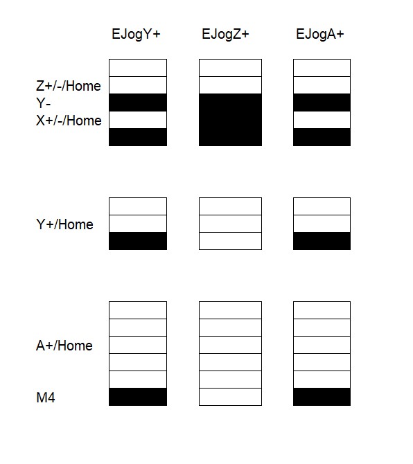

    Can you trigger each switch in turn and see which indicators light up on the diagnostics screen? I assume that these Mx indicators map to the notional 6 axes that Mach3 can handle but why they have not picked up the usual X/Y/Z etc labels I don't know.
    I switched to UCCNC on both my CNC machines so I can't replicate this screen, unfortunately. I had been using Mach3 with an ESS but had problems with it so swapped to a UC300 and UCCNC - but not the same problems you are seeing.
    It’s difficult to describe what you ask Neale because when I click a switch I can’t take a snip so I made the attached sketch. The black cells mark from the top down the lights ON in the indicated axis on the left of each bank.
    But in my notes I found that M1=X, M2=Y, M3=Z and so I don’t understand why when I reference the Y I get on the diagnostic screen the M4 lights as shown but only for a few seconds and then I get the message “Limit switch triggered…”

    If the Y and A axes are moving at different speeds, that suggests that something like the "steps per" settings are different, or maybe the driver DIP switch settings are different - but neither explains your other symptoms! I almost suspect ESS hardware problems, but it's very difficult to diagnose remotely like this.
