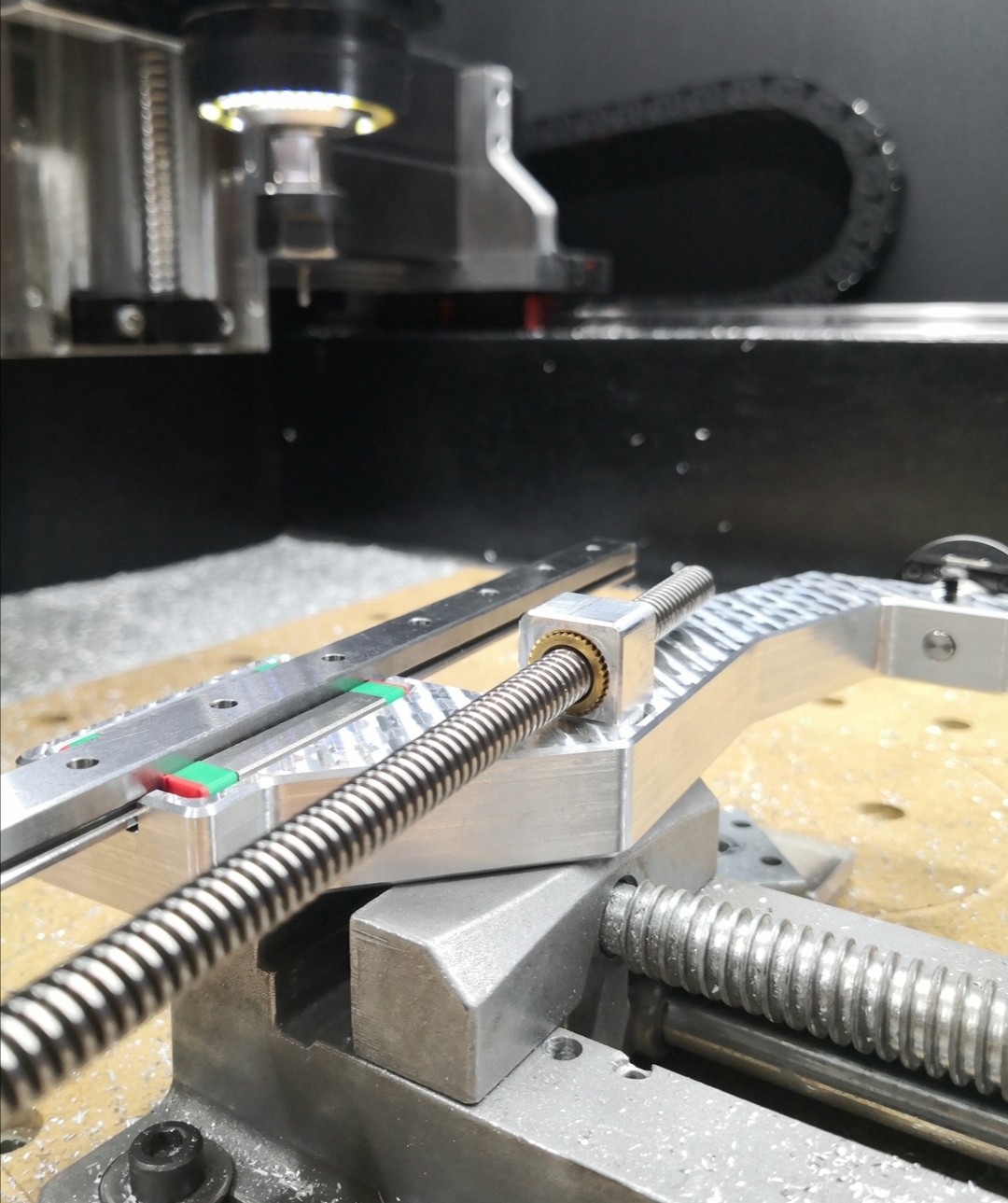

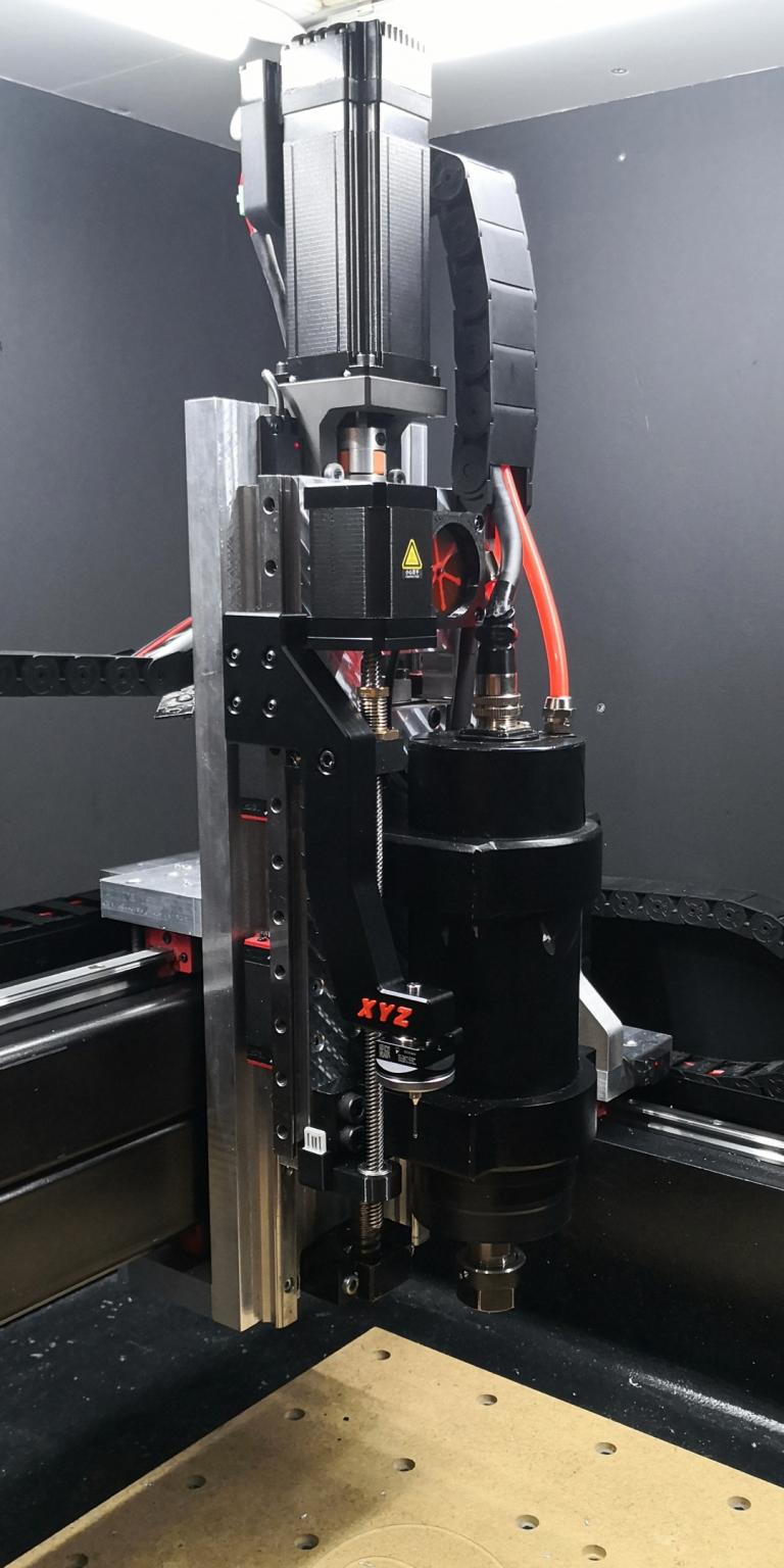

  1. #21
    Just dropping a pic

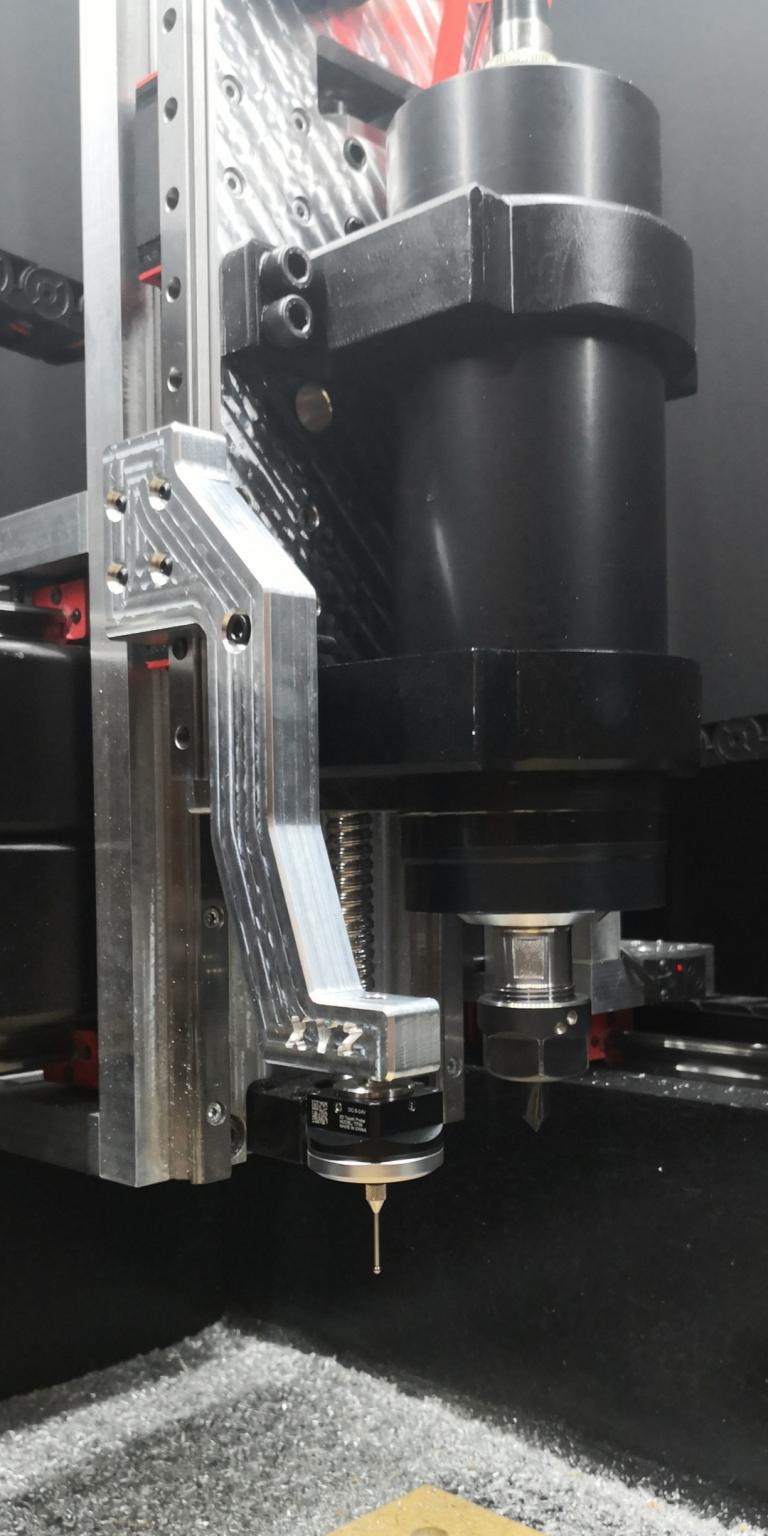

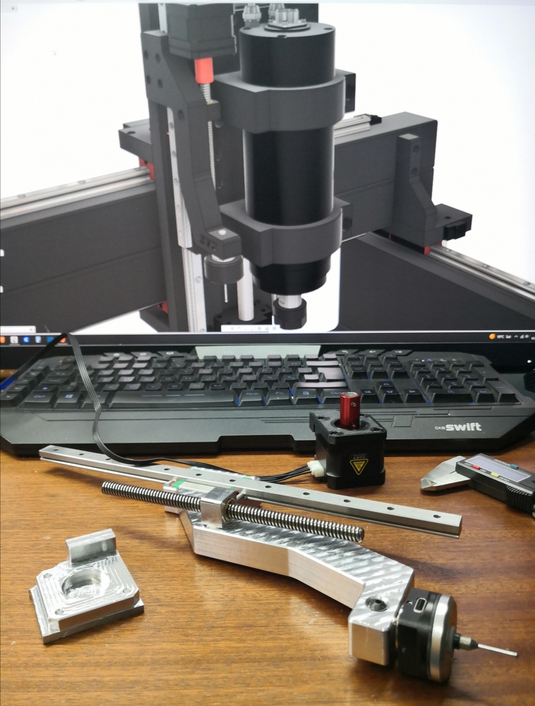

  2. #22
    Tomorrow will try to make this project.
    Been dreaming for a on-board probe for a long time.
    Hope it goes well... in CAD always looks nice Lol

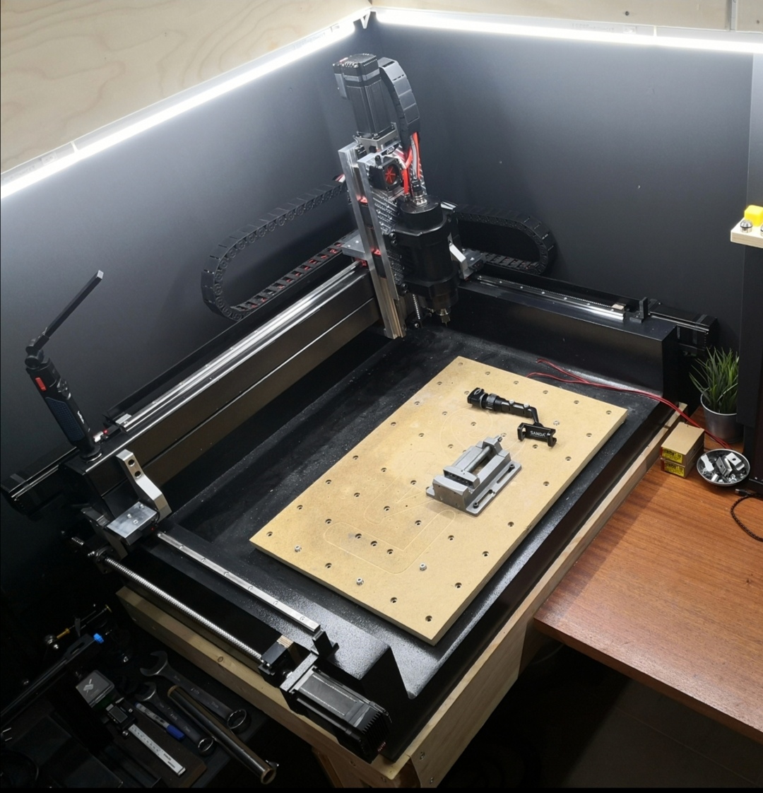

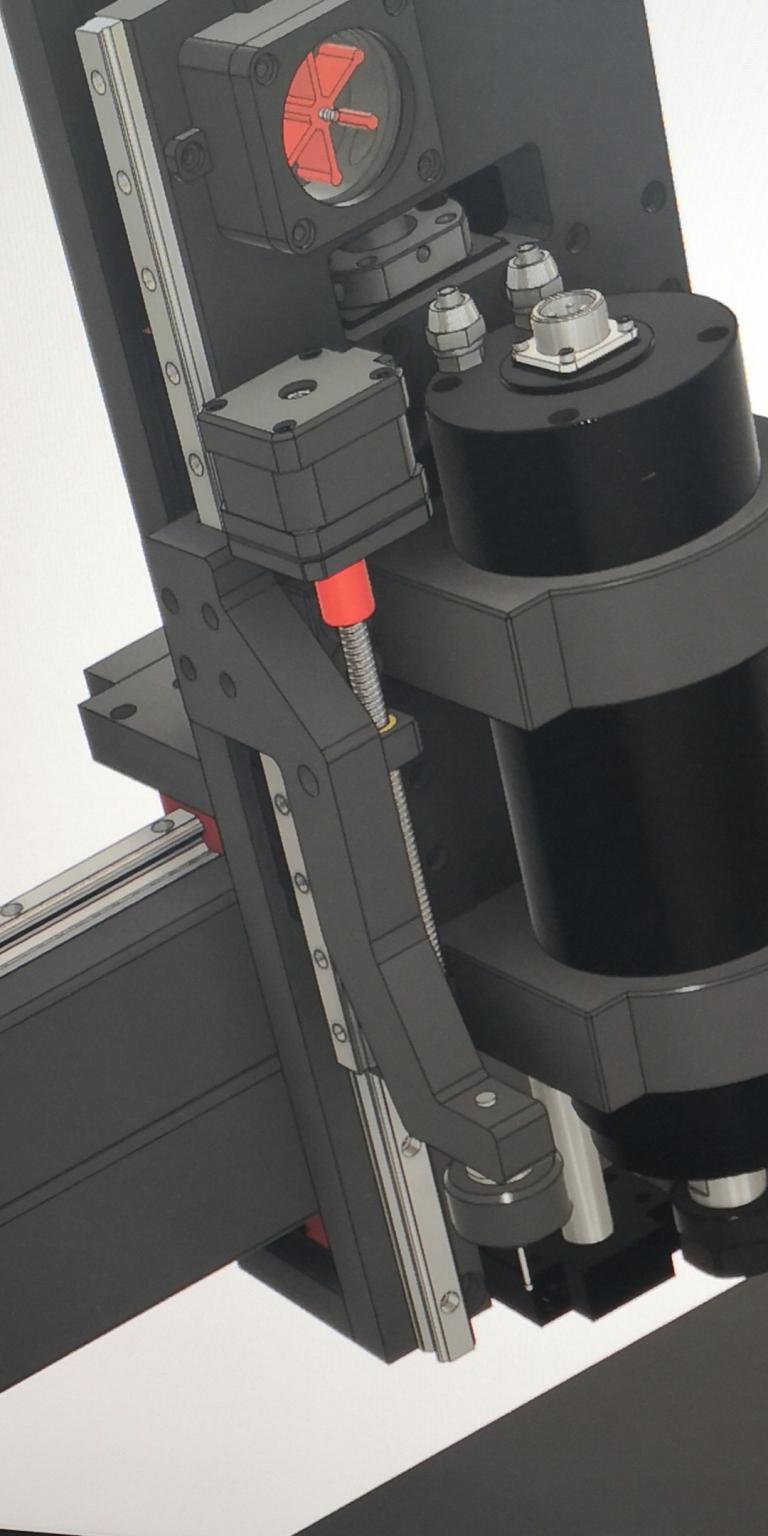

  3. #23
    First part is done and test fitted.

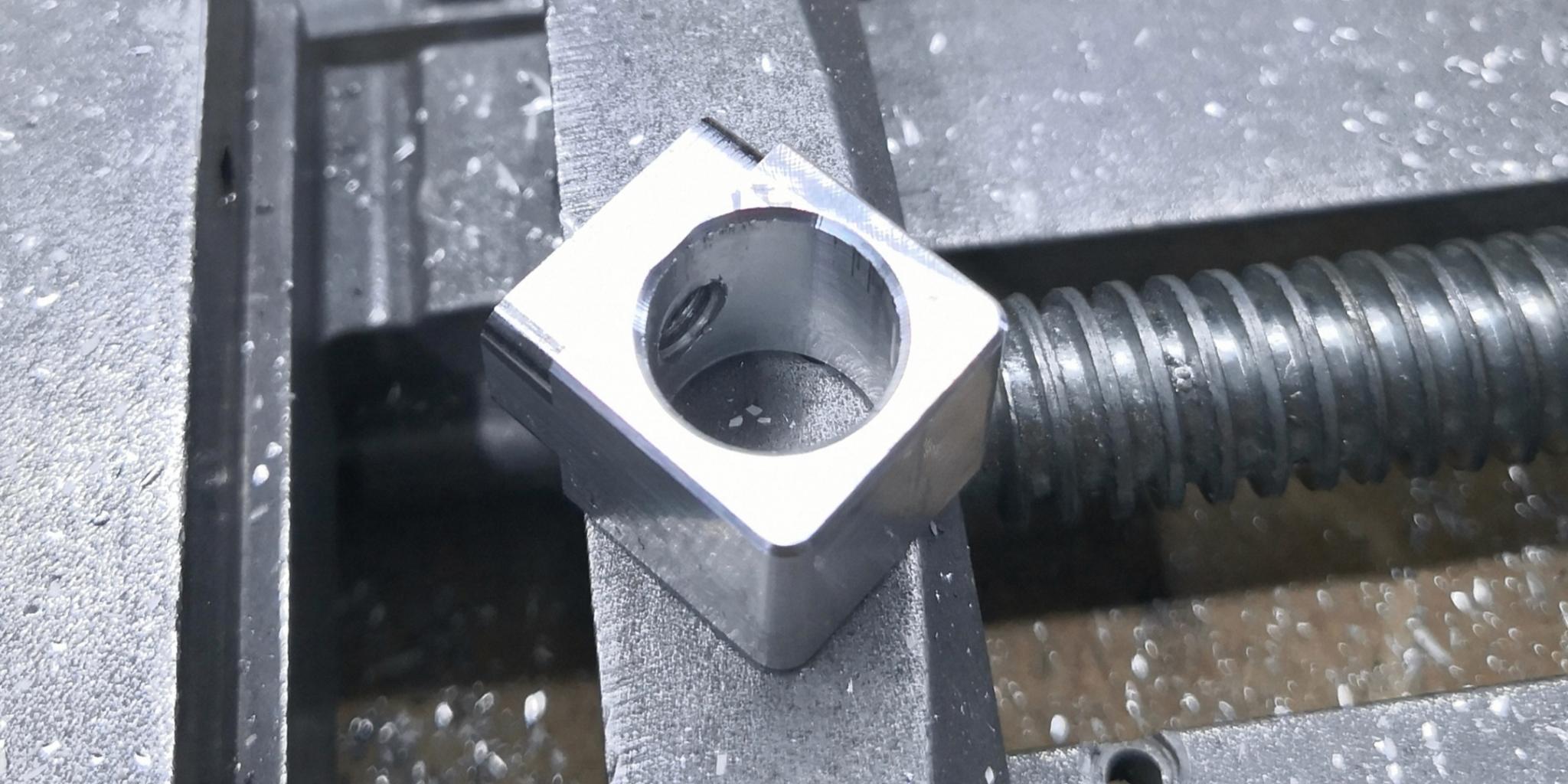

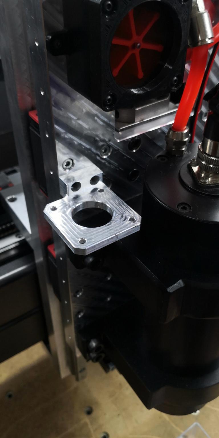

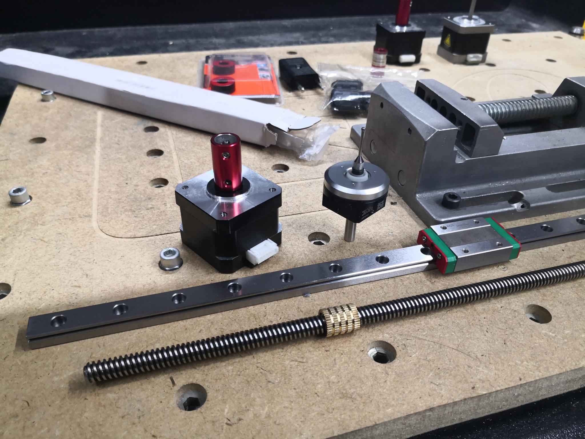

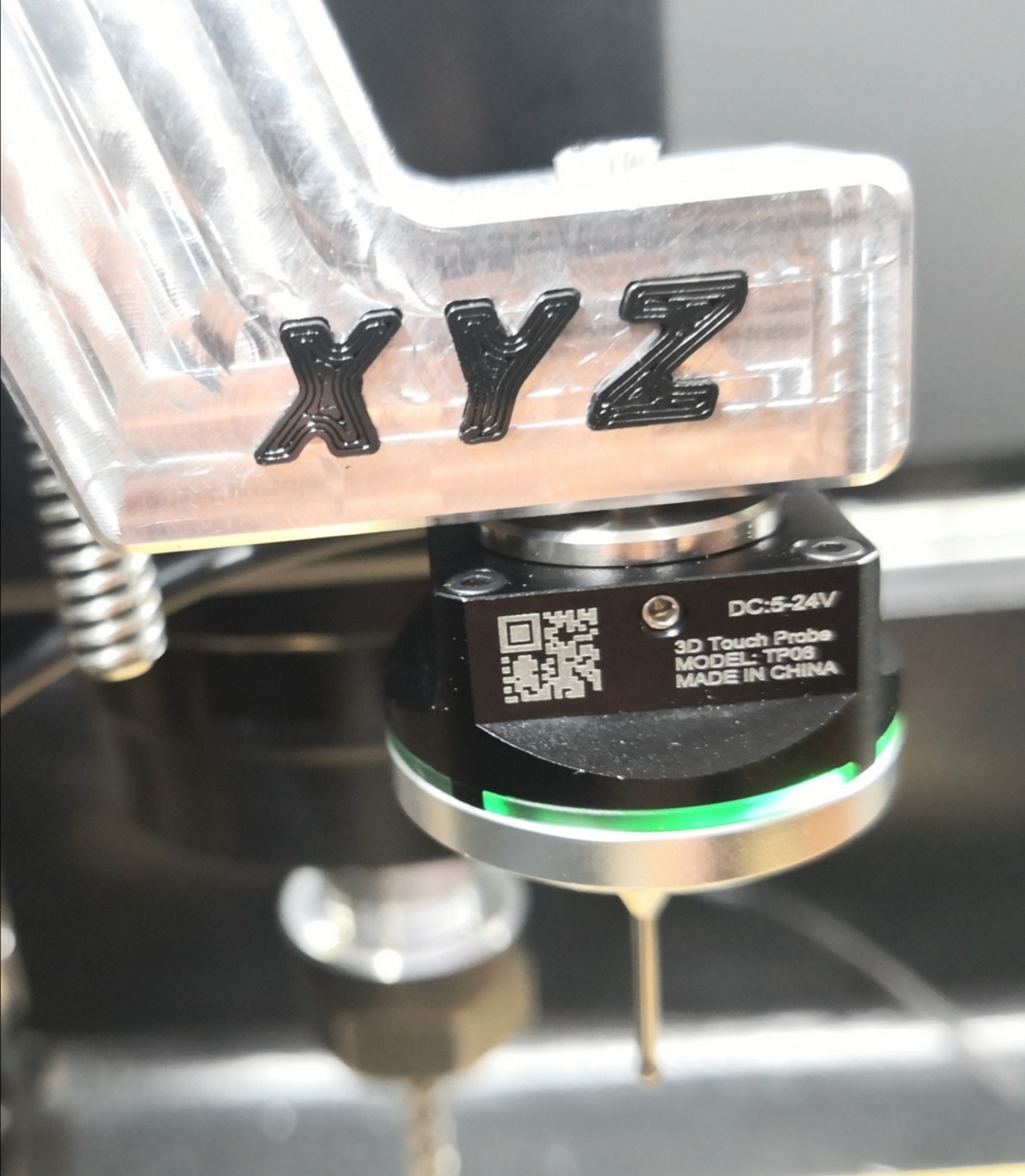

  5. #25
    Today machined the other 2 parts for the on-board probe assembly.
    Never had to do parts so small and with 3 side operations.
    Project is not finished yet and it's been a hard task lol
    Here's some pics and a short video of a test probing Z.
    Still got to paint all the parts black and 3D print the XYZ lettering in orange/red...
    Video
    https://youtube.com/shorts/f09qZGXBWxc?feature=share
    Some pics of the build

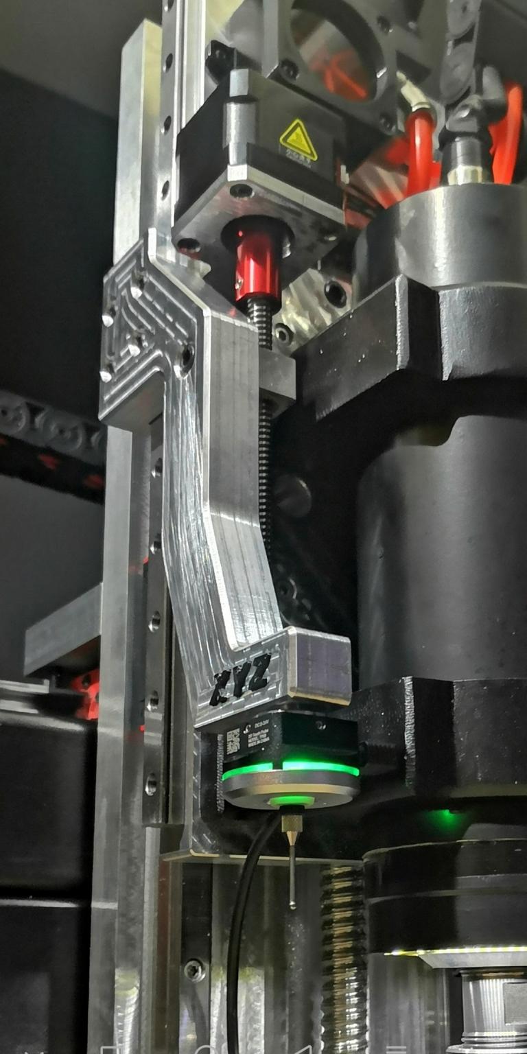

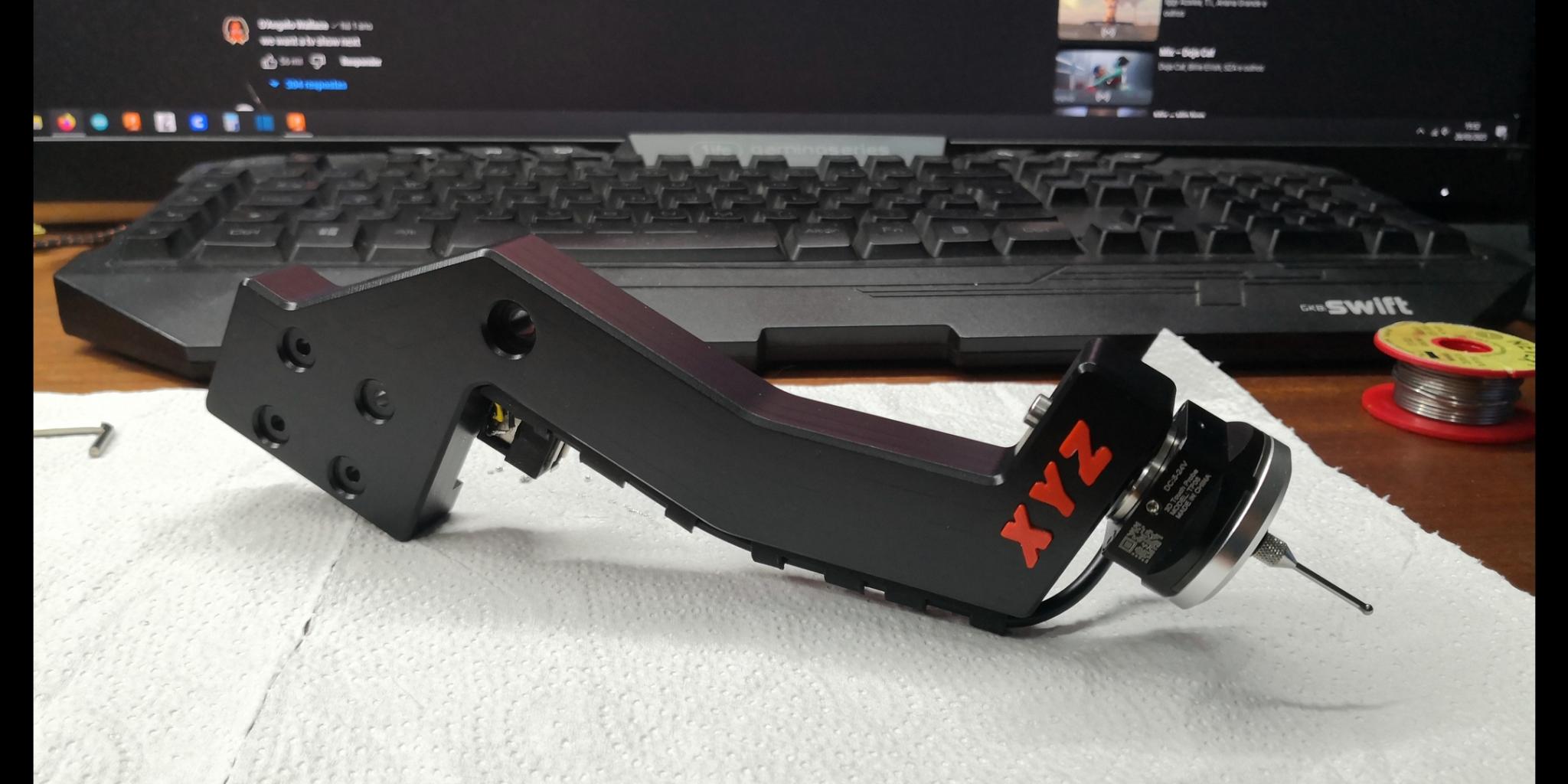

  6. #26
    Prototyping the connections and cable management to look as clean as possible.
    So that I don't even have to plug and unplug the USB to the probe.
    Looking sexy...
  7. #27
  8. #28
    Nice!, it will be interesting to find out if you run into any sensitivity issues when you run a probing command, I know someone who has done a similar setup but using a linear actuator rather than a motor, the stop/start forces as gentle as they are, cause his specific (similar style) probe to detect the movements as tip indications/false contacts with the part as the probe moves down ready to be used.
  9. #29
    My probe only gets connected when it gets to the final position.
    You can see that happening int these videos.
