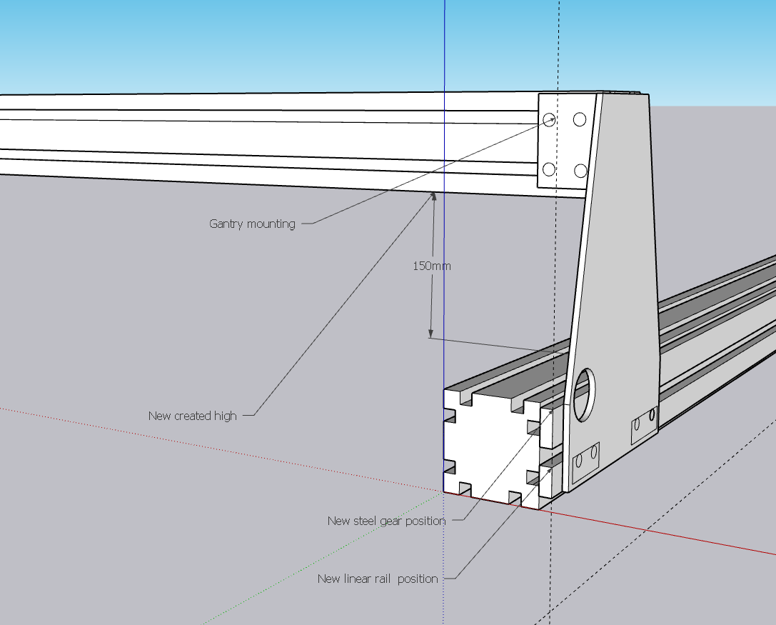

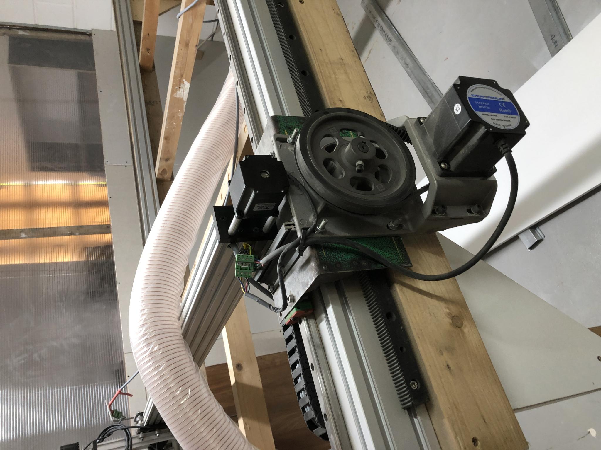

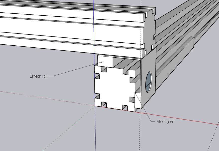

    I have assembled and successfully run machine for my small projects for about a year,was temporaly bracket. Now it become a time where I have to upgrade as it's not fast enough.
    At the moment is completely dissembled and restarting the project from the beginning, previously i have linear bearing sitting on top, but now is needs to be changed position as diferent router is going to be mounted.
    Planing:
    • change position steel gear
    • change position linear bearing
    • create space for router about 150mm
    Here is some pictures attached how it looks before and my quick sketch new bracket, i think to make from 4mm steel.
    Any recommendation?

    Hey Jaka, did you do this upgrade yet?
    I think you should swap the r&p (gear) with the linear rail, so the linear rail and bearing can take the forces before the rack (gear) see those forces, its a small change but would be a better design imo.
    Not yet, i agree that you said but need sort the bracket first as this upgrade can happen after
    Ahh ok, keep us posted with the progress :)
