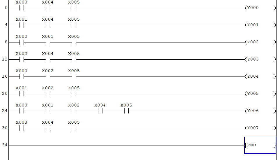

    We have a very old CNC that hasn't been used in like 20 or more years and since I just graduated, I was tasked to retrofit it. Along with this is the Baruffaldi Tool Turret - TOE100. The thing is, I was told to control the turret using a PLC (FX3U clone to be exact). I refer to this manual: toe1001st.pdf. Firstly, I need to test out the positions of the tool turret.
    The Encoder Code Table shows this:

    And programmed it like this:
Name:	PLC Program.png
    The problem is, when I test it, it does nothing. The contacts do not close in accordance with the should-be position of the encoder. Can it be that the encoder is faulty? If my wiring is wrong, can you guys help me?

    Are you manually rotating the turret to check the encoder outputs? That would be my first step. And I wonder whether the COM pin on the FX3U needs connecting to 0V perhaps?
  3. The Following User Says Thank You to Voicecoil For This Useful Post:
    Lives in East Lothian, United Kingdom. Last Activity: 12 Hours Ago Forum Superstar, has done so much to help others, they deserve a medal. Has a total post count of 2,994. Received thanks 376 times, giving thanks to others 9 times.
    Most likely this.
    Easy way to test the encoder outputs, is with a multimeter. If you're getting voltage, then the encoder is at least doing something.
    BTW, you probably don't want Strobe being used as part of the position calculation.
    Strobe is used as part of the locking process and triggers the locking solenoid timing.
    To calculate position, all you need are the Bits (A, B, C and D). You don't even need to use Parity, as it's sole purpose is to provide a basic value check.
    I still have the PLC code to control a TOE80 using a Click PLC, but I no longer have the software installed to view it.
    I'll try to test it. If it does not provide voltage, can I conclude that the encoder is faulty and needs replacement?
    In regards to Strobe and Parity, If I understand correctly, I should remove Strobe and Parity to the position calculation (the PLC program I showed) right? Then, I will use Strobe for another rung for the locking process. Right? And I should completely remove Parity from the PLC program and disconnect Parity from wiring?

    You can still use Parity for position calculation, as it does provide an extra check that the encoder is on a valid position, but Strobe is only needed for timing purposes.

    I understand the Parity and Strobe thingy. Thank you for explaining it to me clearly. Update about the encoder, I tested it and no voltage was recorded. Seems like the encoder is replaceable...
