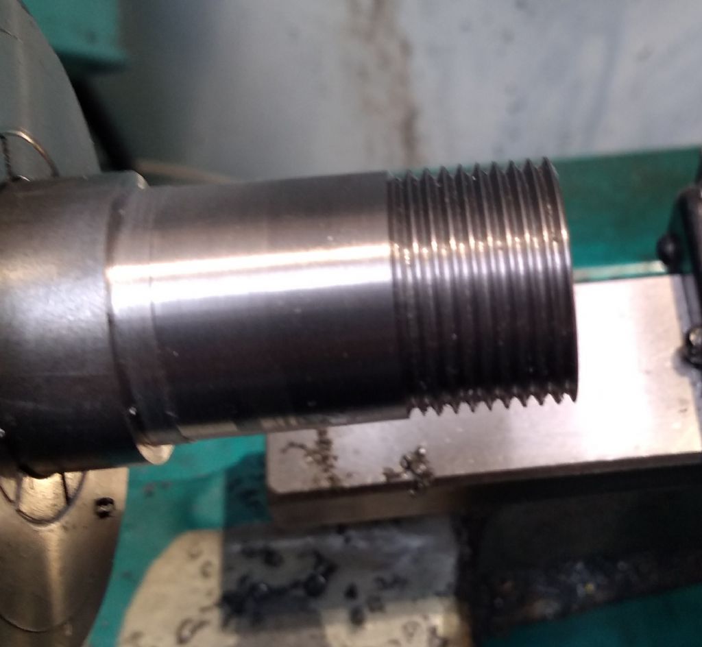

    For the controller I use Mach3. I have a single slot encoder on the spindle and for a lathe like the Myford with a fair amount of power and inertia this is fine for screwcutting. There is a lot of disinformation around about Mach3 and screwcutting, it does actually work pretty well. I attach a photo of the thread cut for an ER16 collet chuck which is a perfect fit in the nut. I cut this using the threading wizard, no adjustments needed, home-made tool, infeed calculated from the Martin Cleeve formula in his book.
