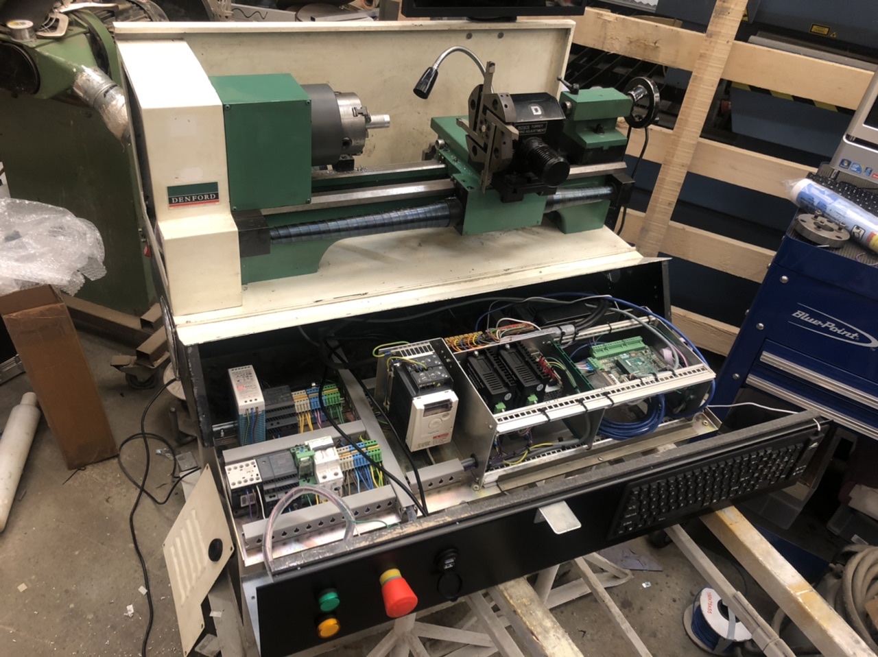

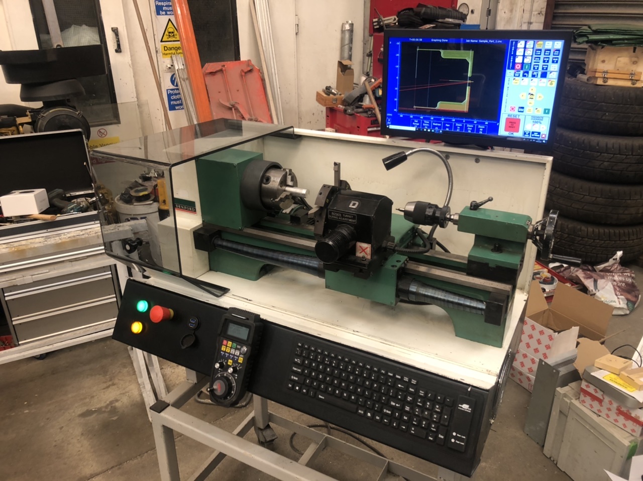

    Hi I just thought I’d post a couple of pics of my Orac conversion here. I bought the lathe in 2006 and I’ve just got it going so maybe I win a prize for the slowest retrofit...
    I went with Acorn because the software comes in a native lathe option, I’m really pleased I did- the conversational programming seems great, for example you just choose “thread” then you get a huge drop-down list of thread forms already in there. Also it was really easy to set up, a few clicks in the wizard and and bit of faffing for the ATC (soon they’re adding ATC setup for 3 or 4 bit grey code sensors etc to the wizard, which will make it even easier.)
    Now I’ve finished this I’m moving on to the Triac VMC so I’ll report back in 2030 :)

    Quote Originally Posted by Kered View Post
    Looks good but I don't think having the electronics in a draw underneath like that is a good idea as it limits use of cutting oil and fluids, all depends on what your machining but cutting fluids lengthen tool life. Your mill will probably be finished same time as mine
    Derek
    It’s how the machine was originally built, there’s no containment for coolant run-off so flood coolant was never on the cards. Dry cutting with carbide insert tooling and the occasional squirt of WD40 or air will be fine.

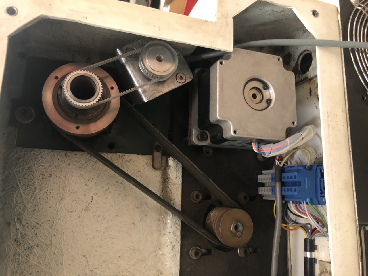

    Just bought a Orac, no ATC however. Will likely also go Centroid. Need to decide between keeping the steppers or putting servos on.
    EDIT, looking at the pics, looks like you have made your own encoder setup so that you can do tapping etc with Centroid?
    Yep I bored out a sprocket to fit over the rear of the spindle which belt drives an encoder on a bracket. Threading works fine in centroid with this setup.

    Mine has an pneumatic chuck, so have some piping in the way however I'm sure it can be done. Do you recall where / what you used for the encoder itself?
    Neale's Avatar
    Lives in Plymouth, United Kingdom. Last Activity: 9 Hours Ago Has a total post count of 1,748. Received thanks 299 times, giving thanks to others 11 times.
    I did the same re belt drive pulleys on my Orac - 1 to 1 from the spindle with the encoder on a 3D-printer adjustable bracket for belt change/tensioning. Threading works fine. Encoder is 100PPR, as recommended by PlanetCNC.
    I kept the original steppers but given that the previous owner had stripped out almost all the electronics but had not quite started on the replacement, I put a 68V PSU in there with appropriate drivers. Seems to work OK.
    I was hoping to use a UC300 and UCCNC to match my CNC mill and router user interfaces, but due to the fact that CNCdrive had been promising the lathe version for a few years but not delivering, I ended up with PlanetCNC. Haven't had any problems with that - seems to do what it says on the box. CNCdrive released the lathe module a month later...
    No ATC on mine either, but it came with a Multifix QCTP and a few toolholders. Not quite enough toolholders, of course, but there never is! New ones are not cheap, so considering whether to swap to a different but more economic QCTP. I have managed to set up the tool table for the few tools I have used but still need to improve the tool tip measuring process. Semi-automatic tool changing isn't too much of a sweat for my kinds of jobs although wouldn't want to do commercial production work that way.
    Been using the CNC mill a lot recently but will be back to the lathe shortly, I hope. I have been given some good ideas on tool table setup so need to find time to work on that.
