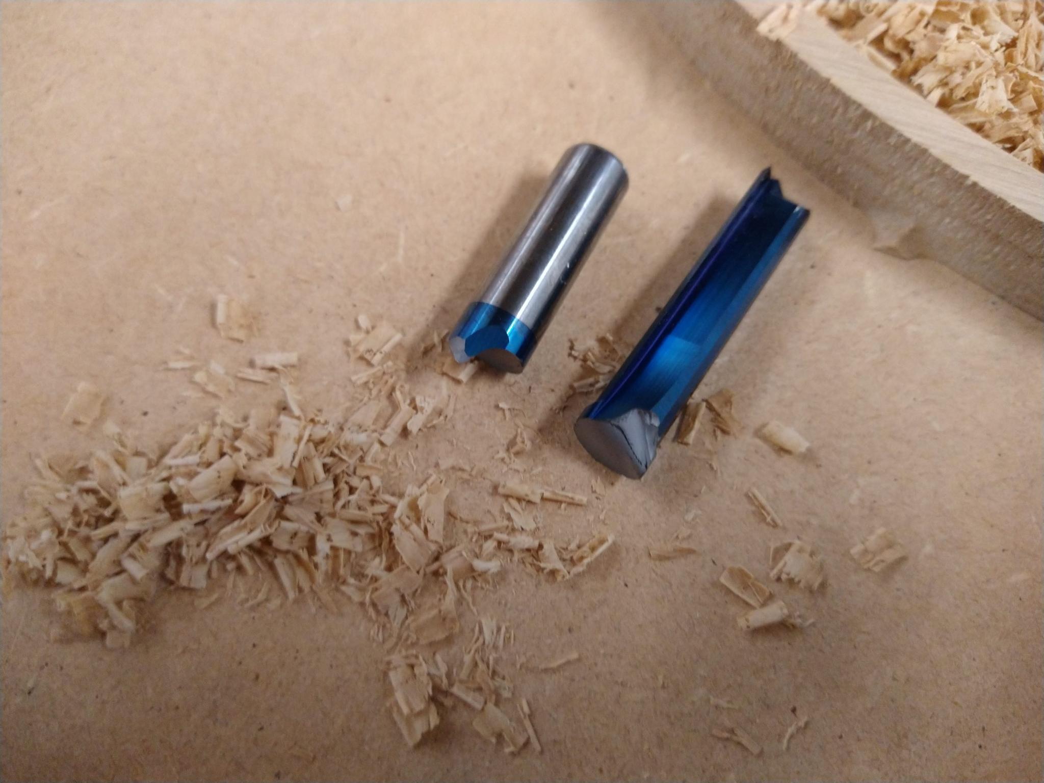

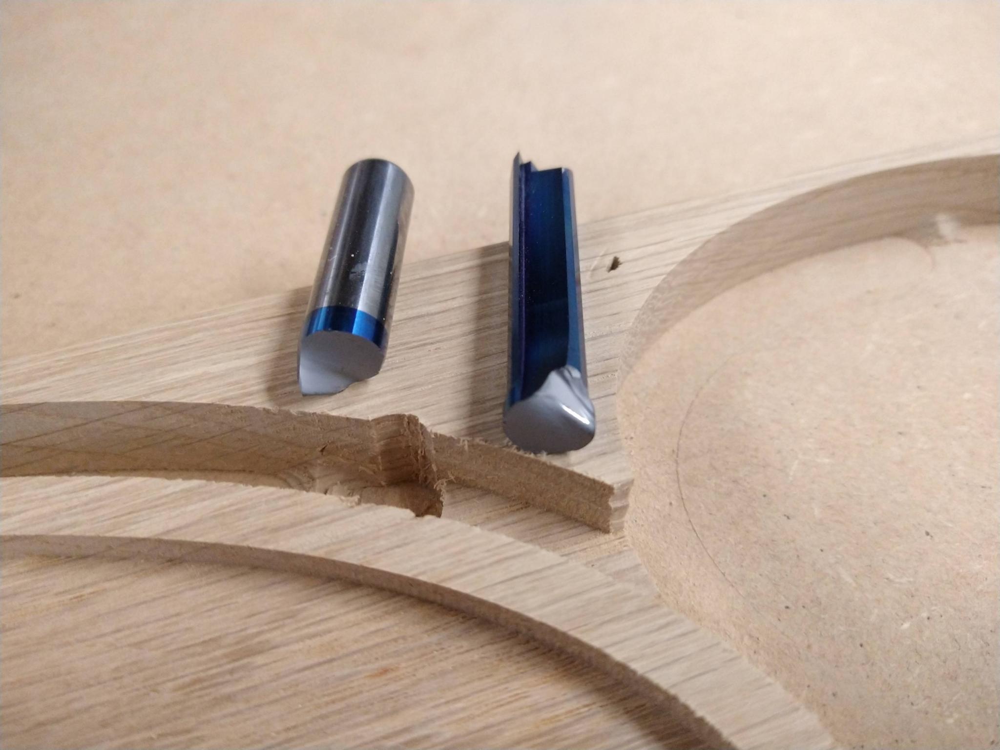

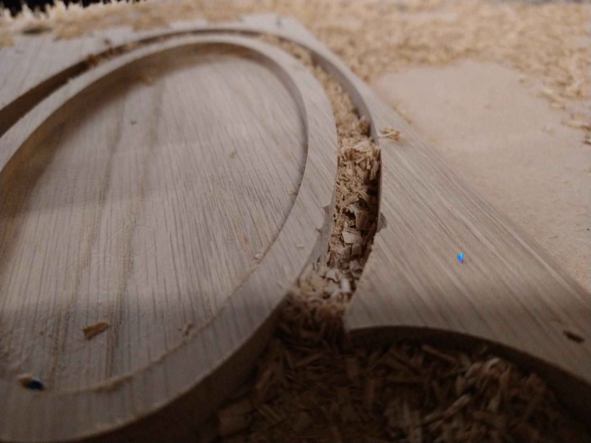

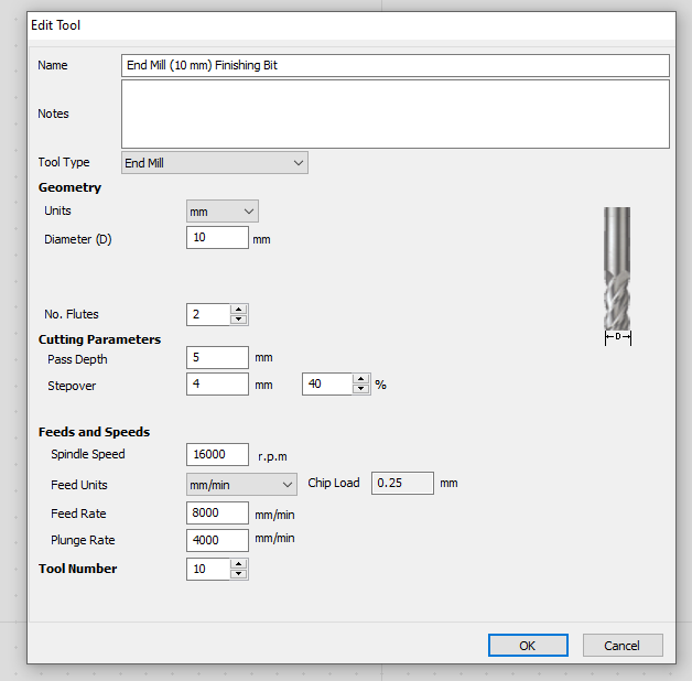

    Quick update. I got back from holiday midweek and on my return, I received a package containing some new endmills from XCAN - Aliexpress. All excited and stocked up on some lovely new oak boards from the local hardwood supplier I decided to have another go. I snapped the new endmill on my first attempt... I'm clearly driving these things way too hard. Time to take a step back and slow things down. Is there a way to tell if the endmill is actually solid carbide as advertised? Ideally, so I can rule out the chance of it being a low-quality bit. It certainly looks the part. It failed on a plunge almost at the end of cutting two parts out. Unfortunately no video.
    Here are my settings, again I thought I was being conservative with the settings 1/2 the chip load that the endmill of this size is supposed to be able to cut hardwood.
    Some pics of the fail.
  7. #17
    I'd say the plunge feed rate was to much, if your going to plunge with a tool designed for side cutting, its best to ramp into the cut if you can or use a drill operation first to open it up for the cutter to fit inside and then start side cutting. Or you can use a spiral ramp cut, did you use either of those or just plunge straight down into the oak?
    Edit:
    Is the second pic where the cutter broke in the oak?, it looks like it is and suggests a straight plunge...
