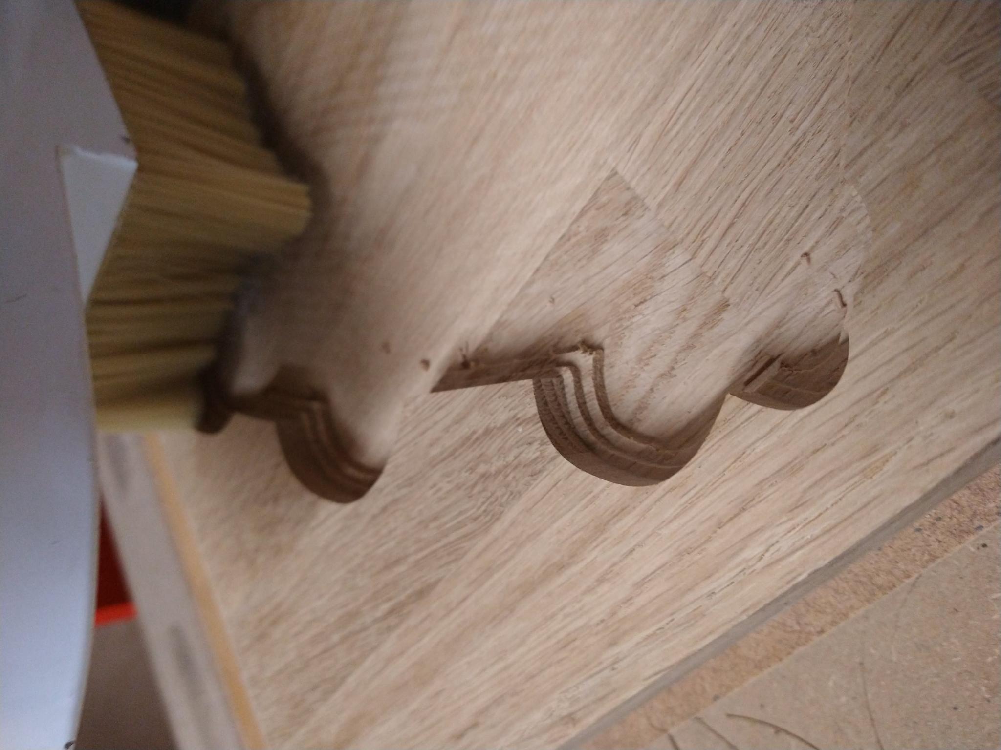

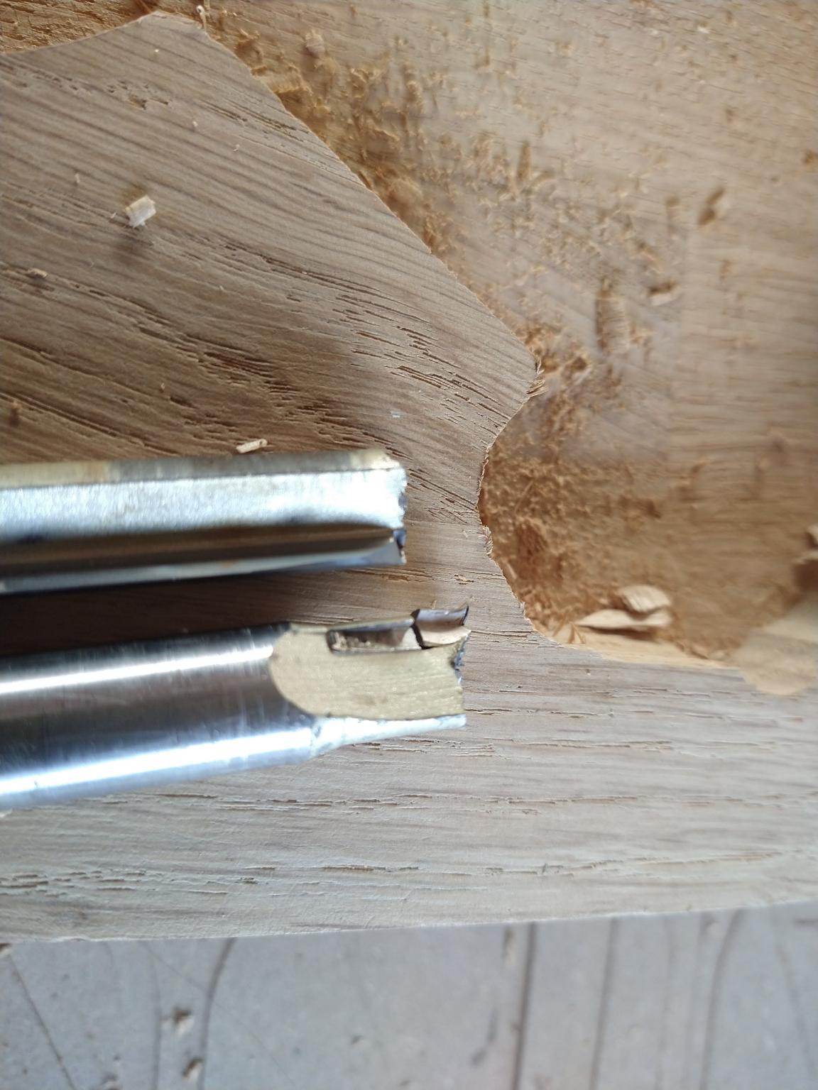

    I'm trying to pocket into 40mm oak to make a key tray. My first attempt worked fine and then I did a redesign and when cutting the bit failed. I was filming the cutting so I thought I would share it with you to get opinions on what went wrong.
    My thoughts are it was a mildly blunt cheap old endmill. I think the feeds and speeds were correct for the size of the endmill just not the quality of the endmill.
    These are my setting
    Feed rate 4000mm/min
    Spindle Speed 18000 r.p.m.
    Pass depth 5.96mm
    stepover 40%
    This is the endmill
    https://www.screwfix.com/p/erbauer-s...B&gclsrc=aw.ds
    And here is the video to see what you make of it.
    My thought are should I buy a new cheap endmill of the same type and reduce the feed rate a bit and try again or buy a more expensive endmill?
    Regards,
    Oli

    Next we should probably look at chip load and the relationship it has with speeds and feeds...?
    Your speeds and feeds are to high for those cutters at that DOC...wow just started the video and straight away you can hear its all abit crazy, have a listen yourself Oli. I know it's hard when you first get going and dont have anything to compare to...

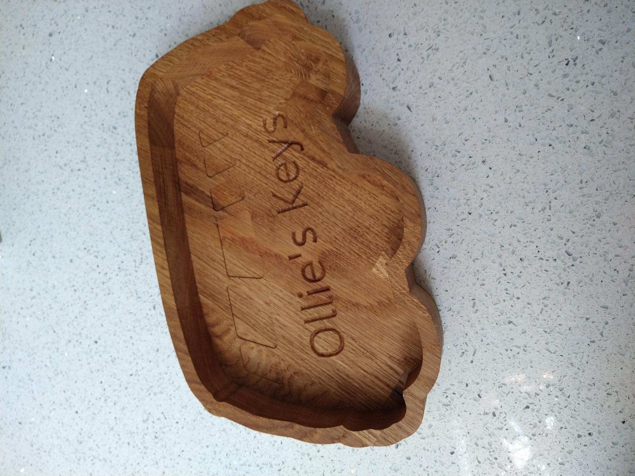

    I since finished off the project I was making using a 6mm solid carbide endmill and managed to recover the bit of wood thankfully.

    The instant the cutter started it sounded wrong and I almost hit the reset button but for some reason left it going. The endmill appeared to resonate at a different tone.
    Yea, my guess is the first job weakened the cutter, the second job killed it...you cant rely on those cutters, not if you want to do it properly with cnc :)

    You haven't said if you also adjusted the spindle speed, I'm going to assume you never and that's what allot of people do, they assume slower feed rate equals "safer" but its not always true, especially if they don't understand the feed rate/spindle RPM relationship to chip size/load. Lets do an example on the assumption of Oli not having changed the spindle speed and what those numbers then tell us about the chip size he was producing that may have caused the cutter fail.
    To do this we will need to do the maths the other way:
    Chip Load = Feed Rate (millimetres per minute) / (RPM x number of flutes)
    Feed Rate: 4,000 mm/min
    Spindle: 18,000 RPM
    Tool Edges: 2
    That tells us our chip load is: 0.111 = 4000 / 36000
    So we could assume that when the cutter failed for Oli it was because rather than producing proper chips sized at 0.483 it was instead "rubbing" the material away and producing dust relatively speaking, this rubbing then caused the tool to get hot and combined with it just not being up to the job, to then fail.

    Key tray looks great, brilliant feeling when you take something off the machine for the first time isn't it :)

    Good assumption for the 6mm endmill I used 4000mm/min feed rate 18000RPM and a 3mm DOC, stepover 40%
