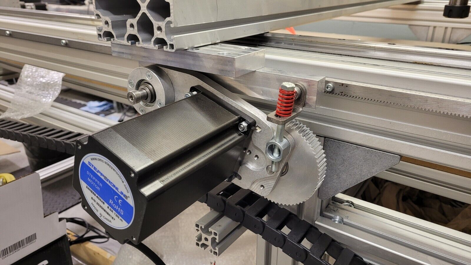

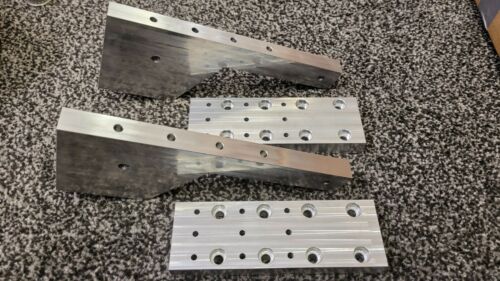

    A question I upgrade an Marchant Dice with an new solution I found this https://www.ebay.com/itm/265441061631 exactly what I was looking for. I Will have linear up on aluminium profile i think and use avid spring solution. So is anyone have an cad for avid gantry plate or this one. If
    I dont have experience to make an cad to make this or know if someone sell avid oen plates?
    Hej, är denna länk någon hjälp för informationen: https://www.avidcnc.com/support/inst...ard/downloads/
    Menar du en av plattorna på bilden nedan?
    Jag har inte cad men jag är säker på att vi kan hjälpa dig att lösa det?

    I only find dokument on avid site. They don’t sell there plates separately and the link with a even better idea on eBay he told me his plates was sold 10 minutes before I was supposed to buy them.
    Would be pleased if I can get an cad for plates or even better to buy them from someone here how can mill them.

    Ok, du kanske kan fråga honom (ebay-killen) om han vill dela sina cad-designer med dig?
    Jag kan eventuellt göra tallrikar åt dig när du kan få en design, du kan göra på papper och så gör jag caden till dina ritningar, behöver du exakt den ivrig designen, kan du göra din egen?

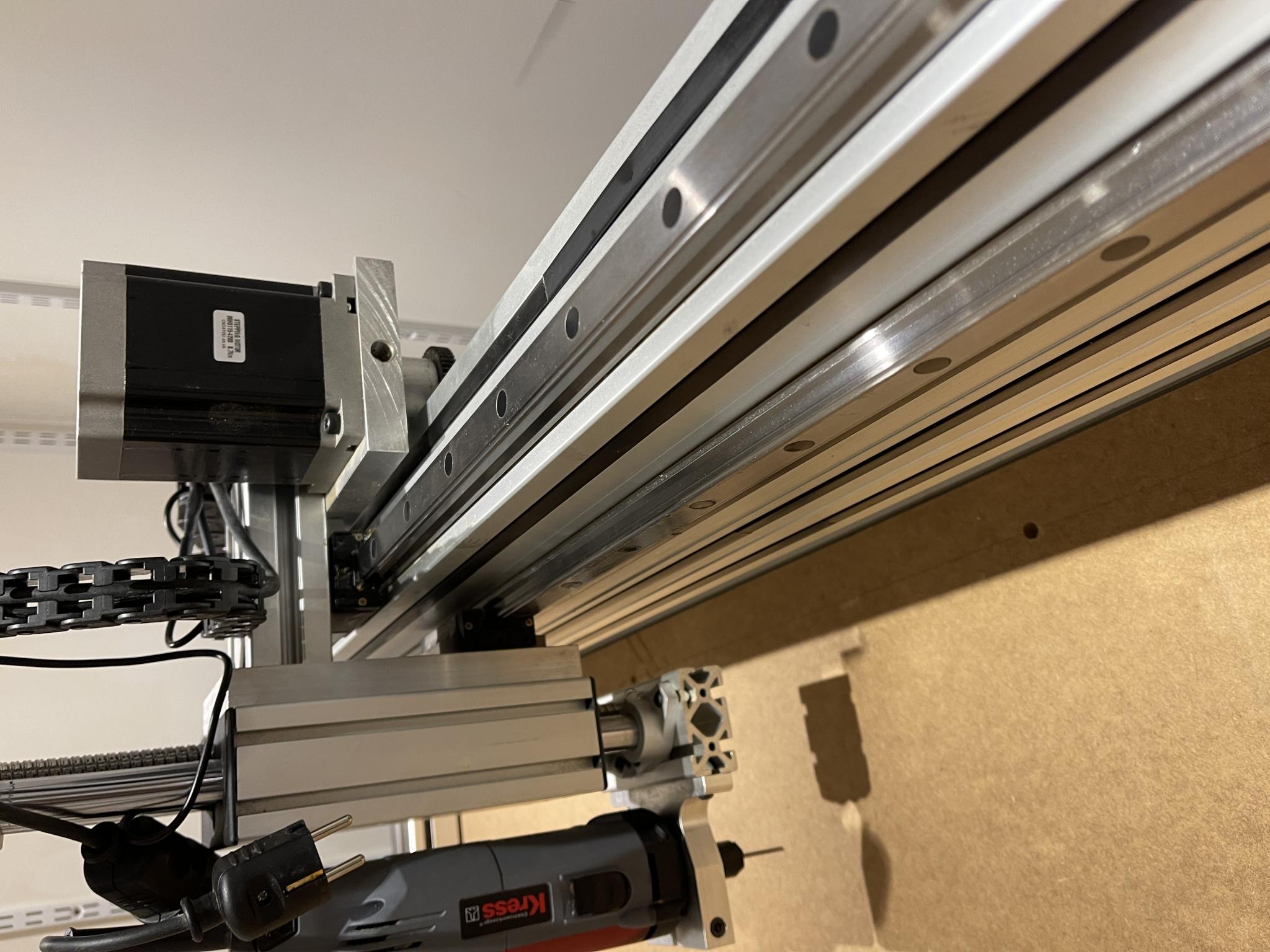

    For X my plan is to have 80X160 alu profile down and 2 hiwin carriage on each side attached under to Y and A like it is today on Marchant Dice machine, if its best to have it that way. I dont have a clue of whats smartest to have it.
    Then from my attached pictures when i look at it it looks like a stable idea to have linear on top and front instead of both linear attached on only front side, or do i think wrong here? Maybe is better to have like avid cnc one standing alu profile and then x axis profile resting on top of it to get lesser weight but it should be a more stable solution to have it as i have it now and its it on the ebay link? I will also have Avid CNC spring drive here.

    Quote Originally Posted by winzhangout View Post
    The seller dont answer me at all, so i will order new alumium profiles from Tuli and racks and drive from Avid CNC, then i can measure the size i want and where the hole should be located i dont know the fitting for avid drive where the spring hole and the bolt hole should be if someone else dont have it and can see.
    Ok so you are going to order the Avid CNC drive system, that's good we can make a CAD of the plates that way ?
    what is best solution for stability to have linear on top of alu profile and use the idea from ebay link on Y and A Axis or is it better to have the linear exactly as Avid CNC solution on the side gantrys togheter with the drive and rack on the alu plate?
    Absolutely go with linear rail on top of ali profile, not for stability but for an easy life when you need to make everything on the same plane and aligned perfect to each other, the side mount for linear rail is just harder and more time consuming to get really nicely setup. On top you will find it easier for alignment and more so making the adjustments for this work/ procedure.
    You know about linear rail alignment and setting up right?
    I would put the rack and drive mech on the side yes, it works well and keeps everything away from the chips and dust ect, you should factor a cover for this stuff maybe.
    I will say it doesn't matter greatly, however at some level 1 rail on top and 1 rail on the front is better, again it becomes about alignment and setting up really, my advise is to put the front rail first at the bottom of the front so it is close to the cutting as possible, when you have the rail in place, you can use it to help do the alignment for rail #2 on the top, use the whole Z axis assembly to guide the "lose" rail on top, to the place where it will naturally like to live. After you can then use DTI and spend the time to do the highly accurate alignment of the rail etc.
    Really the profiled linear guideway and bearing of this type dose a great job with either rail positioning/location, but generally you should try and keep them as close to the cutting forces as feasibly possible, making sure of course that they will be before the leadscrew or to say it best "the drive mechanism", you must do your best to stop the forces from cutting etc, from reaching the drive mechanism.
    Again, absolutely go with this ebay design (in the pic below), no design should ever have the gantry sides so that they are like "stilts", its just so obvious to look at, that it is a bad design!...then you see the designers try and make good and overcome the instability/rigidity by now putting extra plates, corner brackets and an effort to "brace" everything together etc...
    It is really quite disappointing to see, especially when you also see how popular the said machine becomes with the community...sure it works and you can cut some stuff but that doesn't make it right...

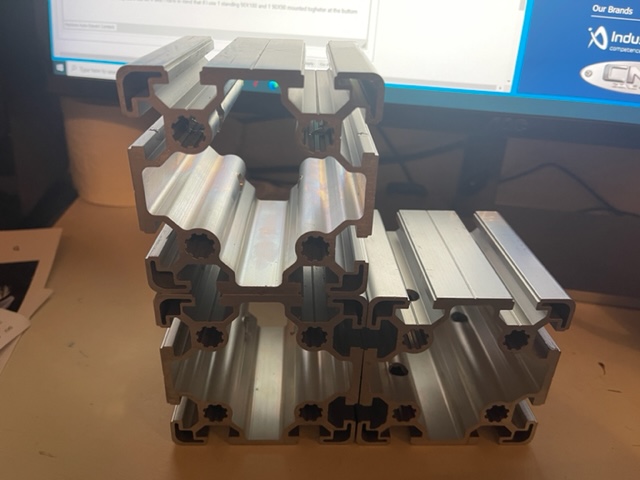

    Ok i stick to that solution as the picture but as X axis i have in mind that if i use 1 standing 90X180 and 1 90X90 mounted together at the buttom, i add a picture of how the X axis looks from side, on the picture its only 3X90 just because i dont have order any 90X180 yet. The 180mm can be laying down and the X90 on top on if also, dont think it matters how it be mounted. the extra 90x90 is for carrier of cables and think it be more stable if the X axis is wider for the hiwin blocks that can be with more distance between them.
    Maybe if i get an 20mm aluminium plate or something thats little bigger then the 180mm so i can screw the linear blocks first from top of it then also make holes for mount it below the X axis U10?
    But next thing is X2 20mm linear on top also a bad idea, i think it will fit or is 1 linear better to go. Or else what size to get, i want it to be a stable machine. Should i go for 25 or 30 or 35 if you think only 1 linear on each top of Y and A axis is enough to get it stable?

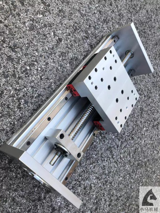

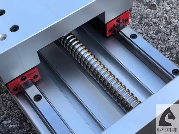

    Kim, I found some better pics of the generic z axis you are looking at:
