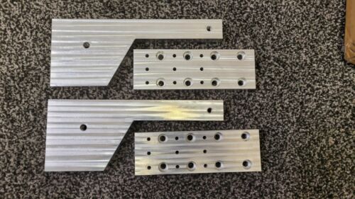

    A question I upgrade an Marchant Dice with an new solution I found this https://www.ebay.com/itm/265441061631 exactly what I was looking for. I Will have linear up on aluminium profile i think and use avid spring solution. So is anyone have an cad for avid gantry plate or this one. If
    I dont have experience to make an cad to make this or know if someone sell avid oen plates?
    Hej, är denna länk någon hjälp för informationen: https://www.avidcnc.com/support/inst...ard/downloads/
    Menar du en av plattorna på bilden nedan?
    Jag har inte cad men jag är säker på att vi kan hjälpa dig att lösa det?

    I only find dokument on avid site. They don’t sell there plates separately and the link with a even better idea on eBay he told me his plates was sold 10 minutes before I was supposed to buy them.
    Would be pleased if I can get an cad for plates or even better to buy them from someone here how can mill them.

    Hallå,
    Ok, du kanske kan fråga honom (ebay-killen) om han vill dela sina cad-designer med dig?
    Jag kan eventuellt göra tallrikar åt dig när du kan få en design, du kan göra på papper och så gör jag caden till dina ritningar, behöver du exakt den ivrig designen, kan du göra din egen?

    The seller dont answer me at all, so i will order new alumium profiles from Tuli and racks and drive from Avid CNC, then i can measure the size i want and where the hole should be located i dont know the fitting for avid drive where the spring hole and the bolt hole should be if someone else dont have it and can see.
    I have order http://shop.cncdrive.com/index.php?productID=1098 this control box and 8nm closed loop stepper motors from them, really hope its a good upgrade from my obsolete thing that was with the machine.
    Same time because of the Y and A axis profile 90X90 thats not 100% straight anymore my plan is to order.
    For Y and A axis 90X180mm profile standing to get higher gantry for Z 4000mm https://www.tuli-shop.com/alu-90x180
    But here i question you or someone else can answer if i use avid cnc drive and also there racks what is best solution for stability to have linear on top of alu profile and use the idea from ebay link on Y and A Axis or is it better to have the linear exactly as Avid CNC solution on the side gantrys togheter with the drive and rack on the alu plate? WIll use 1 HGR25 on each side.

    Quote Originally Posted by winzhangout View Post
    Ok so you are going to order the Avid CNC drive system, that's good we can make a CAD of the plates that way ?
    Absolutely go with linear rail on top of ali profile, not for stability but for an easy life when you need to make everything on the same plane and aligned perfect to each other, the side mount for linear rail is just harder and more time consuming to get really nicely setup. On top you will find it easier for alignment and more so making the adjustments for this work/ procedure.
    You know about linear rail alignment and setting up right?
    I would put the rack and drive mech on the side yes, it works well and keeps everything away from the chips and dust ect, you should factor a cover for this stuff maybe.
    but it should be a more stable solution to have it as i have it now and its it on the ebay link?
    Again, absolutely go with this ebay design (in the pic below), no design should ever have the gantry sides so that they are like "stilts", its just so obvious to look at, that it is a bad design!...then you see the designers try and make good and overcome the instability/rigidity by now putting extra plates, corner brackets and an effort to "brace" everything together etc...
    It is really quite disappointing to see, especially when you also see how popular the said machine becomes with the community...sure it works and you can cut some stuff but that doesn't make it right...
