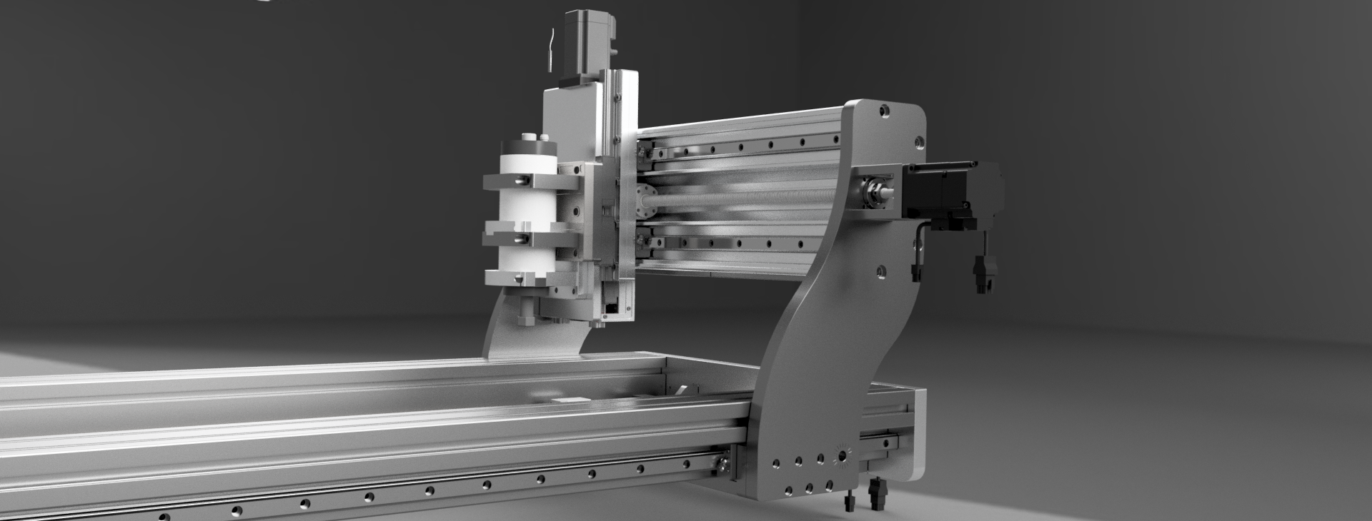

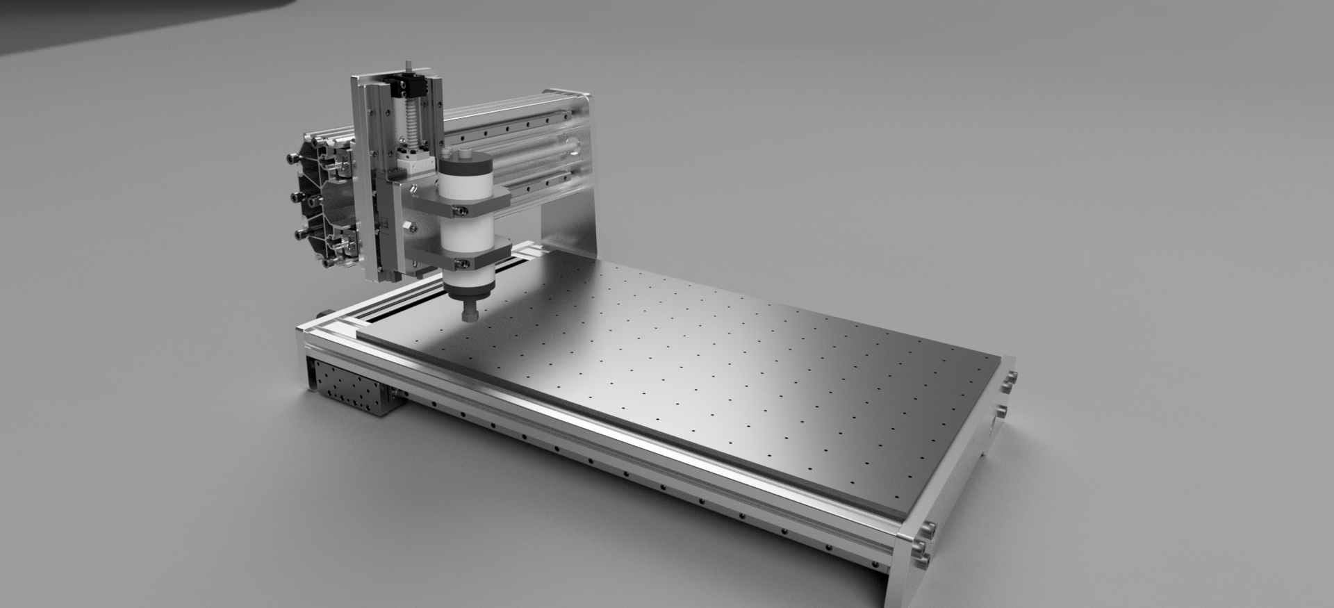

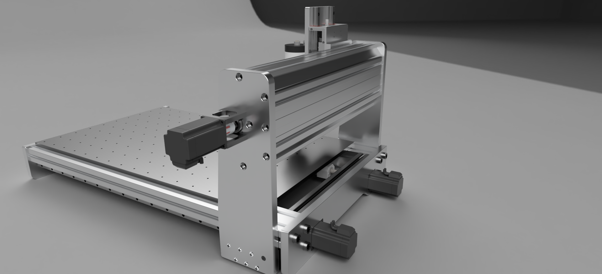

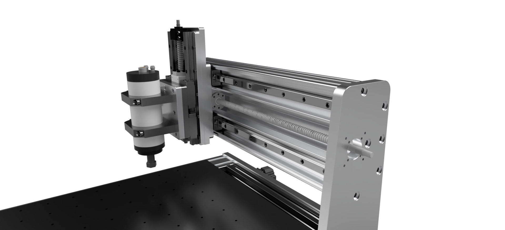

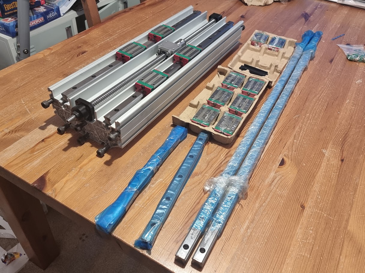

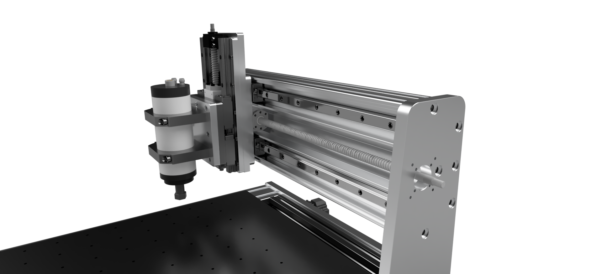

    So it's time my first machine is replaced, the design is almost complete with just a few things to finalise on the Z axis but parts for the finalised areas are starting to roll in. I've gone for a much more substantial design, Hiwin HGR20's on all axis, gantry features extrusion from Vallder, twin nuts on all C5 leadscrews and concrete in all hollow spaces for that extra strength and dampening. Still well away from the electrical side but either verging on delta for the drive system or hybrid stepper/servos.
    A few renders of the design as it's been developing with inspiration from ZeeFlyBoy on his wonderful El Beast design.

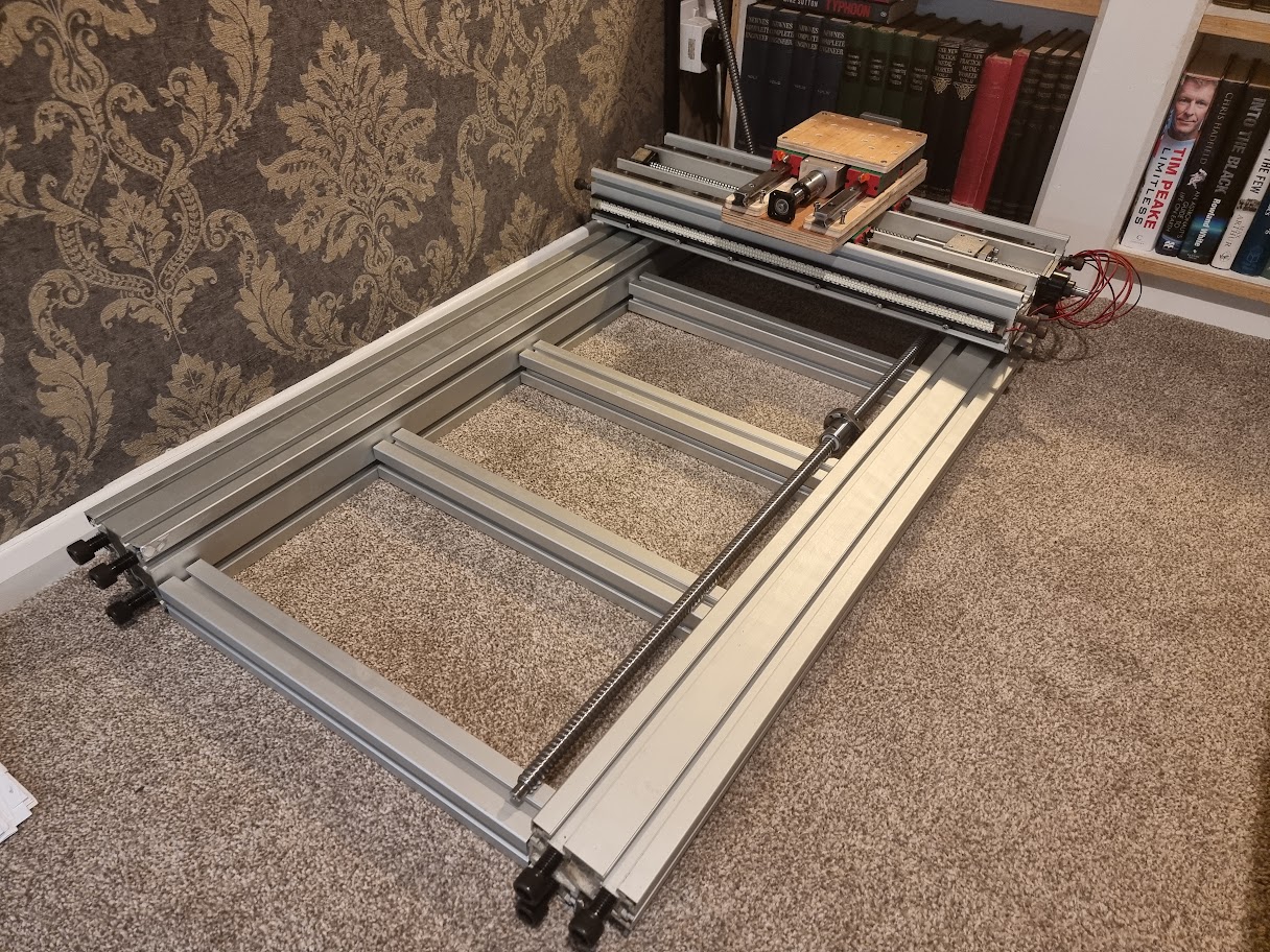

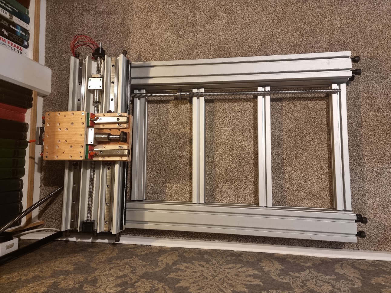

    This is where we are up to as of today, the rails finally arrived thanks to Fred at BST Automation for his usual super service and delivery in two days! Very happy with how its turning out and its certainly one heavy lump of money!

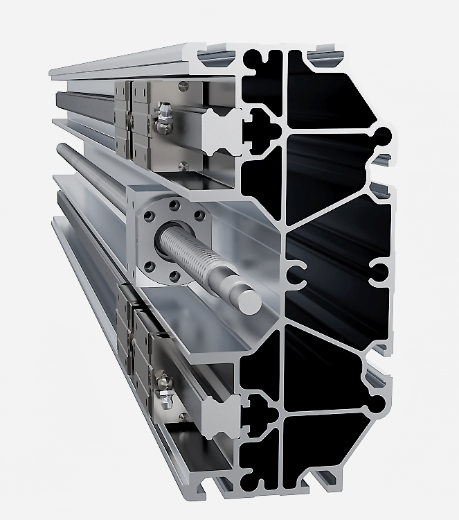

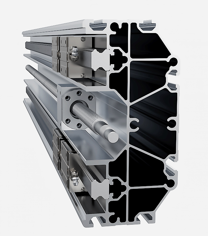

    I'll be particularly interested in how well that Vallder Gantry profile works out, although it's rather expensive.
    I imagine that if the linear rails are nicely parallel and co-planer, it should make that part of the build a doddle?
    https://vallder.com/en/c/alu-profile...-200x96-detail

    The Vallder stuff was recommended to me by some other builders and they rave about it, it takes 6 M12 bolts either side and fits the 20mm rails and screw superbly. Real easy to fill with the concrete, they where super easy to do business with too. I'd totally recommend them, the quality of it is really good.

    Yeah the vallder stuff is specifically for such application on gantries, they do have an X axis in production apparently but not yet released. So this type utilises 20mm rails and will take upto HG20 series carriages with 10mm t nuts.

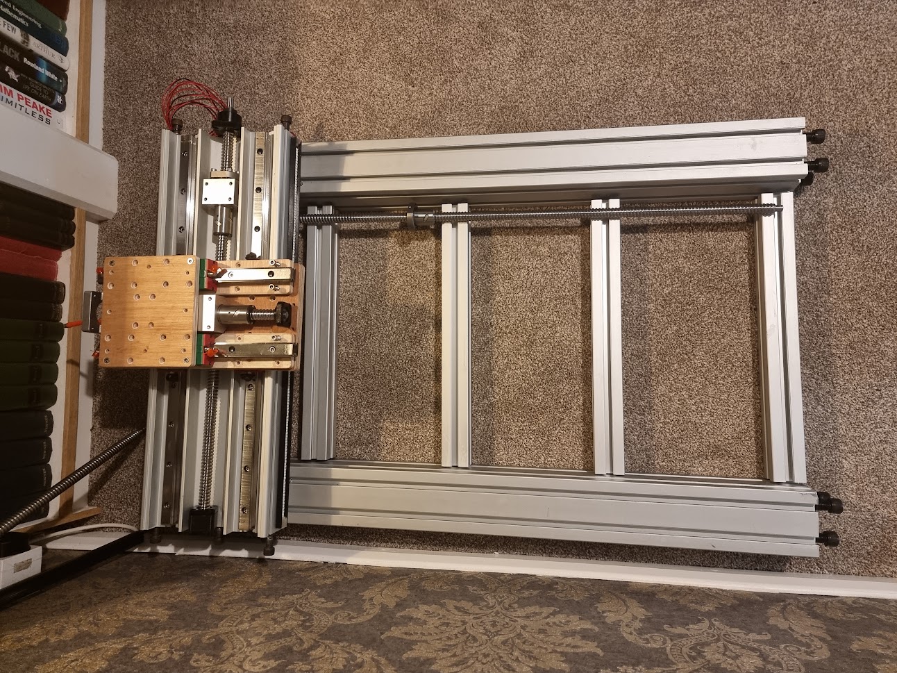

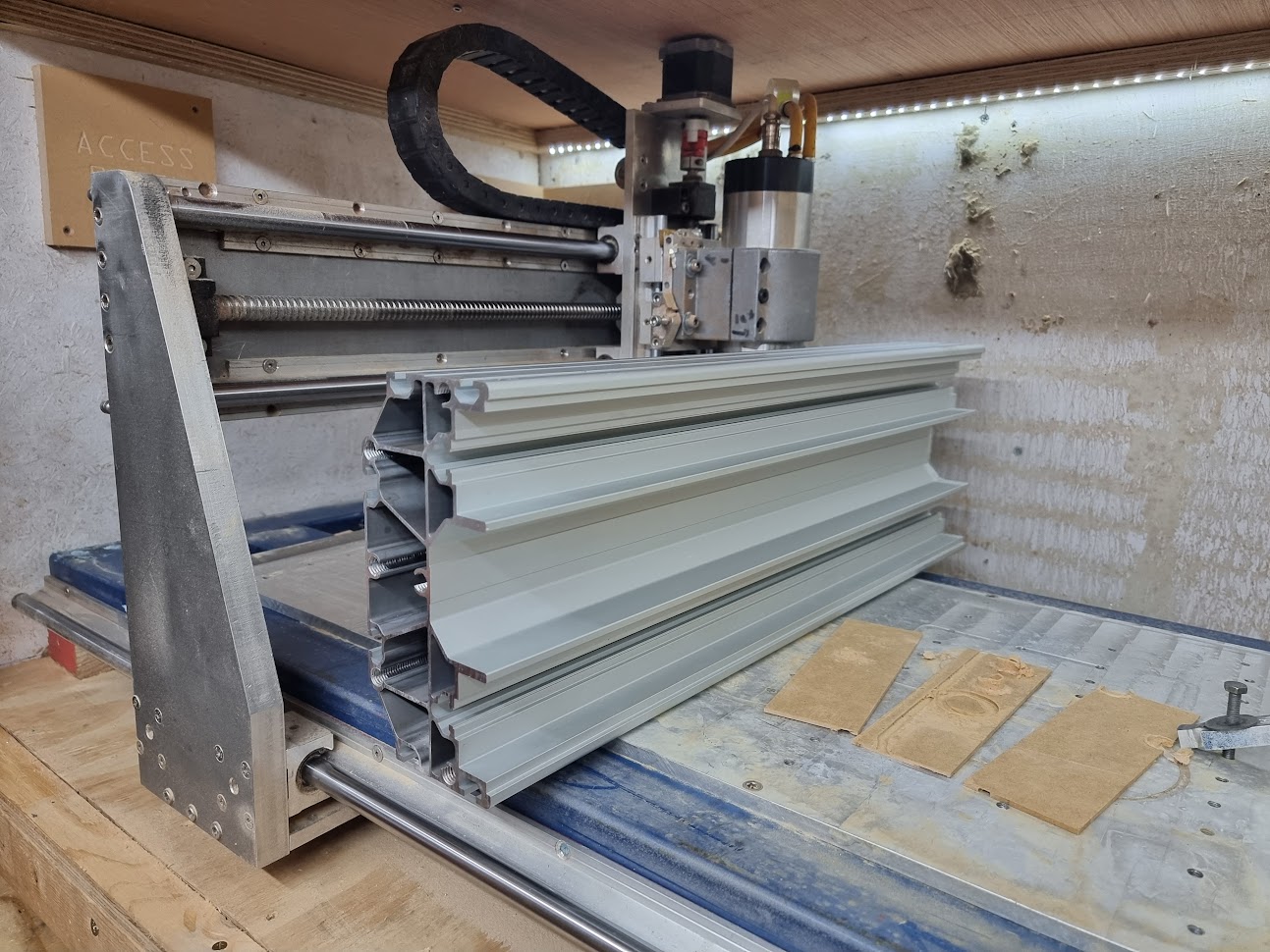

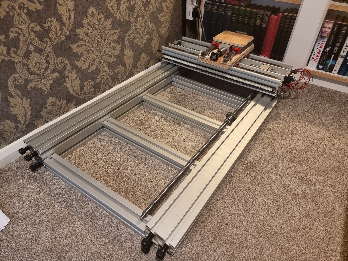

    The rest of the plates are being machined on my other that's being replaced by this one I made years ago, the build of this one is on here somewhere. You can see how substantially made the extrusion is and size.

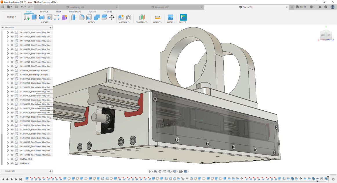

    The Z axis I've gone through two iterations and had so many people having their own input, this is the first one that was based on Zee's design a little but when looking at the deflection it proved to be poor and such went back to one I've settled on in the renders above. I'm able to get full travel with maximum travel with both as the travel is only 80mm for this design and I tend to only do plate work and not anything mounted in vices.

    Use epoxy granite instead of concrete maybe? Bulk epoxy isn't too expensive from some vendors. And do you have any figures for the stiffness/moments of inertia of that Vallder profile please? Looks like it does a neat job, but I'm going to need something seriously rigid for my next build....

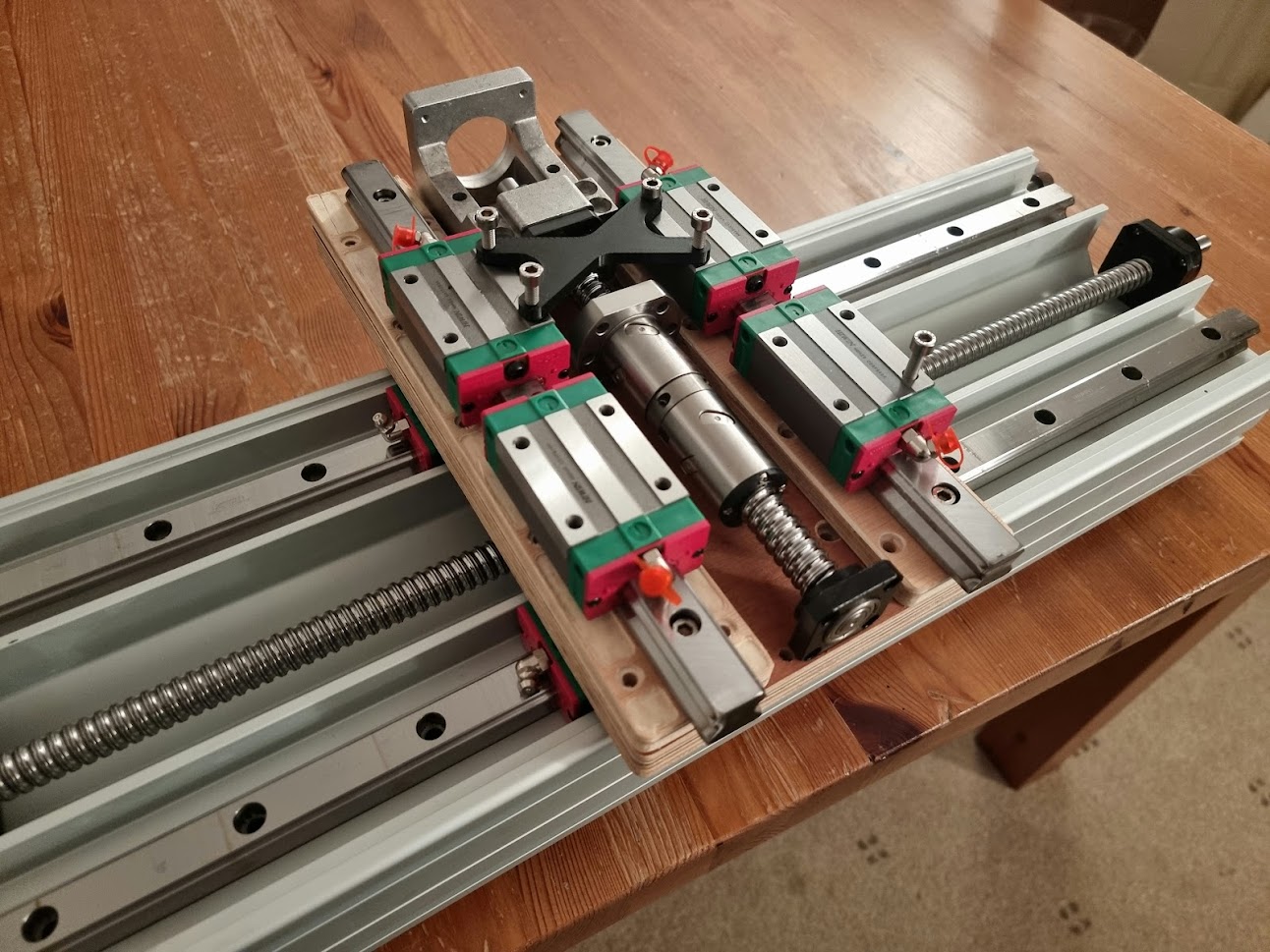

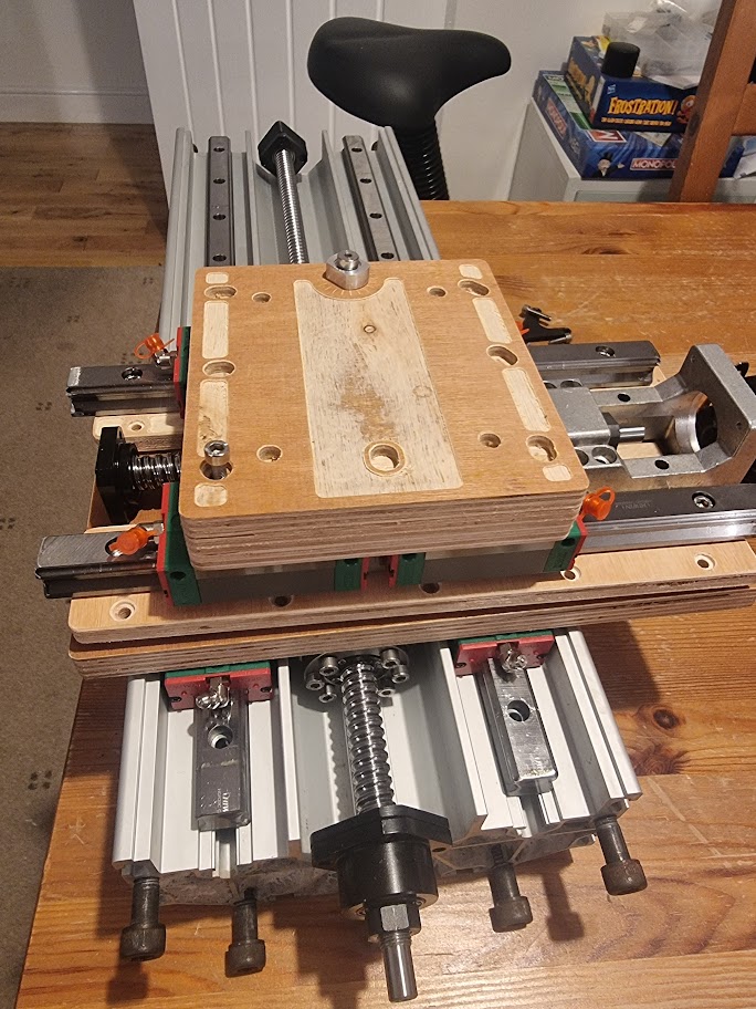

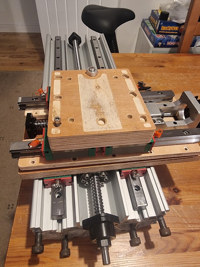

    Not much has happened since the last update, the rest of the extrusions finally came in and started with machining some mock up parts to ensure fit and functionality, found a few small issues thankfully here and now corrected them such as hole sizes incorrect and clearance.
    Made a decision on the motors and went for Delta B3's so looking forward to having these and the super performance they will bring along with the Mesa 7I96S card on linuxcnc. May yet further change the remaining ball screws out for DFU as they as SFU to match the performance of the others.
    Limit switches I've gone for sick sensors which use fibre optic cables instead of mechanical switches meaning I can get a much more compact design on the Z and Y where currently I do not have that option of space. https://www.sick.com/be/en/fiber-opt...f_Type:Product

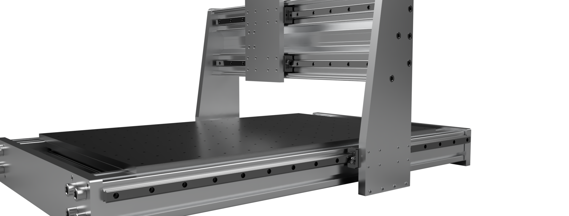

    After some pondering and some calculations I've made a change to the gantry as the current design wasn't ideal with the moment of the spindle to the gantry carriages, this new design reduces such and also looks kinda funky.
