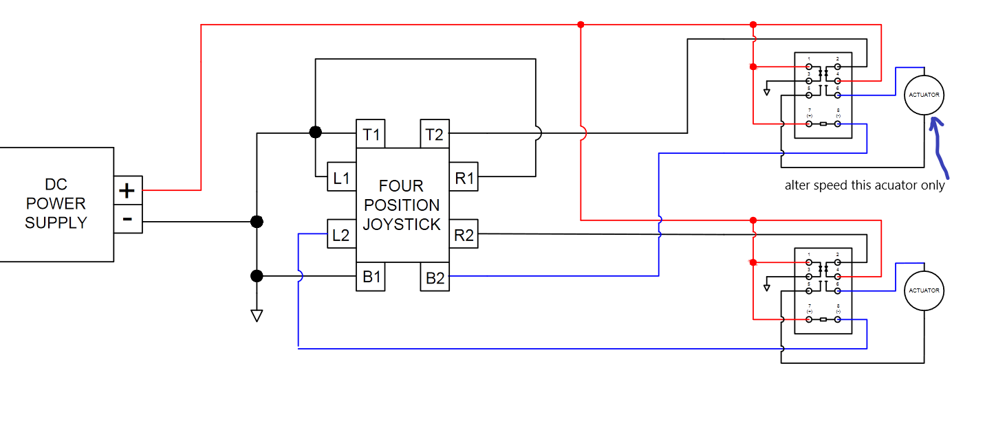

    Hi all
    I have 2 12v dc actuators connected to a 4 position joystick.
    i need to be able to control the speed of one actuator only. the other will run at full speed.Can you draw and or explain how i need to wire a 12v dc speed controller into this circuit. if i put in the motor out contacts it doesnt work because the power polarities change when the joystick is in a reverse position. Maybe have to run 2 complete circuits but how do i wire the joystick controller. thanks for any answers

    If the speed control is positive side speed controlled (motor ground goes to ground) then insert the speed control output to drive pins 1&4 of the upper relay.

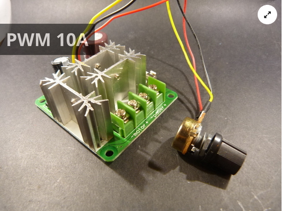

    this is the speed controller i got Click image for larger version.
Name:	Screenshot 2022-12-12 at 11-38-08 DC Motor Speed Controller PWM Motor Driver 6-90v 10A - Buy Onl.png
    so your comment between 1&4 is wrong?
    Quote Originally Posted by rjsutton View Post
    Apologies - I can't believe what rubbish I wrote. The intent was to remove a previous reply (hence the "ignore this post"), with a possible follow-on solution. But that was as clear as mud, I read that now.
    In any case, having looked at all similar images of similar PWM controllers, in each case the Bat-/Mot- and Bat+/Mot+ pins are non-common. Question: Are you comfortable that the joystick can handle the start-up current of the motor? As you've drawn the schematic you're depending upon that behaviour. If so, there might be options, but may include a couple of diodes (and if not, an additional relay). The main thought process I have is to provide the PWM output via the change-over relay potentially with a third relay to isolate the motor if neither direction is demanded. If you're prepared for a third relay I can sketch something.
    Hi Doddy
    if you can sketch circuit would be appreciated
    thanks
    Hi yes the joystick seems to handle the current at start no problems
    the schematic is just a downloaded one which i used to get the machine working.
    i can add relay etc as required. thanks for the help
    R
