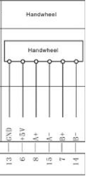

    Wanted to ask, is it possible to use rotary encoder instead of manual pulse generator? In the cnc controller's manual there is this scheme:
    Had anyone tried this? Or is it only possible to use mpg?
    Lives in East Lothian, United Kingdom. Last Activity: 3 Hours Ago Forum Superstar, has done so much to help others, they deserve a medal. Has a total post count of 2,984. Received thanks 369 times, giving thanks to others 9 times.
    An MPG is just a rotary encoder with notches for each pulse so you get some physical feedback from the notches as you turn it.
