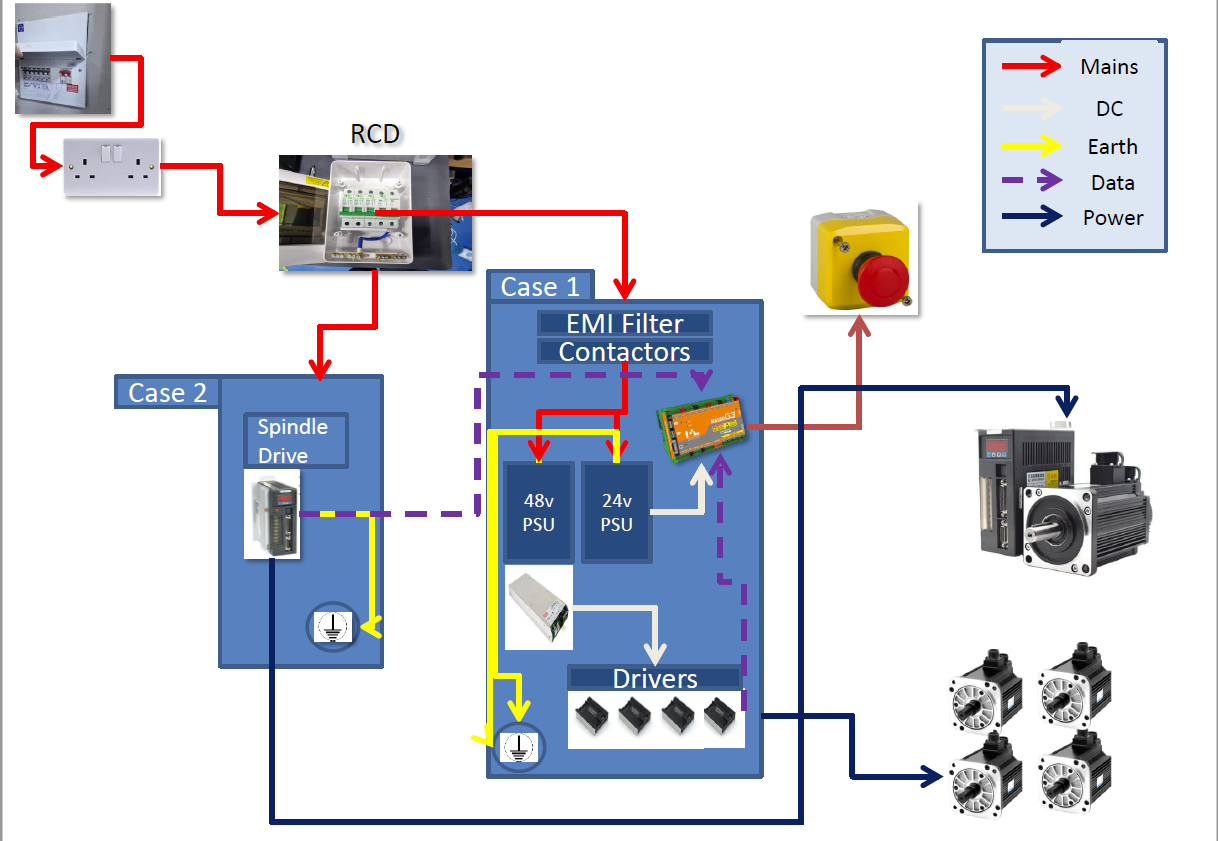

    Thank you for the reply, this is a rough diagram of what I am trying to do.
    Its taken ages to get this far, the socket will be removed and the mains will go to the RCD. Click image for larger version.
    The problem I was having was the DMM drives were taking too much with the spindle. So having contractors should be a good solution and is recommended by DMM.

    Lives in East Lothian, United Kingdom. Last Activity: 5 Hours Ago Forum Superstar, has done so much to help others, they deserve a medal. Has a total post count of 2,992. Received thanks 376 times, giving thanks to others 9 times.
    As you've already got 24VDC, I'd use that to control any contactors, and have the 24VDC PSU hardwired (via a fuse) to your main power switch.

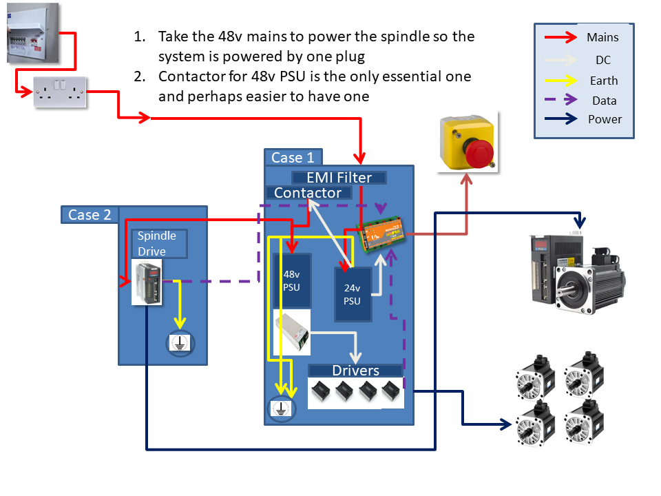

    Hello,
    I created this drawing - do you think this is a better way of doing this.
    I Don't want to get it wrong and zap myself, the components or set fire to the garage.
    It depends on what you're actually using the contactor for.
    If it's solely to control the main power, so you can use a smaller main switch, then it won't really matter what voltage controls it.
    However, if you're using it as part of the E-stop, it should really be 24V.
    You need to select a contactor with the correct coil voltage.
