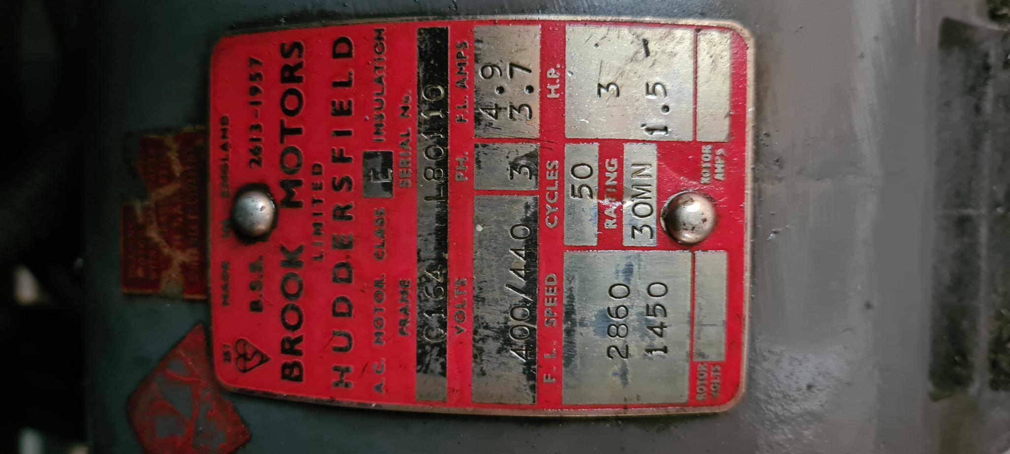

    i have a picture of the plate, what would you recommend
    That's a two speed motor which complicates things, but also means it's likely to only run on 380V.
    Dual voltage/dual speed motors are theoretically possible, but it involves switching 12 coils.
    Easiest option is a boost VFD. Have a search for them on Aliexpress.
    I personally use CNCWeiken ones - https://cnweiken.aliexpress.com/stor...516106264.html but there is another brand others on here have used however I can't remember the name.
    You'll want to eliminate any switching in the wiring between the VFD and motor.
