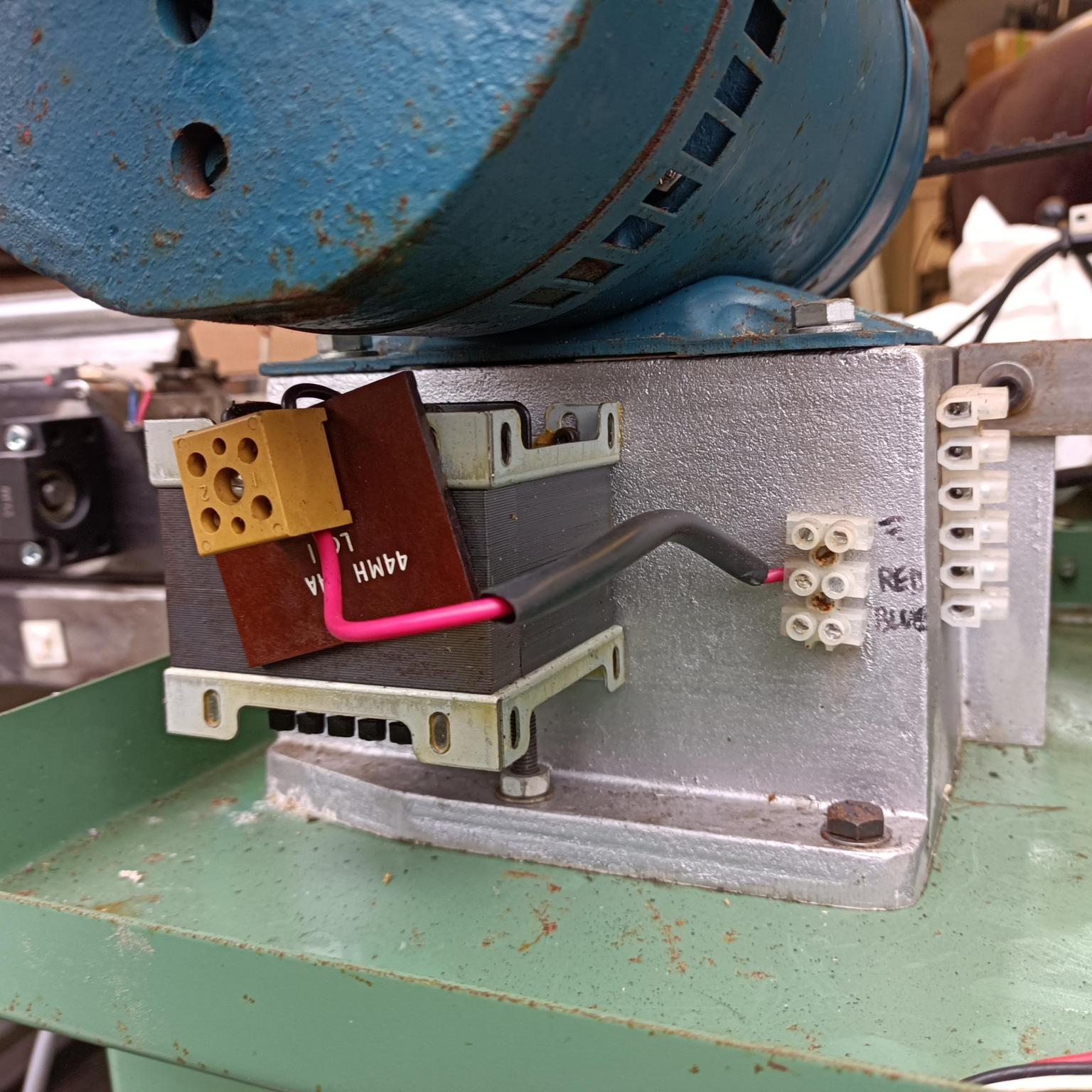

    No luck yet with the motor controller. It has 240v to it, I can measure 12v across pins 12 & 10. I attached a pot to 12 & 10 and 11 and can vary 11 between 0-12v but not seeing any output from the motor controller. Tried it with inh connected and disconnected. The motor turns if I attach a 12v supply directly to it. Is there any more I can try with the original motor controller? There is also a component attached below the motor - not sure hat this is...?

    That's a choke. They help smooth/suppress noise from the motor.
    It's worth checking it's not failed and gone open circuit (either with a multi-meter, or apply the 12V with the choke in circuit).
    Have you checked both fuses on the drive?
    It could be the Inhibit needs a certain voltage applied, but without a manual, or being able to work out what the wire gets connected to and fed, it's pretty much guess work.

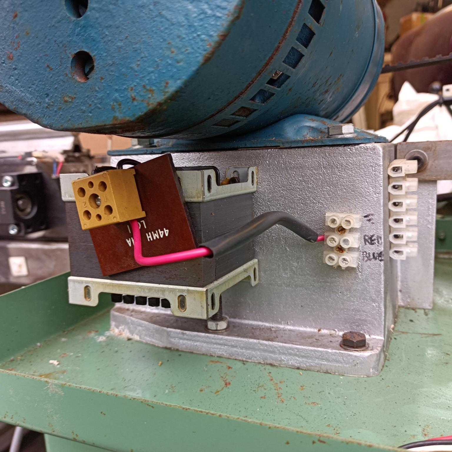

    How would that choke be wired? Is it in series like a resistor? It's not wired up at the moment.Click image for larger version.

    It should be in series with the motor.
    The fact it's been disconnected would indicate there's been a problem.
