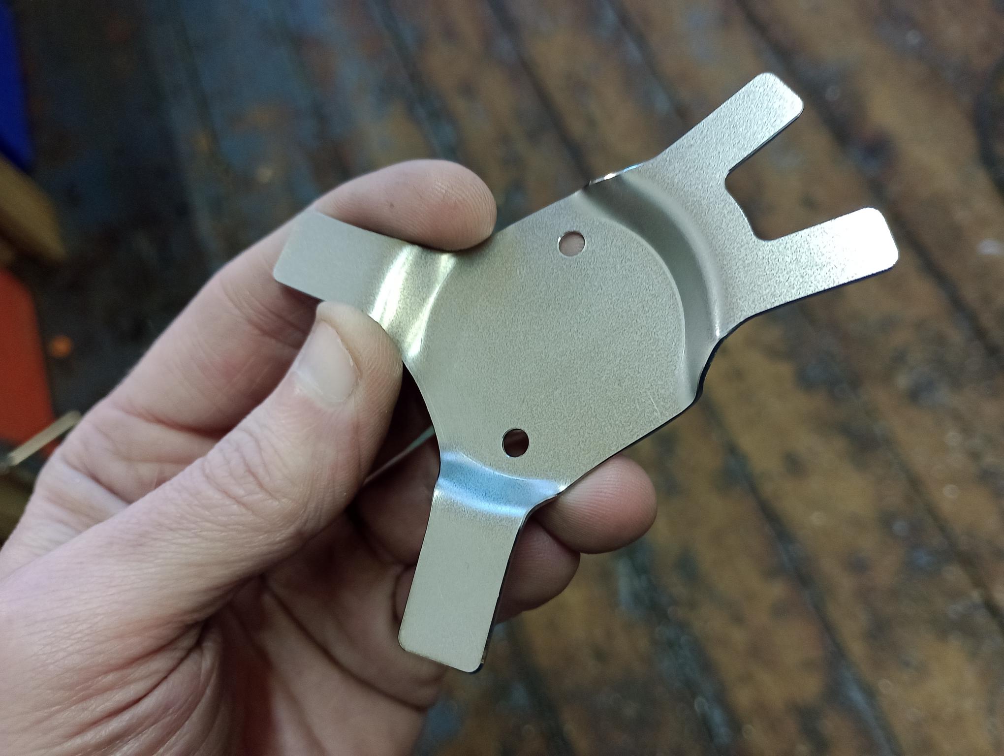

    Thought I'd ask the hive mind in case anyone has a quick answer.
    I'm after a small quantity of thin medium carbon steel in sheet (0.5/0.7mm) that I'd like to press form and harden/temper for a bit of spring. Trouble is I only need a bit (let's say 20 pieces 80x85) - short of getting lucky with offcuts, anyone know where I can source small quantities of CS70 / EN8 etc?

    Many thanks!
    Wal.

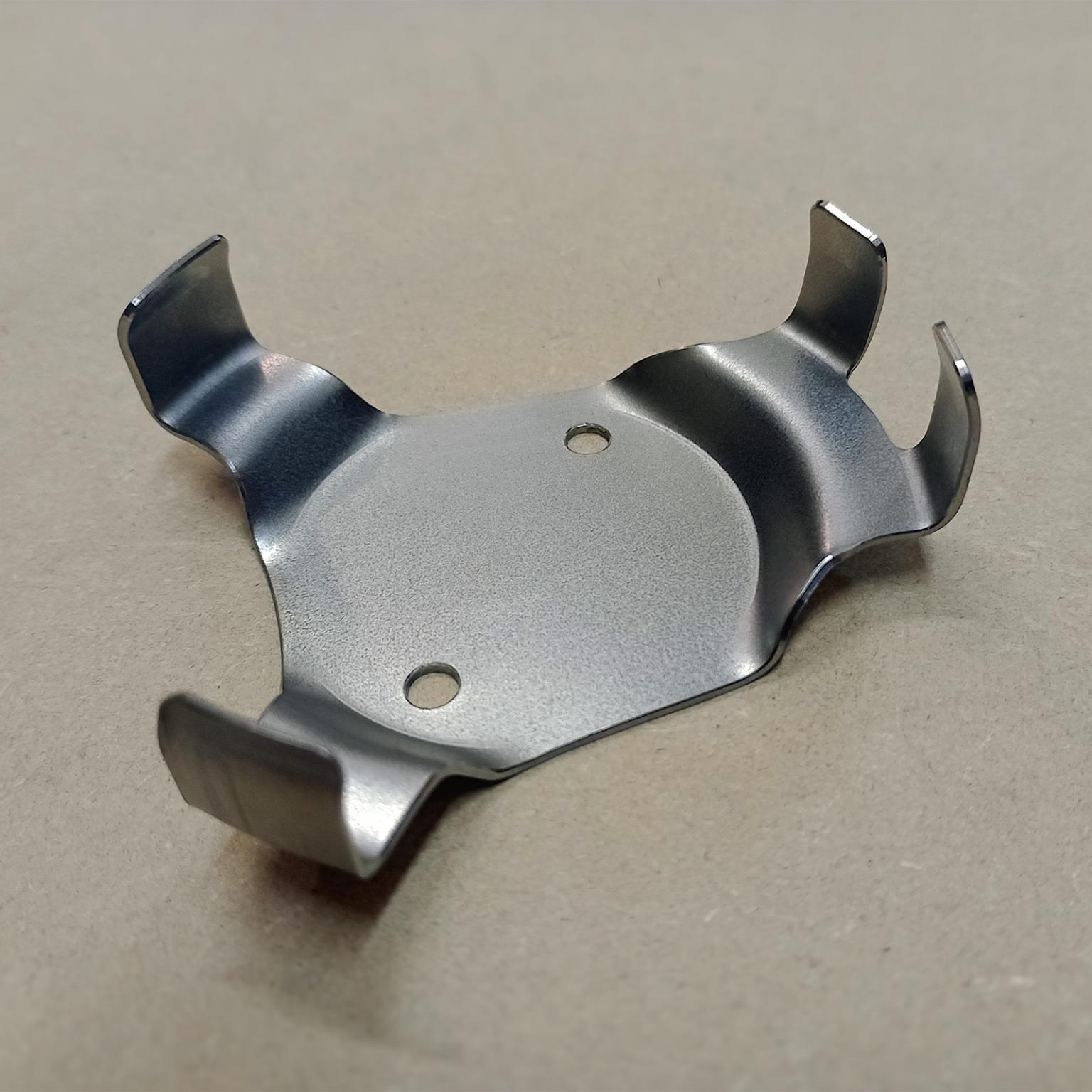

    Had a dig through one of my drawers and found some old 0.5mm shim-stock (304 stainless). It's pretty springy and looks like it might do the job without the need for any heat treatment - provided I can cut it and that it responds well to the hand-tools I've made to form it.
    This is how the clip looks fully formed - the secondary ops to bend the arms don't need much force, just hoping that the big bowl in the middle forms as well as it has in the generic 1mm thick CR4 used for the tests.
