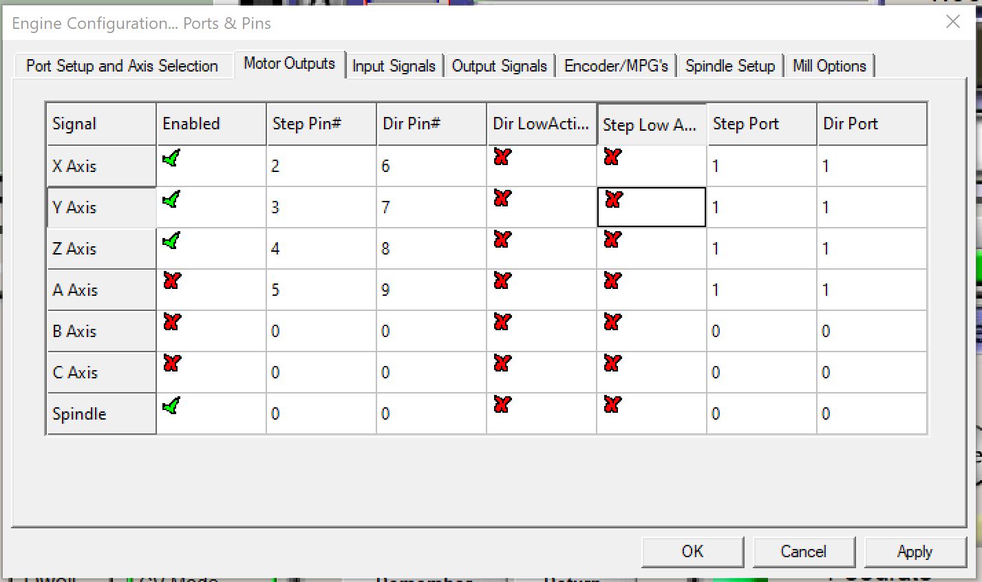

    Have you checked the ports&pins configuration, and what is set for the Y axis there?
    Especially in the "Dir Low Active" column?

    I have checked ports and pins it is 8/9 and there seem ok.
