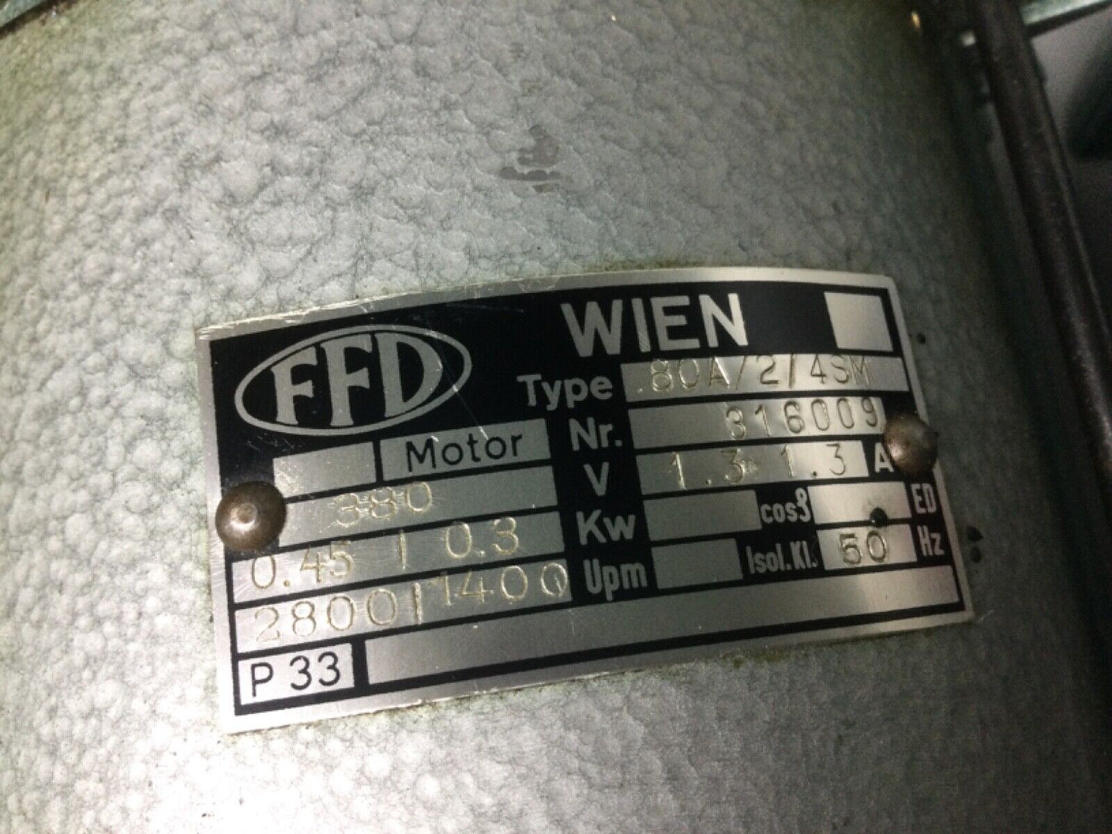

    Motor info
    Type 80A/2/4SM
    380V /1.3 /1.3 A
    0.45 /0.3 Kw
    2800/1400 rpm
    50Hz

    From the plate this seems to be a 2 speed motor, that is, wound as a 4 pole but the windings switchable to run as 2 pole at double the speed (i.e. 1400 & 2800 rpm). If the star point is accessible you could change it from star (380v) to delta (230v) running, though I think that's a bit trickier with a 2-speed motor. You could also run it from a lower voltage 230v inverter anyway, it will run at whatever speed is selected but just give a bit less power. Apparently if you actually reduce the speed to about 30Hz you can get the same power. Inverter Drive Supermarket sell drives, possibly 230v in 380v out ones, and they also have a note on their website about running at lower speed. Find them with Google.

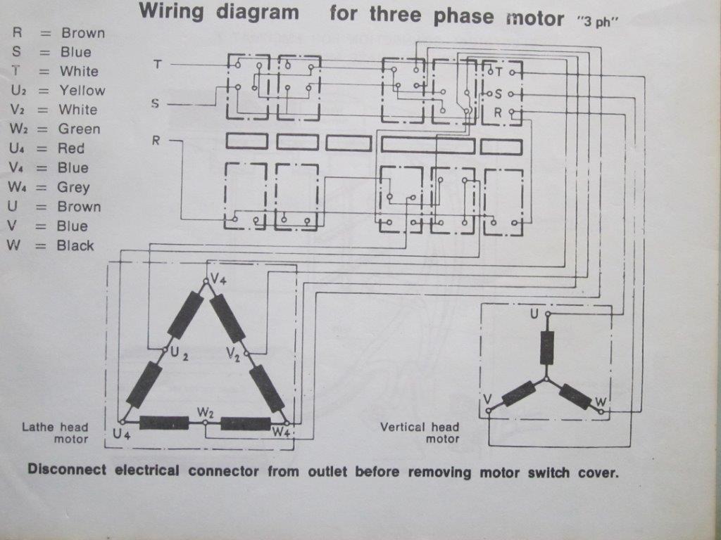

    Thanks for your prompt reply. Yes it is 2 speed done with a mechanical switch. manual shows single phase and three phase link up. is that delta config.
    Have attached a copy of the 3 phase wiring that i got when i first bought the lathe, the recently purchased motor is Emco specific but don't know if it's same as shown in the circuit diagram.
    will check out your link, What size (Kw) would be required?
    will try and get a photo of the wire colours on the 3 Phase motor if that helps.

    Bizarrely the lathe motor has delta windings and the mill head star!

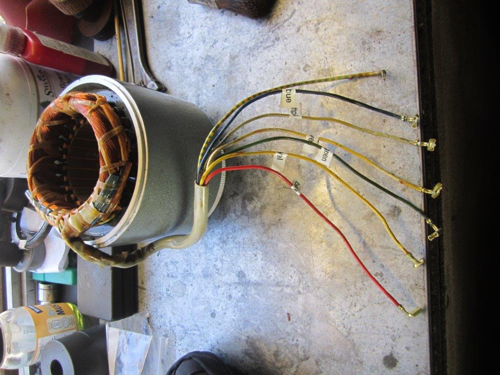

    But the real question is what the winding config is on your new motor. Is there a connection cover you can remove and get a photo of it? If it can be easily converted to delta then the neutral, the place where all the windings are connected at one end at the centre, would be accessible at screw terminals and/or have links.
    The rating plate says it's 0.45kW 2-pole (2800 rpm) and 0.3kW 4-pole (1400 rpm) so a VFD rated at 750W (0.75kW) should be fine.

    as you can see no terminal connections.
    any ideas on how you would connect to the VFD ?
    MC if you get time could you possibly send a picture me of your control system, no rush i still have to fathom a mounting arrangement fot the motor, it doesn't have the usual flange mount.
    Mike
