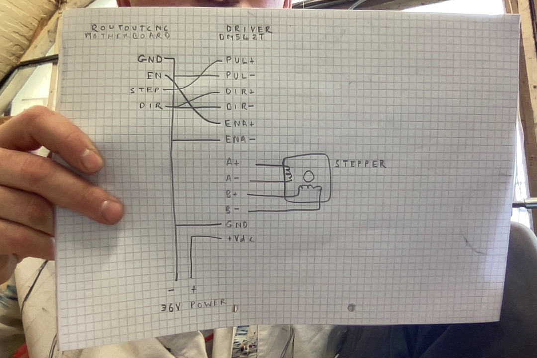

    Hi John, I’ve wired everything up but the stepper only moves in one direction. The BoB remains unchanged, the pulse/rev matches the BoB at 1600, stepper current is just under the stepper’s rated current, and logic voltage is 5v. Any ideas? Thanks

    In case it is to do with the DIR circuit, when jogging in the direction that does work (-X), the DIR pin is reading 5Vdc on my multimeter. When I jog in the other direction, which doesn’t move the stepper at all, I’m getting a reading of 45mV.
    If you can in the controller (Mach3? ) try changing the sense of the step pulses in configuration.

    Figured it out - In Mach3 config > Port and Pins I had to tick Step Low Active... At that point the stepper was running at normal speed in one direction and really slowly in the other direction. Then realised I had incorrectly wired a ground needed by the routoutcnc motherboard (BoB). The motherboard has two GND pins and I was grounding one only (the wrong one). I switched it to the other GND and everything started working.
    Thanks again for your help :)
    This is a Routout cnc motherboard V2.1 and a Stepperonline DM542T driver and CNC4YOU 1.5Nm Nema23, on a Denford Novamill running Mach3 via a UC100 motion controller. I am using a stepper online 36V 400W power supply. The routout cnc motherboard is still powering the Y and Z axes - the new setup is currently for the X axis only.
