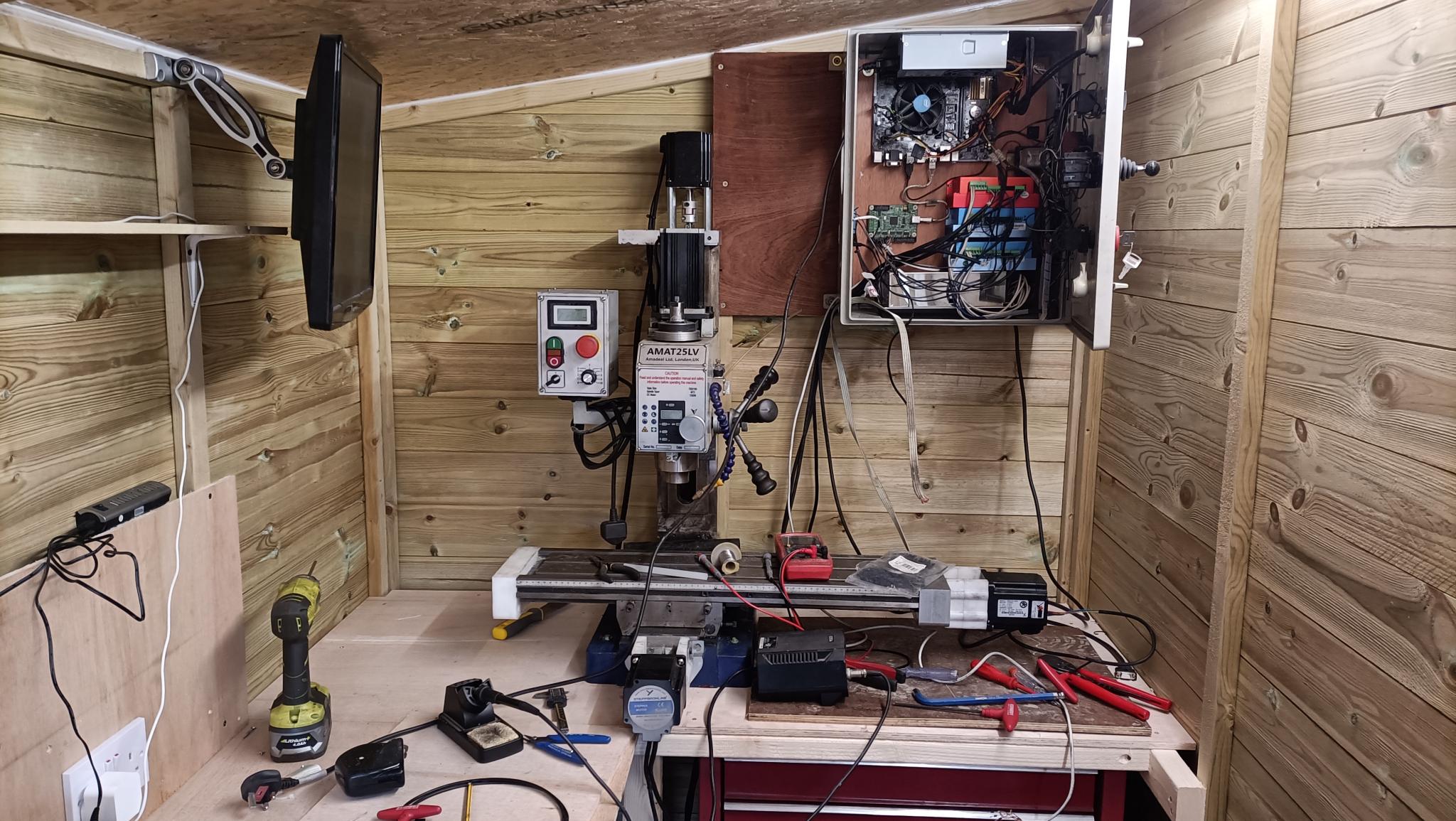

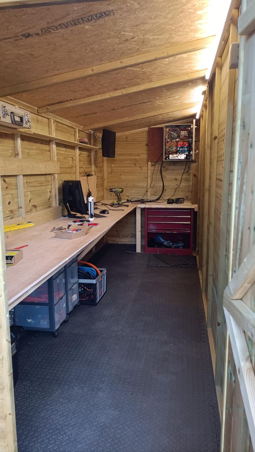

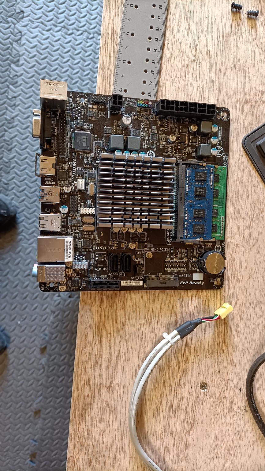

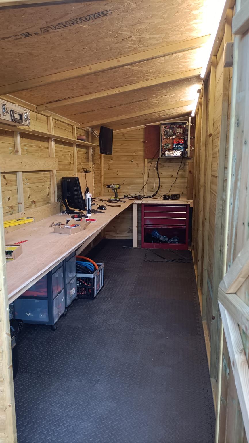

    The missus has allowed me another small sliver of her garden so I've built a new shed and moved my AMAT25lv into it to make space in my garage
    Since I had to strip it all down to move it I also decided to do some upgrades which I've had the parts for for the last 18 mth's but have been putting off

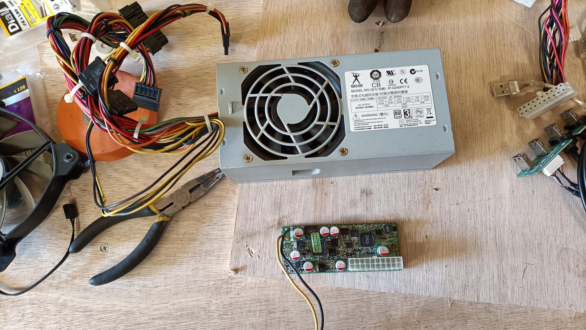

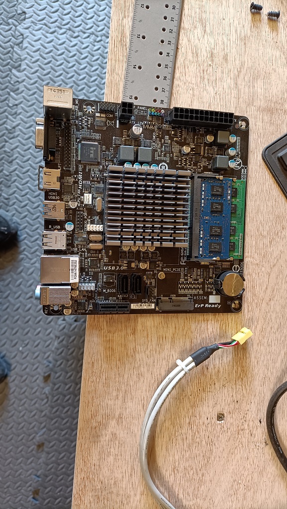

    so I've swapped out this somewhat asmatic dual core board with 8 mb ram and a conventional hard drive

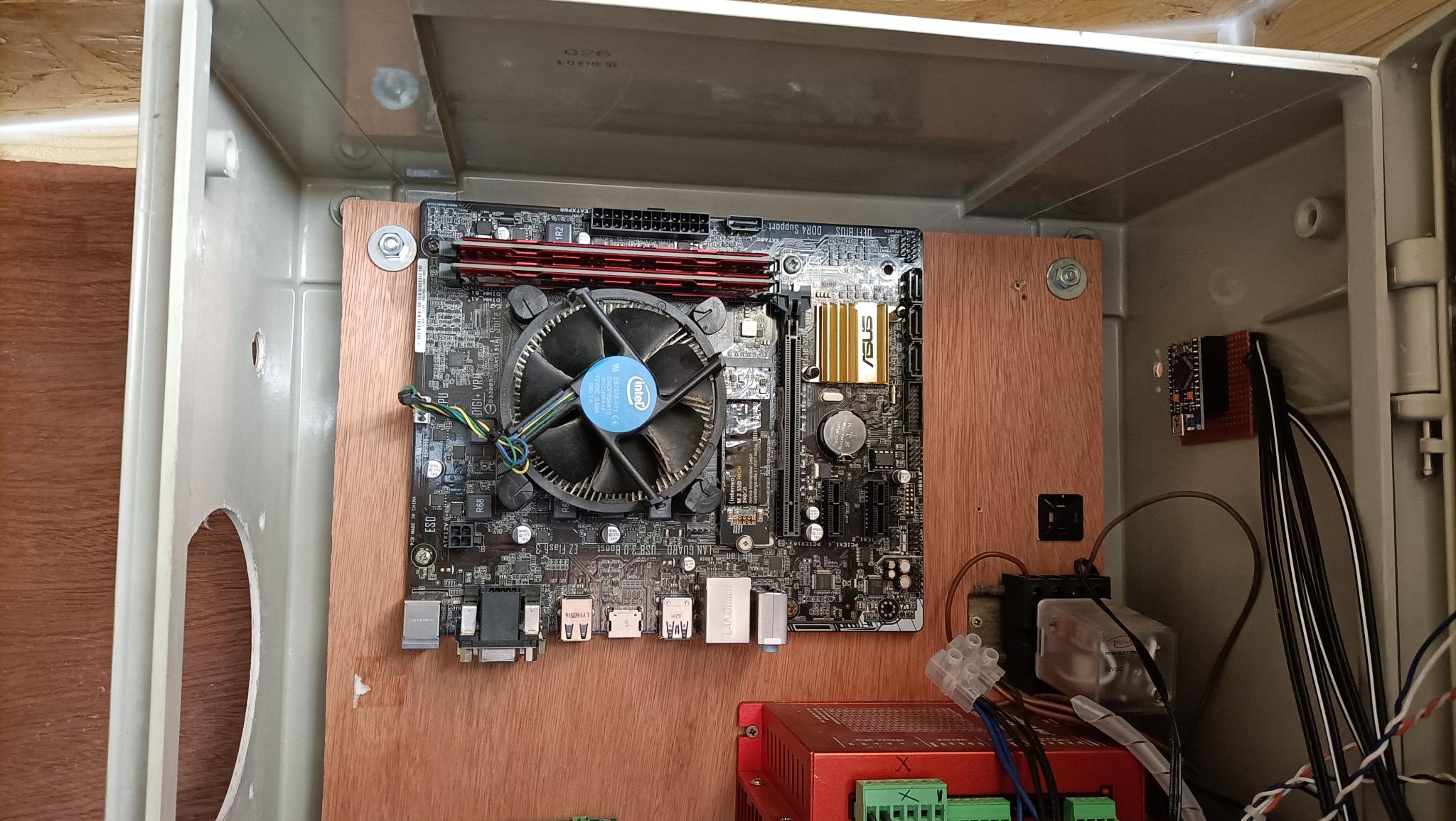

    for this spritely I5 with 32gb ram and an ssd

    Also had to upgrade the power supply the old one (at the bottom) was tiny and totally inadequate the new one is borderline

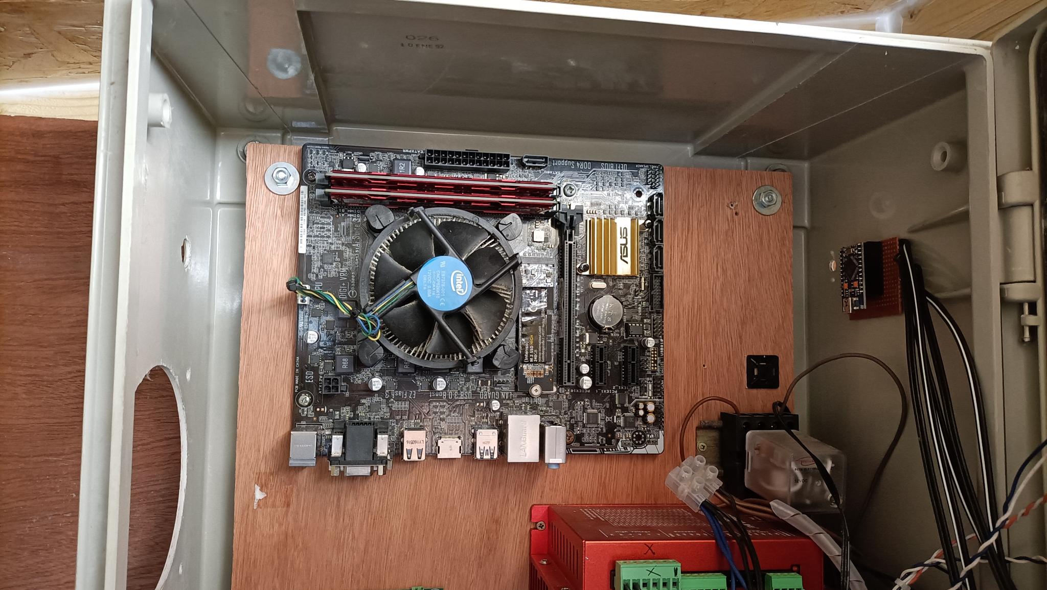

    hope to get it all rebuilt and working tomorrow

    Cool, but I'd isolate the shed otherwise, at least here, it would be useless most of the time. Too hot during summer and too cold during the winter season.
    Nice usable space it looks to me :) !
    Yes I think some 25mm celotex could be helpful as mentioned by camera...
    Nothing less than 95mm for me... That is, walls minimum 95mm, roof minimum 200mm. But not everyone have the same needs as I have.
