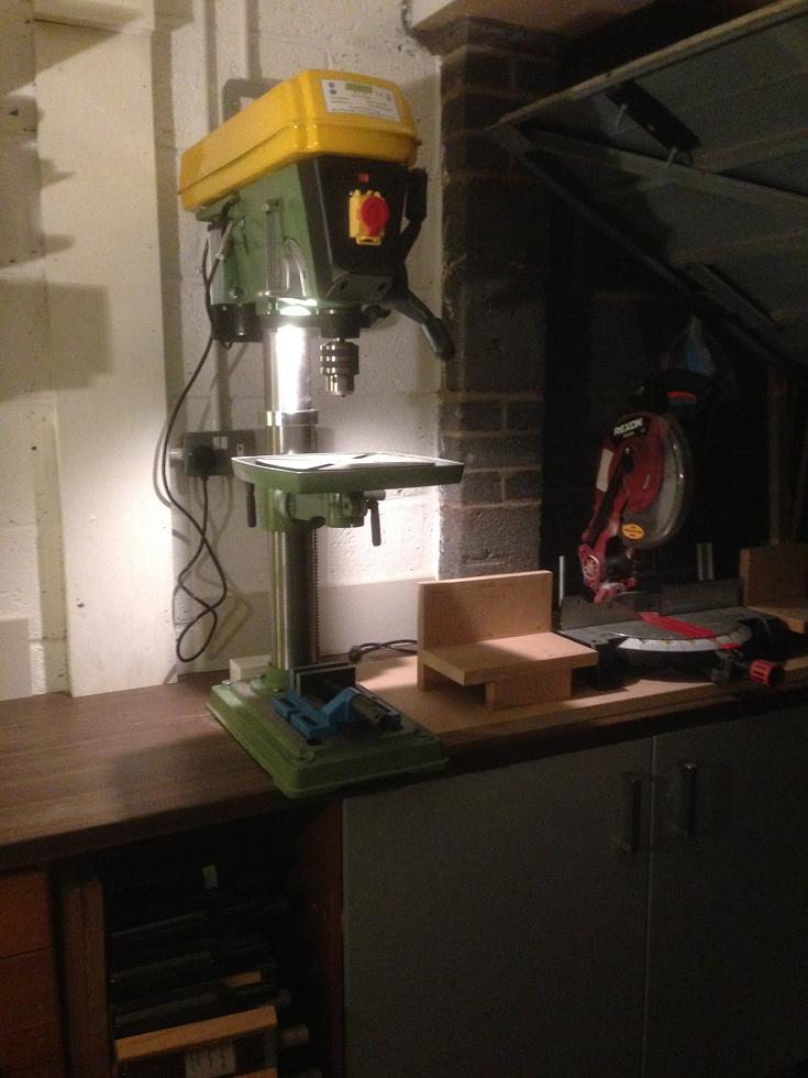

    To follow up on my original post – I bought the Warco 2B12 pillar drill in the end and have been using it for a couple of months now.
    http://www.warco.co.uk/drilling-mach...g-machine.html
    Here is a short review:
    I must say just how impressed I am with it and wouldn’t hesitate to recommend it for DIY or light trade use. It is really sturdily built with a great spec for the price. The castings are reassuringly thick and heavy.
    I compared this to similar drills from Axminster and other places and couldn’t match it for price / specification such as the 80mm column (many have 70mm) and 16mm chuck (some have 13mm).
    First off the assembly really does need 2 people. The motor head unit is VERY heavy and lifting it onto the column on your own is very difficult. As I was on my own that day I opted for a different approach which was to lay the column down on the workbench (horizontally) with the column hanging off the end and pointing towards me. I was then able to slide the motor unit onto it and tilt the whole assembly upwards into the vertical position. Again I wouldn’t recommend single person assembly as it was all a bit perilous!
    After fitting the table, tightening the belts and so on I fired up the motor and found it pleasantly quiet. Then it started hesitating and cutting in and out. Turned out that the pulley cover lid was not fully home – you have to push it down quite hard to engage the safety cut out switch in the lid. Then it was running sweetly again. Finally I fitted the chuck making sure that the arbour was fully de-greased.
    I wiped over any exposed metal parts with duck oil, greased the table lifting rack and bolted the base to my work top. Be aware that even with the drill pushed to the back of a 600mm deep worktop, with the motor unit almost touching the wall, it still overhung the front by about 30mm. I’ll add a small extension to the worktop.
    Changing the belts is a fairly straightforward task although I need to use a step ladder to reach. I may replace the screw holding the cover on to something with a thumb wheel then the whole process will be tool-less.
    After using the drill for a bit I noticed what appeared to be excessive run-out on the chuck. After a call to Warco they assured me the one of the reasons they sell this unit is that the chuck is good. So I measured the run-out on the arbour (chuck removed) and found it was about 0.05-0.07mm. Pretty good for a pillar drill. I then re-fitted the chuck and put a small round bar in the jaws and measured around 0.1mm, which again I was happy with. A bit confused I then rolled the drills along a flat surface and found that they were pretty bent! The drills were a brand new (but cheap) set from ArcEuro. I then chucked up my trusted 4.2mm tapping drill from Tracy Tools and switched on the drill. The tip ran true to the eye so I went on the Tracy Tools website over Christmas and ordered what I’m hoping is a quality set of drill bits.
    But even with bent drills this makes light work of drilling holes in 20mm aluminium plate.
    I also bought a set of reduced shank drills up to 25mm. I’ve yet to use them but don’t expect any power related problems based on current experience.
    I've bought a 100mm digital read-out which I intend to hook up to the quill to make accurate counter-bores for recessing cap heads etc. I’ve got some rough ideas about how best to do it in terms of brackets etc but don’t have time for that project just yet. If anyone has done something similar I’d be interested.
    I also plan to make a wooden drilling table, mounted to the main table, with an adjustable back fence to make woodworking jobs a bit easier. Something like this:
    http://www.axminster.co.uk/axminster...FVDHtAodgE0AAg
    In summary a great pillar drill and well worth £295 including VAT and delivery.

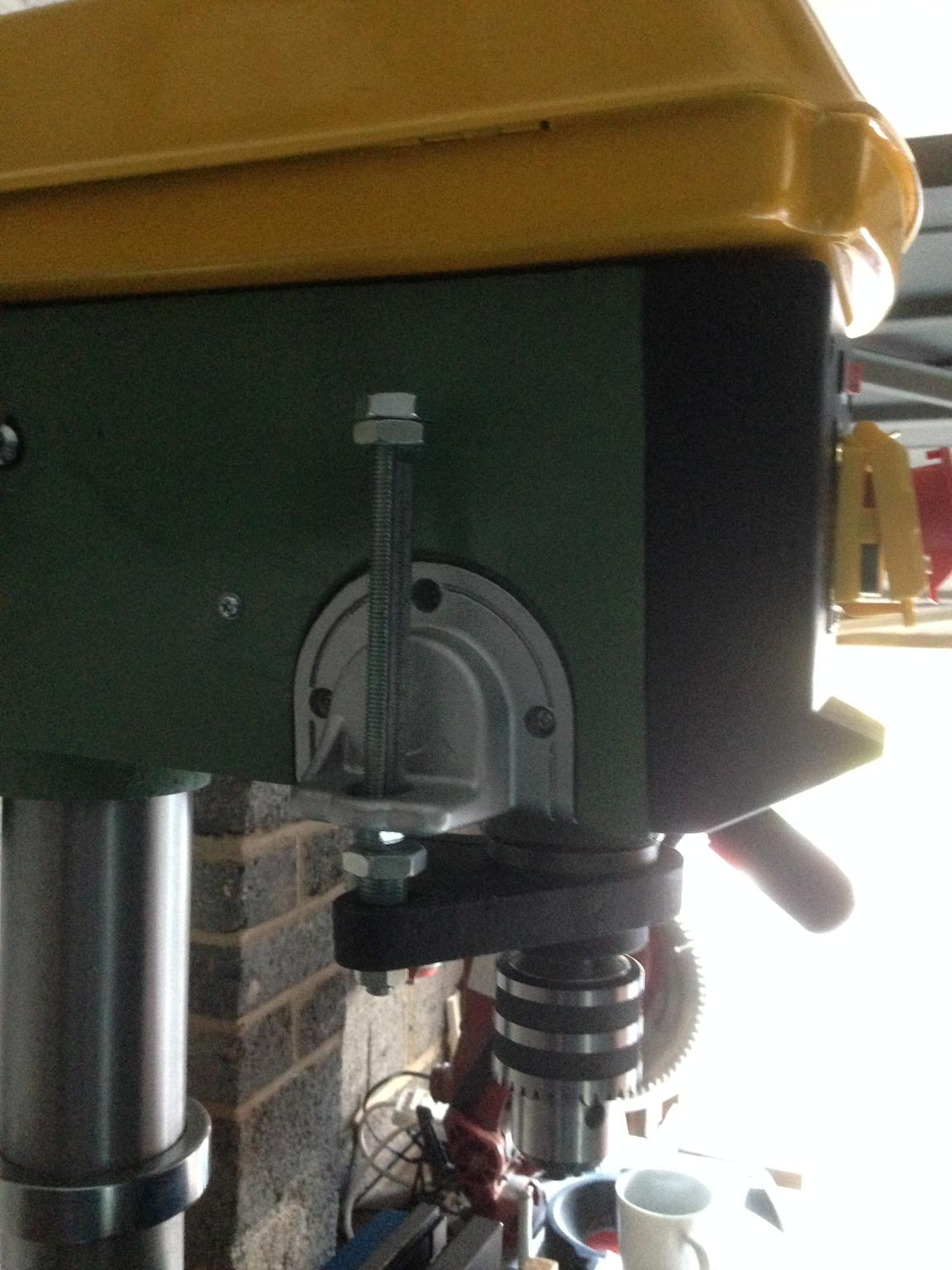

    I'm thinking about adding a few features to my pillar drill - DRO, quill hold, better depth stop. I've got some ideas to make a nice package on the left side of the machine but before I do can anyone tell me if I take off the aluminium depth stop held on by 3 bolts will the spring and/or bearing fly out never to be put back?
    The instruction sheet that came with the drill shows a fairly poor photocopy of the internals.
    That's where the spring usually lives so it's likely it will make a bid for freedom if you take the housing off ;-)
    - Nick
    Yeah, mines not been the same since taking it off, not even sure why I took it off now...gave up trying to get it back to where it was before ;)
