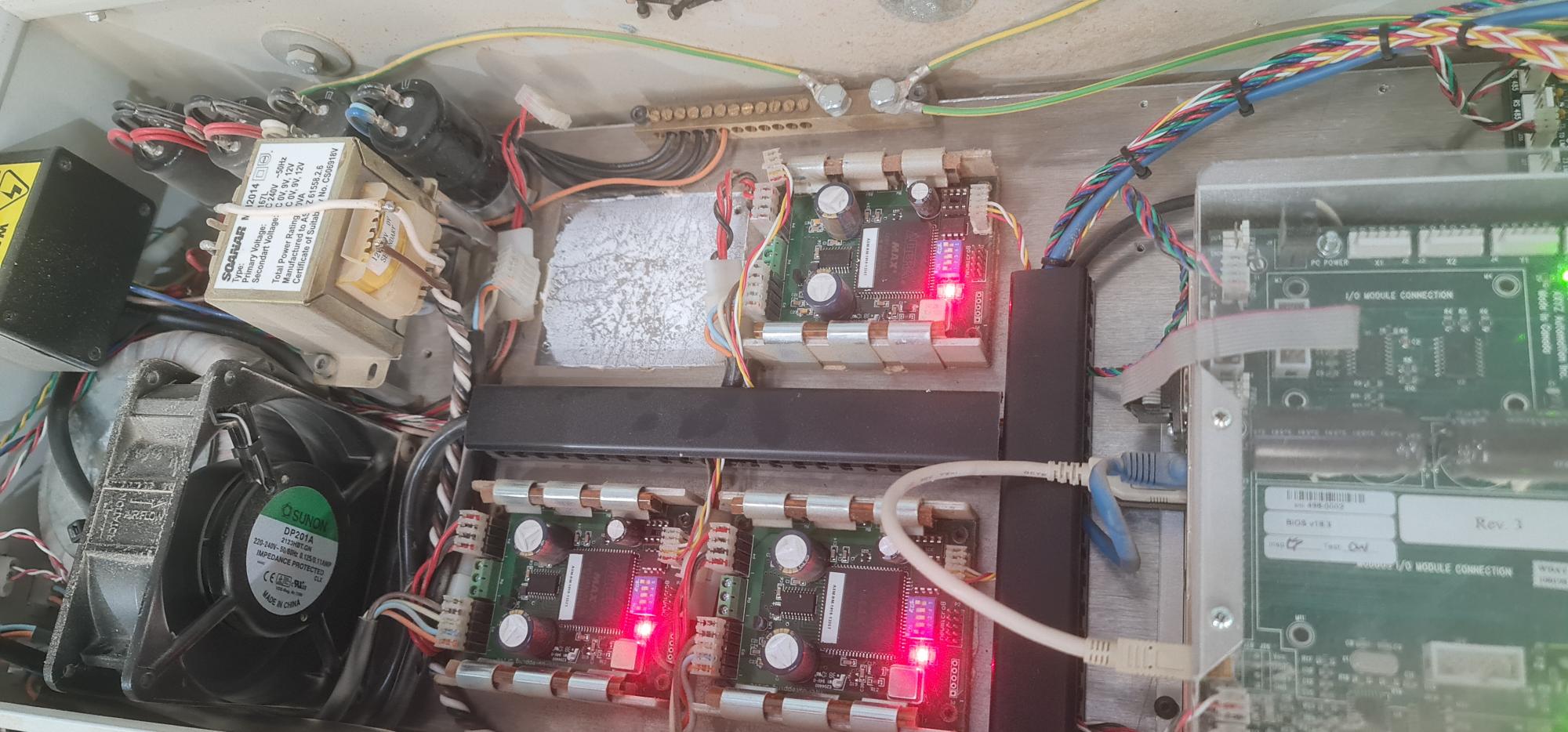

I have a 2010 AXYZ A2MC controller in my machine in Australia.
The machine is made by multicam Australia and is a S2512V with a pneumatic front rack tool changer.
the problem I have is that I am trying to replace a faulty Z axis driver. (multicam sells these for $3200 the generic driver is $78)
I have the driver wired up correctly but the controller board will not operate the motor through the generic driver.
I have swapped a genuine multicam X axis driver into the Z axis to test the other parts (motor and wiring) and it works perfectly with the genuine driver.
The replacement generic driver i have for the machine has the correct input voltage range for the input 45v DC, the A+A- and B+B- are wired up correctly, as are the -pul to step on the main board and Dir from the board to the dir- on the driver. the 5v feeds the driver pul+ and dir+. the driver show no errors and when the machine boots up there is holding torque on the motor.
I believe the controller must have a setting that needs to be adjusted to suit the driver step settings ? but I cant get at any of the installation settings.
I purchased and downloaded the configuration manager from A2MC but it comes up that I have version 5.30 and need to upgrade to 6.32 but them fails to update.
any help will be greatly appreciated.

id like to keep the machine original with the AXYZ computer,
but it may be that my only option is to replace with another control system.
