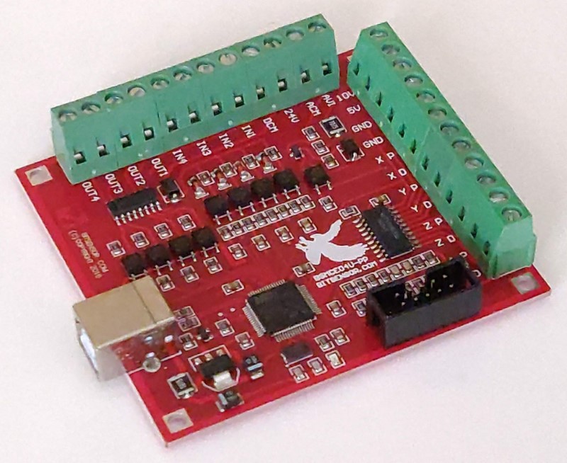

    I have my limit switches working but when i hit home on any axis nothing moves what have I missed

    Hi I am using a Mach3 USB Interface Board and Mach 3 Sheen set 2010 to run it. I dont seem to have any power to any axis when press home. what have I missed?
