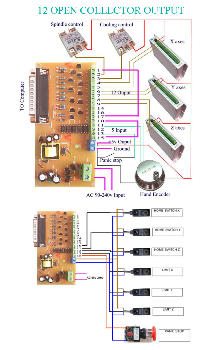

    Below is two methods of wiring limit, home and kill switches. By utilizing a series wiring of normally closed limit switches, when one switch opens it sends a signal to the computer to stop issuing step pulses to the axis drive motors. In parallel, you have to use normally open switches to sense a switch activation. The top drawing utilizes independent normally closed switches for a home for each of 3 axis and is more compatible with MACH3. The bottom is another method to do home switches.
    Utilizing normally closed switches is more noise immune, and thus reduces the risk of false switch actuation. The other noise benefit from utilizing NC contacts is coupling noise back into circuits and wiring for step/direction motor controllers.

    Hello Lee - I have just seen your wiring diagram and thought you might have a view on the following
    I have just started getting the equipment together to add limit/home switches to my machine, and have found the following diagrams

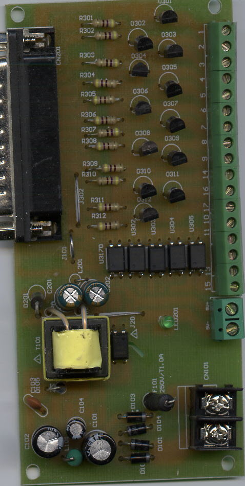

    The first has three wires running to all switches while the second has a serial connection to the switches which includes the emergency cutout. I can see how the second works , but am unable to see why the first has the three wires. - The connection board is the same as shown :

    Are you able to comment on this set up and how it compares with your diagram
    Would apprcieate anything you have to say
    Ken
  8. The reason is that the inputs to the board have to be switched between 0v and +5v. generally the inputs are pulled up to +5v by a resistor on the board and the switches then short the input to ground. An alternative approach is to use both poles of the switch to switch the input line between a 0v wire and a +5v wire. This is how the home switches in the first diagram are wired, as individual inputs. But the same approach is used for the limit switches in the lower part of the diagram and this is just wrong... in fact the way that is wired when one limit switch is activated it puts a short from 0v to +5v, which will probably have the effect of stopping everything but for the wrong reasons.... I would ignore that and go for the single chain of switches. However I would seperate the PANIC switch from the limit switches. A panic switch should always control a relay which supplies power to the motors. That relay MAY have a contact that does the panic input to the breakout board and thence to MACH3 as per these diagrams... one should NEVER rely on MACH3 to stop the motors in an emergency, the panic switch should always act directly...

    Thanks Irving - I di think that the kill switch in series with the limits looked funny - effectivley actinas another limit switch and relying on the catches in the switch to keep the power off (dangerous if it failed.) so the second diagram (without the kill switch at present is the next step) - going by the other suggestions in this thread I should use NC contacts. The Home switches look like they are using separate connections with the board numbers mimicing the port outputs.
    For the kill switch - would I be OK fitting that to the mains side as a breaker to cut all power to the controller and motors and leave the PC on.
  11. Yes the normal arrangement is to use a contactor with a low voltage (under 50v, typically 12 or 24) relay coil. The contactor is normally open, and you close it manually which energises a small transformer which provides power to the contactor coil via the kill switch, thus holding the contactor closed. Hitting the kill switch interrupts the power to the coil causing the contactor to drop out. This arrangement prevents it being re-energised accidentally in the event of a power failure. You have to manually close the contactor and it wont stay closed unless the power is on.
    Another, cheaper, arrangement uses a 10A 240v NO relay (4 contacts) with a 12v coil and a low voltage transformer as used for lighting. This requires a start switch to energise the coil which is then held energised by the relay via the kill switch.
