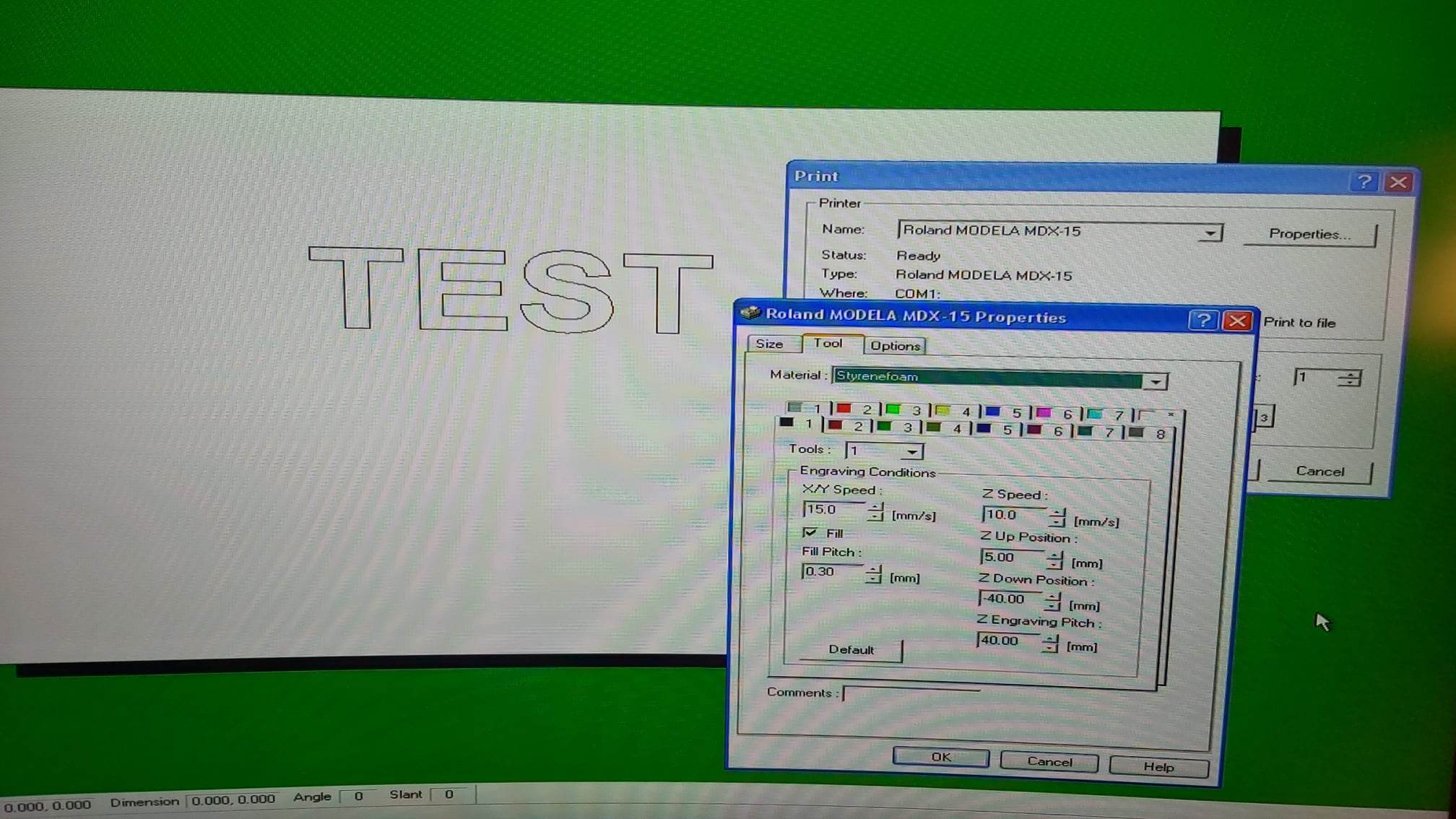

I have an old Roland MDX15 engraving machine. I use DR. Engrave software.
When I set up parameters:
Z Up Position 5mm
Z Down Position -40mm
Z Engraving Pitch 40mm
I don't understand why my Z Up Position values don't work. When machine makes idle moves it raises the z-axis slider to the maximum height. What am i doing wrong?
Video: https://gemoo.com/tools/upload-video...64178002051072
Thank you for your help!Click image for larger version.
