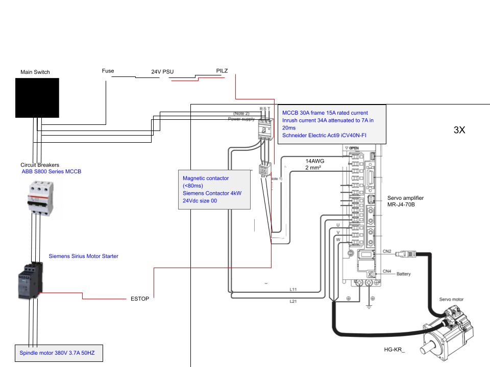

Hello everyone,
I finished my wiring diagram! It would be nice if someone could have a look at it and let me know what they think ? Any suggestions or wrong components choice?
A big thanks for your help.
Setup:
3 x Servo amplifier MR-J4-70B
A Spindle motor 380V 3.7A 50Hz
Name:	CNC_electrical diagram.jpg
Some questions that I have:
Is it necessary to add an EMI filter before the amplifier?
Should I use a delay between each amplifier when the circuit is switch on?
Thanks again.
